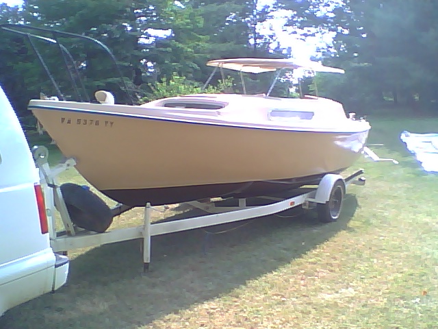

looking at a 71 cat22, the keel has got quite a bit of rust, especially the trailing edge. When I "peel" it with a screwdriver, pieces of metal came right off. Is it serviceable?
Thanks.
sorry, don't have a better picture at this time.

I don't think you have lost a lot of mass. Grind it paint it good to go what about the rest of the boat

That looks a lot like a Mac 22
Very fun little boats. The keel is in relatively good shape. It weighs about 600lb so be careful removing it. There are a lot of people here that have done this job (myself included) and we can talk you through it if you choose to get this boat.
