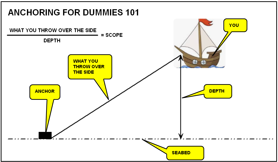

It is a RATIO of depth to length of rode. Triangles have nothing to do with it...although Ralph's picture makes it appear to do that, but when you think about it, it really doesn't because it is only comparing two distances/lengths.

Back when I was teaching as a fill in for a number of years, I would have posted this picture and said "think about it ya little fu _ _ ers" and you'll see why scope matters.

Maine Sail did a wonderful explanation of this years ago, I don't know if it's still up on his marinehowto.com website. He took long pieces of string and stretched them out like in Ralph's diagram, and his point was that beyond 5:1 or 7:1 one was NOT gaining much in the angle between the chain and the anchor / bottom.

Note that the distance along the bottom does not figure in, only the length of the cable. Therefore 1:1 is straight up and down. Going farther down the rabbit hole (although there is no reason to), if 1:1 meant a 45 degree angle, then straight up and down would be zero scope (0:1)?

Lots of answers here - some correct and some, less so. As some have noted, 1:1 scope means you are in 20 feet of water and let out 20 feet of rode. In other words, the anchor is hanging straight down until it just touches the bottom. Contrary to some answers, triangles do figure into this discussion. It is a simple matter of Pythagorean theorem: a2 + b2 = c2 (a squared + b squared = c squared). In this case, "a" is the depth, and "c" is the rode paid out. If we solve for "b", we know what the maximum swing could be.
Now, in the case of 1:1 scope the math is pretty simple:
a = 1
c = 1
b = ?
... therefore ...
a2 = 1
c2 = 1
... therefore ...
1 + b2 = 1
... therefore ...
b2 = 0 and b 0
Therefore, with a 1:1 scope, there appears to be no swing. This is actually illustrative and not just pointless math. This is because, if it were possible to hang an anchor off of your bow and have it hold while your boat swings in a full circle, we know that the radius of the circle is not zero. It is the length of your boat.
This is important because it is often overlooked when we start looking at more practical scopes such as 5:1 or more. My boat is a 32-footer. So, no matter what I do, I will swing through at least a 64-foot circle.
