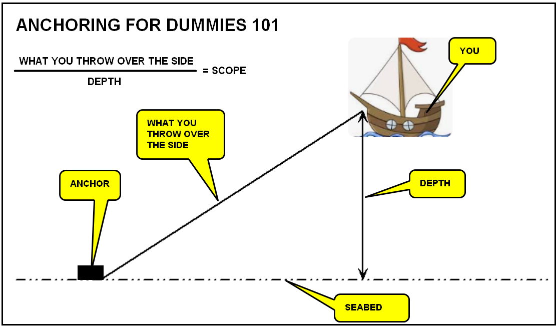

If you're up short, the chain is vertical relative to the bottom. Is that 1:1 scope, or actually zero "scope?" That would form a rt triangle with zero legs and thus a zero hyptenuse, etc.

I always thought the scope was the amount of rode/chain compared to the depth. There is no hypotenuse because it ain't really a triangle. The whole point of the amount of scope is to provide enough flexible sag to allow the anchor to remain dug in so the forces on it remain horizontal. So, if you're visualizing your ground tackle as the hypotenuse of a theoretical triangle, and the two sides of your right triangle are the water depth and the distance the boat is from being directly over the anchor.... forget about it.... you're a gonner:yikes:. So... I'd try to think of your ground tackle as something other than just a triangle. I'd be more inclined to think of it as a shock absorber, instead of coils or compressed gas, using the weight of the rode to smooth out the motion of the boat so the anchor isn't disturbed. Hope that makes sense to y'all.:biggrin:

Yes, John. But I’m looking at a diagram which is idealized, to explain to a student the meaning of 1:1 scope, plus other scopes. The “text” definition has the chain vertical at 1:1. I have a hard time seeing that as “scope.” Functionally, there is no “scope”, IMO.

In my opinion you must also visualize it as when the rode is fully stretched out in strong wind, where it approaches the hypotenuse of a right triangle. The more horizontal the resultant vector, the less likely the anchor is to pull out. Which is your point.

It is a simple ratio of depth to rode length. Nothing more.
The only time a triangle is formed is when the rode is bar tight. That triangle then helps define the swing circle.
Trying to apply math will just confuse students and make it difficult and mysterious.

Yes, that is the definition we all use. This is very simple math; basically 8th grade algebra/geometry, if even. Tough concept, a right triangle.

It is a RATIO of depth to length of rode. Triangles have nothing to do with it...although Ralph's picture makes it appear to do that, but when you think about it, it really doesn't because it is only comparing two distances/lengths.

If teaching this, I wouldn't worry about teaching a right angle or trying calculate this. Just demonstrate it and leave the math out. It would be simple to build a little model to demonstrate the concept. High levels of precision are not needed in this application.
