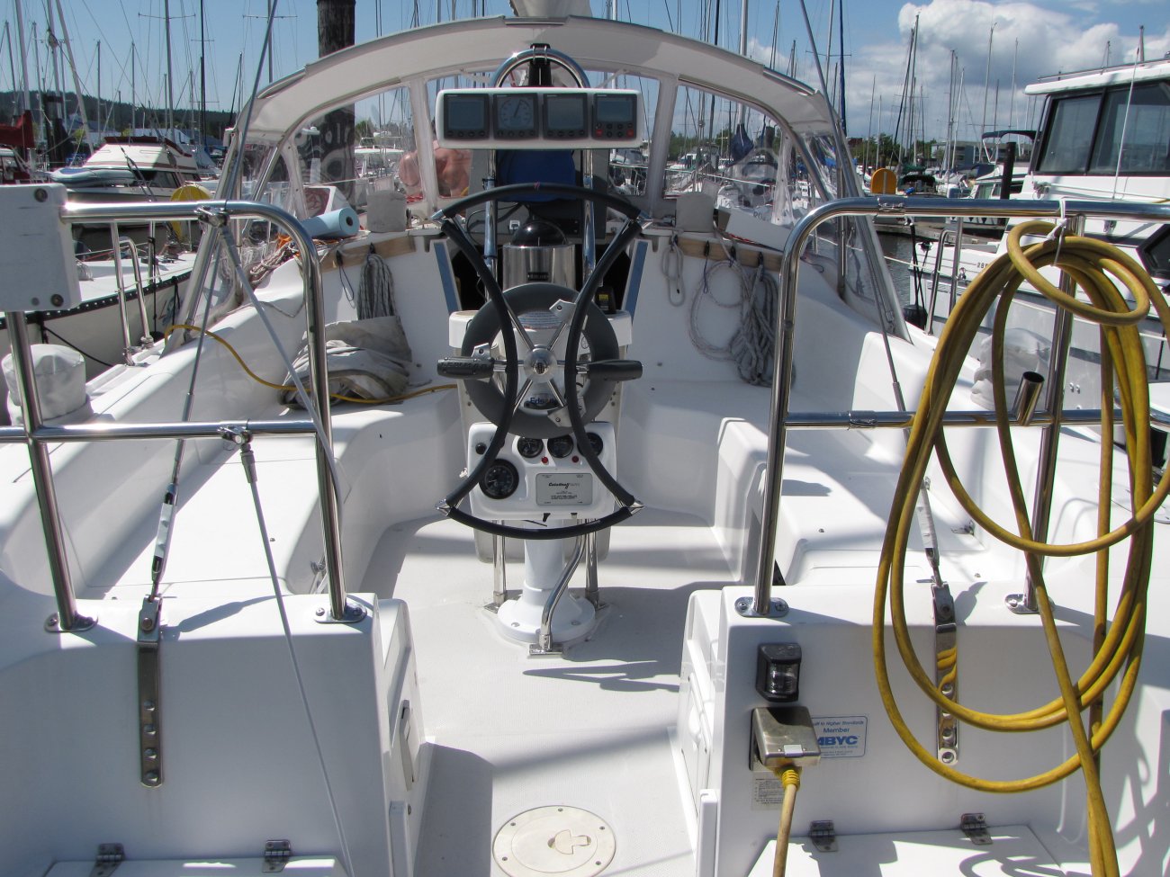

We have the Lewmar folding wheel on Maxine and it is great. Only thing I would say is that when the wheel is folded, the joints protrude with a sharp point. One night drinking beer on the hook a friend nearly jabbed himself in the eye on the upper joint. After that I had a custom padded cover made to cover and cushion the joints.
