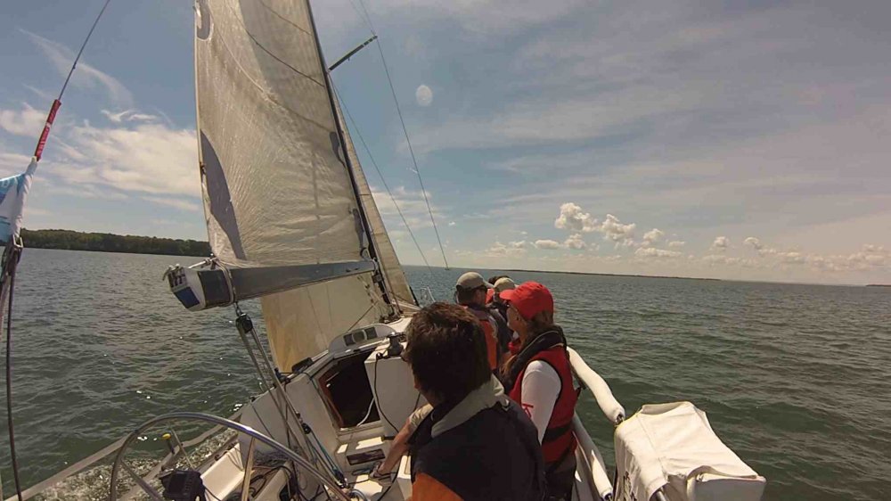

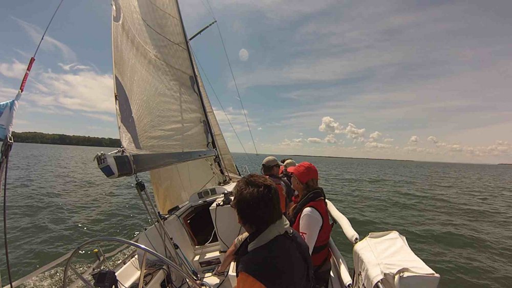

The biggest one that fits. Not only the ratio advantage Gunni mentioned, but it allows the driver to sit on (or closer) the rail, high or low side to help balance the boat while focusing on the jib telltails. Standing behind the wheel was for clipper ships.
