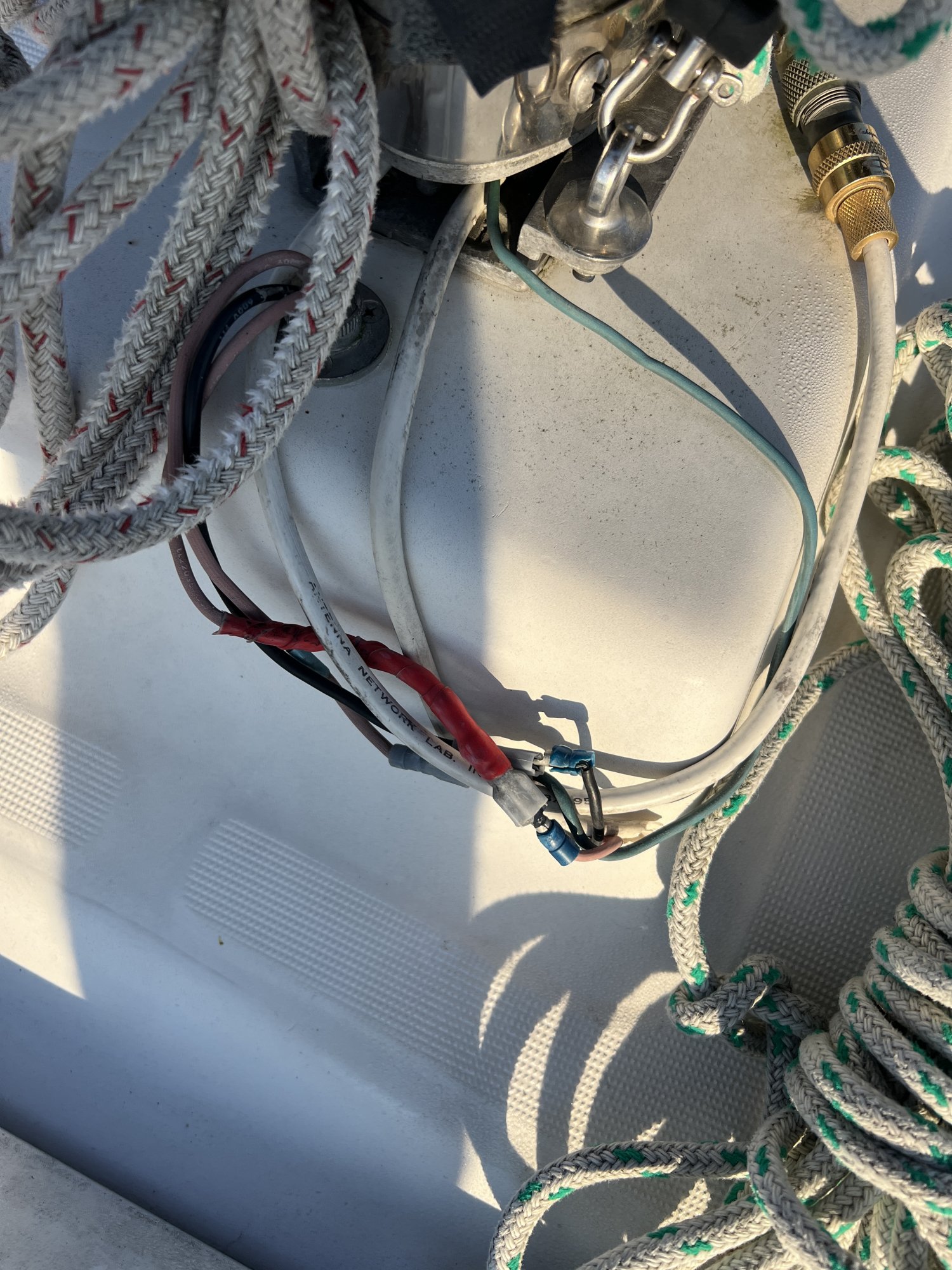

...at the bottom of the mast like this? 1988 Beneteau First 235. Suggestions about tidying them up/protecting from weather? Thanks, Steve

Doesn't look normal to me! The connections look pretty iffy. I'd redo all of them and cover with multiple layers of heat-shrink tubing.

It is common to have electrical connections either at the base of the mast, or inside the mst step. But yours look pretty sketchy and should be improved and maybe be put under a cover.

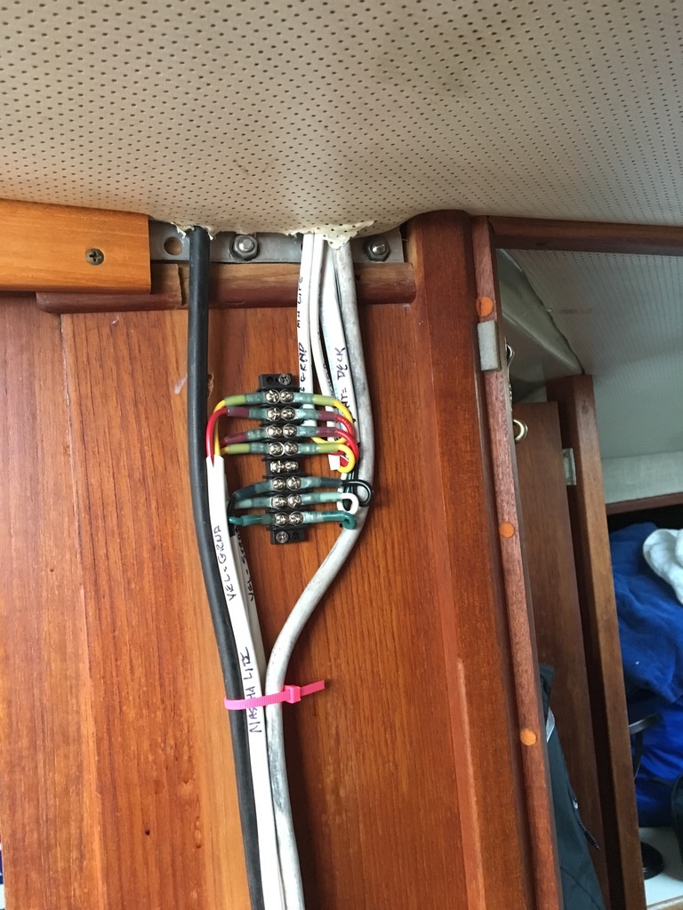

I did not like the idea of wire connections in the Mast base, but I wanted to be able to disconnect the wires should I need to remove the mast from the boat.
Here is my solution.

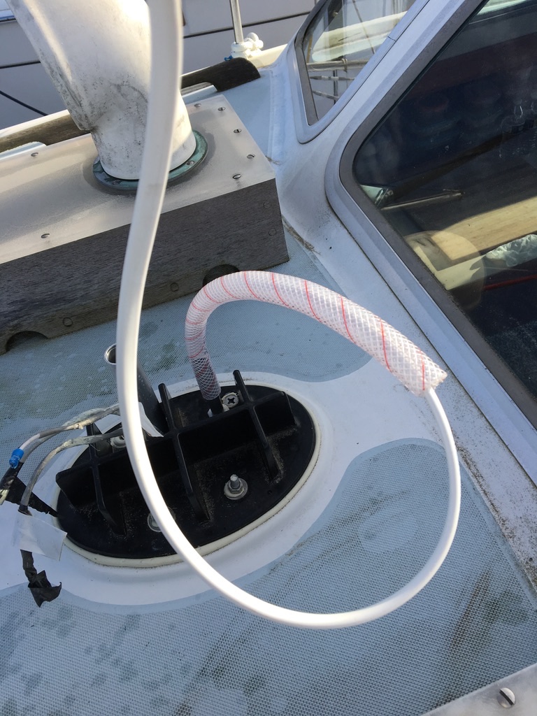

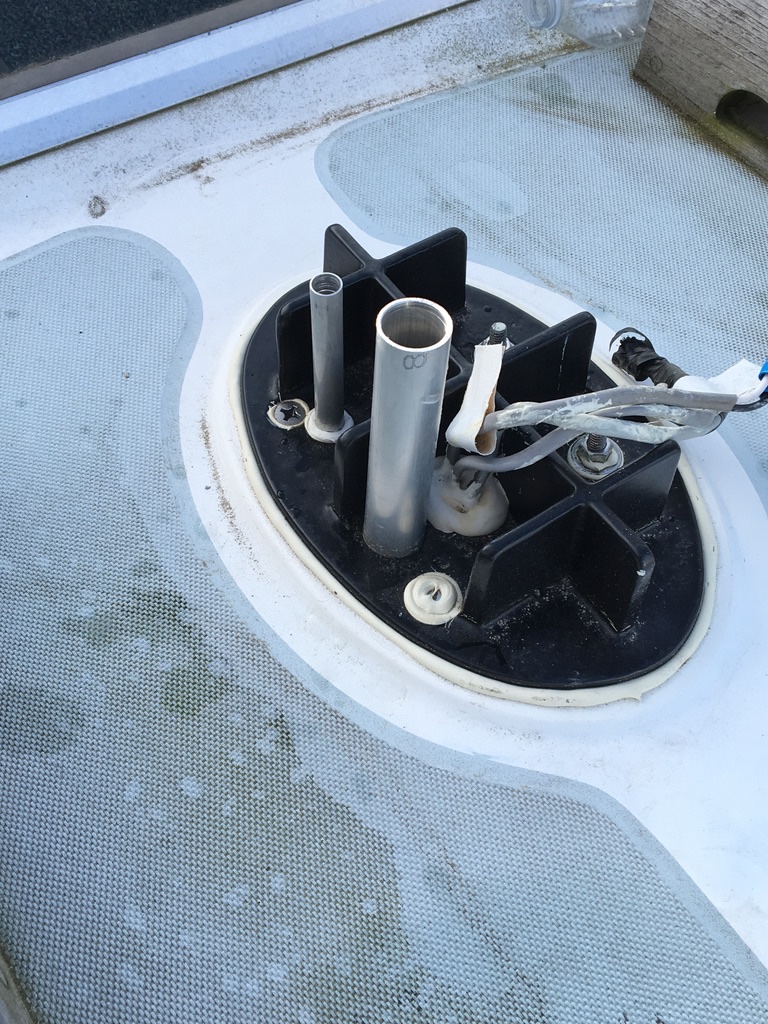

The Mast step has holes with pipes inserted. The idea is that if water gets into the mast and accumulates, the pipes will be above the water level. The base of the mast has weep holes for any water in the mast to flow out onto the deck and overboard.
Hoses are attached to the pipes. Wires run down inside the mast and form a loop at the base to allow water to drip off the wire before it can run up into the hose.

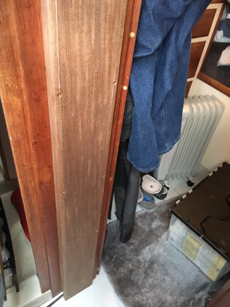

All wires come through the deck into the cabin and are terminated at a block. This area has remained dry since 2016.
A chase was designed to cover the wire cables. Radar and VHF antenna cables are run from the mast to the nav station. They are continuous and will need to be addressed separately should I have to remove the mast. This was done to minimize signal loss.
The most obvious problem is the connectors do not appear to be protected from water. That would be the first step ... make a solution that prevents any exposure to water at the connections. Following that reasoning, there are choices to make the connections either inside the mast or inside the boat. That would require you to make a choice that best fits your preference. Once you've done that, you will want to choose the appropriate method for preventing water from following the wires through the hole in your deck.
Those are the 2 basic objectives: protect the connections from water and prevent water from entering the boat where the wires pass thru the deck.

The First 235 is a trailer-sailor, so frequently removing the mast is common. Easy to disconnect connectors are good.
Great point. You probably know by now that just about every solution on a sailboat is a compromise. Your connection is probably best served above the deck with a plug connection inside the mast. A plug connection isn't as waterproof as a heat-shrinked connection, but you can't live with a heat-shrink connection if you are routinely pulling the connections apart. You should be able to find a suitable plug connection.
I've used a 4-prong connector successfully on my previous boat. If you have 3 loads on the mast, say, anchor light, steaming light, and deck light, you can run a positive lead for each and join all negative leads in a waterproofed junction above the plug. Make one lead (calculate the wire size for additional current) for the 4th prong. Carry the combined negative lead thru the deck & back to the panel. If you just have 2 loads, then you have 2 positive & 2 negative. I never worried too much about carrying one negative lead for 3 loads. The current is typically small for each individually, and in practice, I never used any of the lights concurrently anyway. Still, I did upgrade the common negative lead to at least 14 awg.

...1988 Beneteau First 235. Suggestions about tidying them up/protecting from weather?
My Beneteau has three similar deck “clam shell“ fittings in which the VHF coax, wind instrument cable, & mast lighting wires pass thru the deck. No problems with the clamshell corroding nor leaking. The slack as seen in your photo is pulled thru the clam shells to tidy the wires & the connections are made inside the cabin. BUT, my mast isn’t removed. In your case, it would be very inconvenient to connect & disconnect the wire terminals every time you sail. Think that @Foswick & @ Scott T-Bird’s idea to use a plug(s) would be the better solution for a trailer sailor.

Thanks, despite it being a trailer sailor, it is not used like that, at least currently. Lives in a slip all summer and then with mast up, stored outside (winterized and covered up nice and cozy in tarps). Then dropped in the water again for the 2026 season. Thanks again for this advice, I have a sense of what the priorities are for the fix and some options. BTW - went for my 3rd sail yesterday in Midland Bay, ON, and had a great time - really loving this little boat. So much to learn and enjoying the process.
