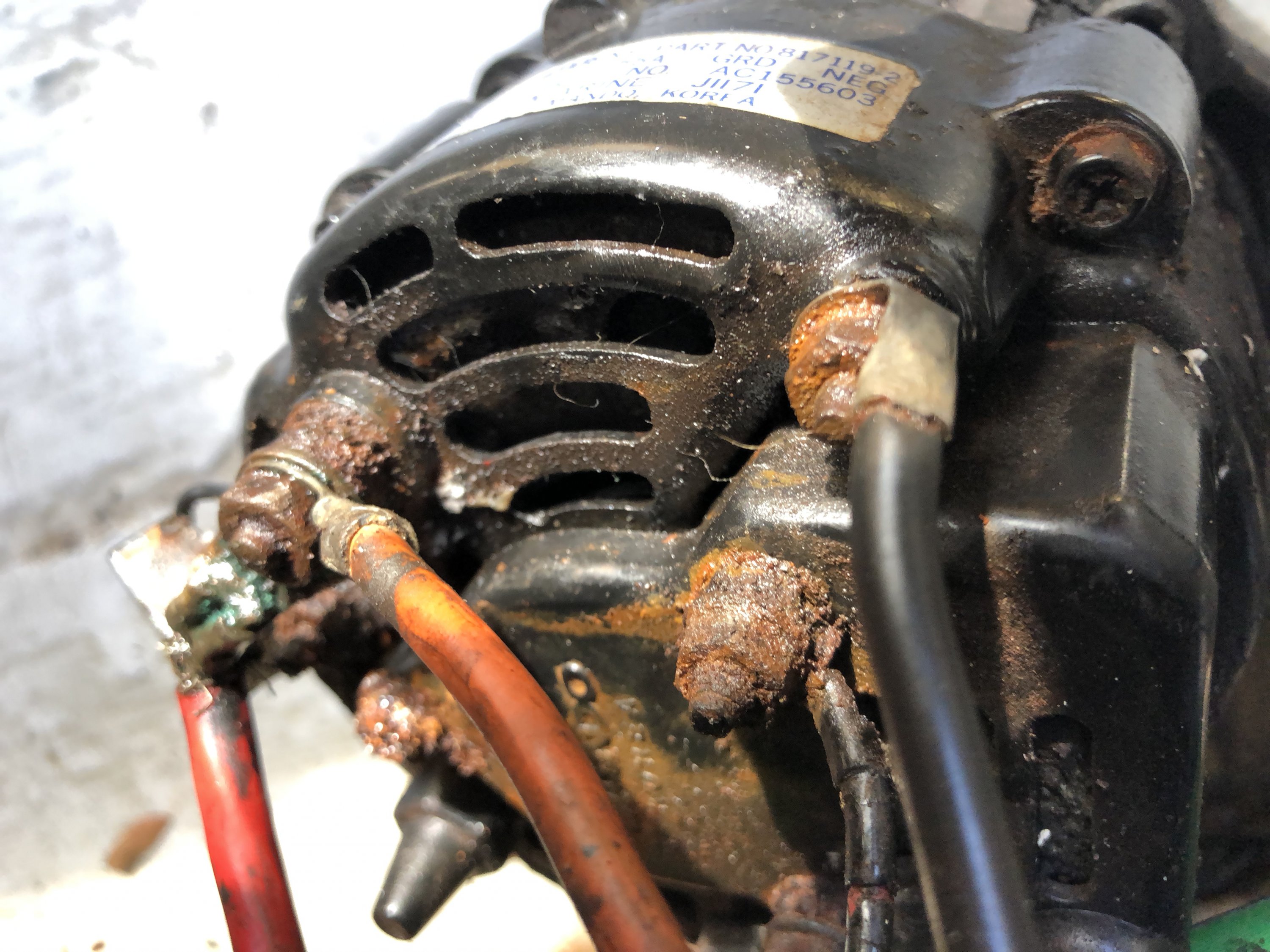

The guy at Larry's said he thinks it got wet. The boat was covered all winter but maybe.

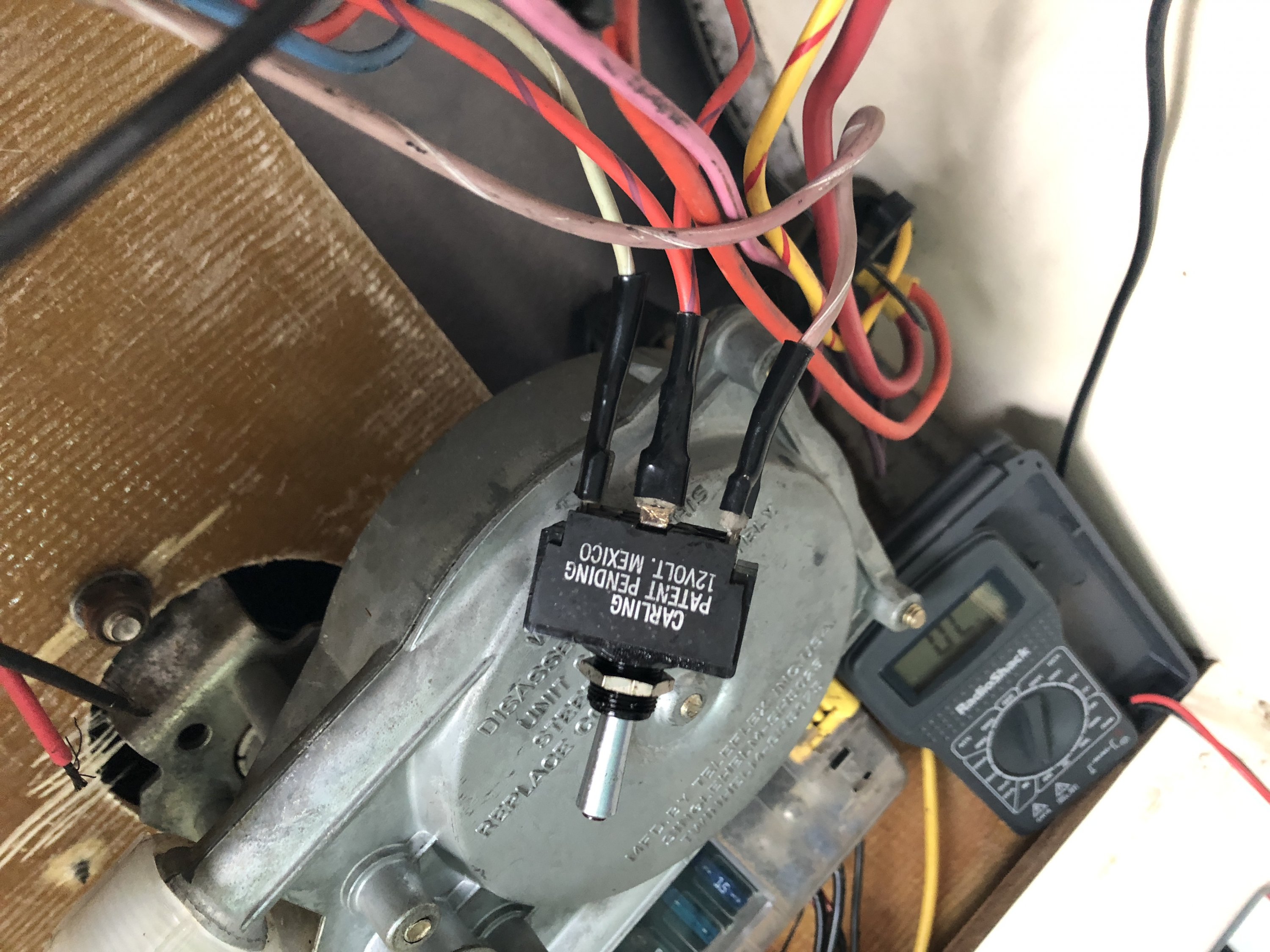

I hope these photos help - I've not looked at them yet.

The switch may have failed due to the increased load due to the resistance of corrosion. There may be additional corrosive problems elsewhere in the elctrical if the alternator terminals are any indicator. The switch is rated for only so many amps. Rarely do you see a switch die from "use" - almost always due to load.
When replacing, use a dilectric 'goo' to seal up the connection so water cannot penetrate and cause the same problem. They sell boots for alternator studs that would help keep things mitigated, definitely if you packed it with that stuff first. You might have to replace the alternator due to the smoke but i'd also go one step further and make sure connections stay high and dry or are properly treated to prevent future issues.
