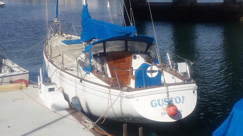

I am looking at buying a 43' Columbia, listing here (contact me for link) pictures are a little hazy and show a lack of upkeep. I have read a few sources on what to look for, typical issues and repairs at their current age. Example here http://sailingmagazine.net/article-1259-columbia-43.html.
My questions and requests here are, can anyone spot anything that screams run far far away? I have a survey being done this week. Can anyone find a reason for me to back out before I throw that money away? Is there any additional information that can be provided regarding the columbia production models? Any and all help is appreciated, and thanks in advance!

It's a 45 year old, 43' boat and they're asking $7500. What are your expectations of it? How do you hope to use it, how soon, and where will you keep it? If in a marina, you may want to see if anyone will insure it.
Have to imagine the cost of the survey is a relatively high % of the asking price. I certainly wouldn't pay for a survey w/o a personal inspection first.

Berner is right... 43 foot boat for $7500 is cheap. The scouts likely got the boat as a donation.
ALL 45 year old boats have issues!
If you are in the market for a boat and this looks good go take a look at it and verify the info. What do you have to loose?
If you bring cash they will likely sign the boat over to you today.
Expect the minimum.
  1. REPLACE THE STANDING RIGGING. Likely $10K
  2. Bottom job with likely blister repairs another $7-9K
  3. Engine issues $5-7K
  4. Running Rigging $1K maybe less.
  5. Sails $3-7K minimum
And that is just the obvious off the top with out any more information. Who knows the boat decks may have issue.
But if you have the time, the cash and the interest it might be a great boat for you. You'll never know until you take a look.

It is possible you are letting the size to price ratio influence you. If it isn't a scam, then it might be, as pointed out, a maintenance nightmare. The next question is are you capable of handling a boat that big? They don't turn on a dime you know, and stopping one is just a hard as turning one. Think wisely before investing. JMHO

I would side with Brian's guarded commentary. Being new to the forum, your experience is not known, and if you have never owned a sailboat, never mind a large one, there may be a lot more there than you are equipped to handle. That's is not to suggest in any way that you are not up to the task or incapable of it, the reason for this note is that you suggest prepping for blue water, which is a whole different can of worms than a daysailer.
You need ALL the systems to work pretty much flawlessly, and reliably, and you're not giving yourself much time at all to verify or attend to that, in a platform that won't give you much time to learn.

It is most likely the boat is a Columbia 43 or a 43CB (center board) boat. A center board boat will have it's own list of concerns. The 43MIII was not built till 1973 and the boat your looking at is listed as a 1972. The HIN is listed as 79. That is an odd HIN. Most HIN's are longer and include Alpha characters. This could mean the boat is #79 in production of 153 boats. If so the boat would have likely been started the last half 1971. A quick check of the Coast Guard Name database does not have the boat listed. So it is not likely registered as a "documented" vessel. You should check the California Title for liens and debts against the boat.

Okay, thank you for the clarification. I have checked a few different online sources regarding any open liens, but I have yet to find anything. I will keep searching. The full HIN would be helpful I imagine. As for insurance, the quick and dirty quote says yes I will be insured for 772 a year.
5,947
Slickcraft 26 Greenport, NY
I echo Jssailem's comment that Columbia's had a good reputation for being solidly built. The designer is listed as William Tripp who was a well regarded designer of the era. The boat has good bones. For the money it's a lot of boat. You have to make sure you can legally own it, insure it, register it and can handle the work that it will need. But if you can do that it is a solid boat that can take you where you want to go. We had one in our local fleet for a few years. The owner lived aboard and kept moving the boat around to keep ahead of the local authorities. I hear the law eventually won. But he had a good run.
