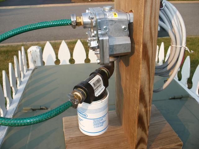

by saying that I built my own fuel polisher when my Raycor started clogging on a motor back up the Bay two years ago. A churning following sea stirred up the soup and lead to the clogging.
A recycling polishing system didn't make sense as you would continue to filter a portion of the fuel in the tank already cleaned without the assurance of being able to clean it all. It will probably work well once all the fuel has been "cleaned" and the tank cleaned out.
The system I built utilizes a 15 GPM gear pump and a 10 mic water separating commercial fuel filter. Fuel is run through the filter on the way out of the tank and again through it going back into the tank. All fuel gets double filtered that way.

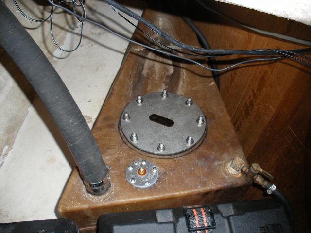

For those that want to try building a polisher, once again here is a picture of the one I built. Also, a picture of the SeaBuilt access port installed.
