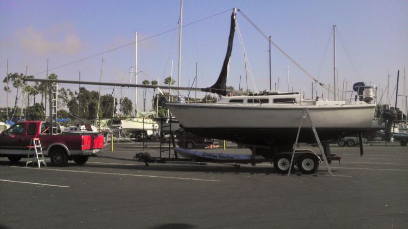

Launching and retrieving is not an issue, I can do mine in about 15 minutes, which is no different from the time it took to launch my Mac 25. Towing will require a lot more horsepower and gas. You will also require regular maintenance to the brakes. For me the real problem is with the in raising the mast. I can do it by myself but it does take 3 times as long. The deck being 8 feet off the ground requires a lot more climbing up and down a much taller ladder. Supporting the mast on the bow pulpit has been done before, but I don't like the load that it puts on the pulpit as well as the mast. It is about 4 feet short of the midpoint on the mast. I have an extension ladder that is rig up in the truck bed, and am able to support it from the end of the mast. Using the boom has a gin poll requires that you have adjustable temporary stays to keep the boom upright. I also have a bridal attached to the middle stay to keep the mast from wandering. You also need about 70 feet of rope to rig up the block and tackle. All this takes about three times longer than rigging up the 25 footer.
To me it really isn't worth the effort for a weekend sail.
There's actually quite a bit of difference between the 27 and a 25 as far as cabin room and headroom, but for the convenience of trailering I would stick with the 25.

Wow that pic of the ladder in your truck bed holding the end of the mast looks scary. I would fear the ladder falling & smacking your truck cab or tailgate to death. I don't miss rigging a trailer sailer in a parking lot. I pretty much hated towing sailboats as well. Nerve racking experience in general.
