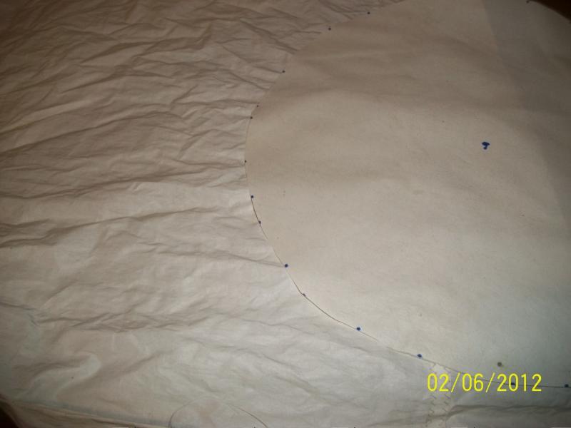

I've been playing around with some old sail material, making sail bags, duffel bags, and general repair and reinforcing on my sails...
In order to layout measure and cut my material I've been ironing it flat and smooth and it really seems to "crisp up" the material.. not burn, but reactivate the resin and tighten the weft and weave by flatening the threads...
I had read in the "Sailmakers Apprentice" that ironing is part of the original sailcloth preperation...
I'm thinking after repair and a good washing, I may iron the complete field of the sail to stiffen it up and bring it back to design shape and smoother airfoil rather than the wrinkly mess it is now...
I know Sail Care irons them as part of their referb process (large roller machines) but was wondering if anyone had taken the time to "hand iron" their sails into shape...?

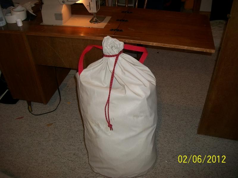

Here's a bag I made out of the wrinkly material above....

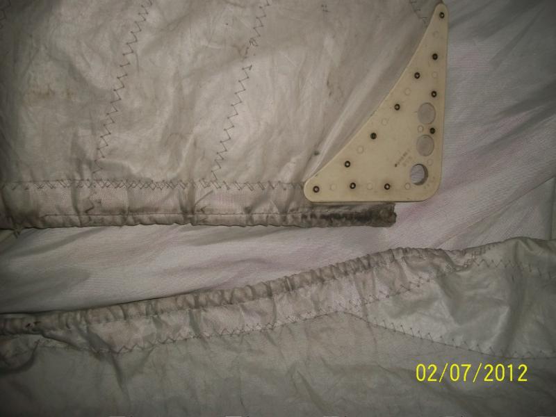

Looked at it, at least on this little "Cat" sail, there is no "stored or extra" bolt rope at the head (to let out) but I'm thinking all I need to do is rip the binding twine, push out the bolt rope, slice in the appropriate extra length to the rope, strech out the luff and then "pull back" the appropriate "preload" and resew...
As much as the luff appears to be "bunched up" on the bolt rope I may have to add several inches to get proper preload...

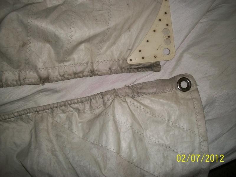

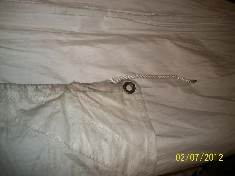

Not to get to far ahead, but I cut the rope loose on the tack end...and then peeled back and step spliced in another foot and a half of three strand to extend the luff rope...I have also cross sewn the strands to prevent unraveling...
I've pulled the rope back in the fuff tape a few inches, now just need a preload measurement to trim the rope and sew it back in...

The standard luff dimenion for this sail is 18.5 ft.
Your measurement (with old boltrope) is 17.8ft.
In the pic you sent me the luff tape, the covering for the boltrope, is severly 'wrinkled' - denoting significant boltrope shrinkage. Since this is (??) a boltrope in the the mast track arrangement, this 'wrinkling' will not allow the sail to properly 'shift' along the mast track ... lengthening the boltrope will ease also that wrinkling.
Standard luff dimensions and boltrope 'preload' for your boat is 18.5 ft. = 18.5/11 = 1.7 inches ..... the boltrope should be cut 1.7 inches SHORTER than whatever you measure with the luff 'unloaded' (slightly tensioned for the measurement).
If you are using a long splice, most certainly you should cross-sew the splice ends with stout waxed sail twine .... additional stitches through the luff tape sleeve and 'through' the boltrope is OK because the length of spliced addition is 'short'.
Rx: Unload the present boltrope and carefully measure the luff length; splice in the new section, subtract 1.7 inches of the 'as measured' luff length - that will be the 'unloaded' measurement for the 'adjusted boltrope' - 18Ft-6in (?) MINUS 1.7 inches. Resew the boltrope TO the sleeve with several X-stitches using very stout waxed sail twine, pulled VERY tight, etc. Use a blunt hard object and 'burnish' the twine stitching INTO the sleeve and boltrope. Since the splice is near/close to the tack you may consider to put a few X stitches across the spliced end in the same manner - through the sail fabric AND the boltrope ....'bury the stitches' in the fabric.
For the splice, Id slice a small hole/slit in the bottom of the sleeve near the tack and use more length of new spliced section than needed ... so that you can at a later time 'ease' the boltrope without having to 'redo' the splice.
Next time use DACRON 3 strand rope to make the splice or if you entirely replace the boltrope -- less stretchy and very predictable 'stretch'. Boltropes are made from dacron 3 strand, not nylon 3 strand. However, a short spliced addition of nylon 3 strand should make no difference in this current 'repair'.
When raising, follow the directions, etc. in "HOW TO RAISE A DACRON MAINSAIL" found in the sail trim forum to get the boat to 'dead fish neutral helm', etc. OR simply add 1.7" of stretch to the halyard after raising for sailing in 12-15kts. etc.
