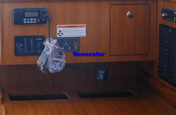

You will need some extra heavy duty battery power for sure and good charging for sure.
Maybe 2 -6 volt batteries and separate starter battery and I think you will be
looking at a Honda Gen for charging,I am only guessing this is what you will be needing.
I have 2-4 D's and start battery and back up Gen on my 36 Hunter to watch DVD's and all the other things the admiral needs to make her comfortable while out anchored.
Once you do the math you will know for sure.
