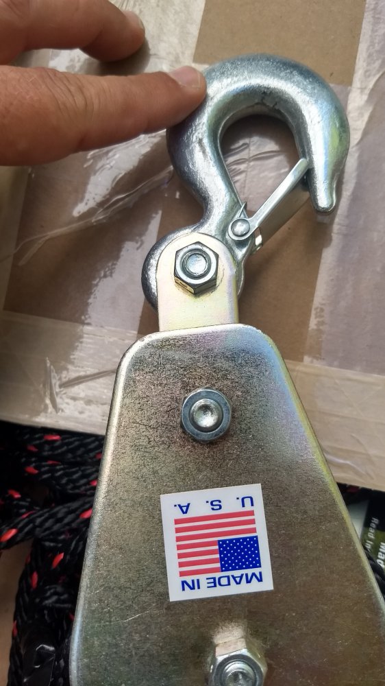

It would but it looks like it has 8 to 1 vs 4 to 1 advantage. You don’t need that much pulling power and you will have to pull a lot more rope to move the hook the same distance, compared to one with only two pullies per block. It will be slower than the 4 to 1 variant.
Very True. It's pretty easy with the 4 to 1. And mine does have the safety latches on the hooks.
