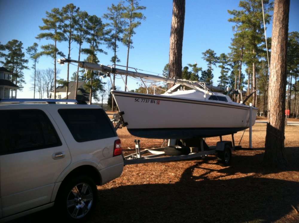

As for launching, I would pick the Ford & put the tail gate down for better visibility. This may become important once the trailer starts going down the ramp & your visual alignment references start to drop out of view. As others have said, extend the extender before you back it into the water. The whole trailer loaded is probably not more than 3,500#, so the 4runner is probably also acceptable as a tow truck. Check your tow ratings, just to be sure.
Yup. While 2012 4-Runner 4WD is 5000 lbs, 2WD is only 2000 lbs. You would have to lash two of them together and stand on the roof with a whip. I read that somewhere.
