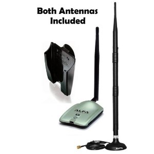

You Might Try This Adapter
Fellow snowbirders highly recommended the Alfa adapter to me while in FL. I purchased one and have been impressed with its range. We use it on a netbook and a laptop with excellent results. We bought the 2000mw version with the 5db and 9db antennas. We've used hot spots over a mile away with excellent results. Check out the one at
http://www.amazon.com/High-Gain-Long-Range-Alfa-9dBi-Strongest/dp/B0035BGNWU
http://www.alfa.com.tw/in/front/bin/ptdetail.phtml?Part=AWUS036NH&Category=105463
