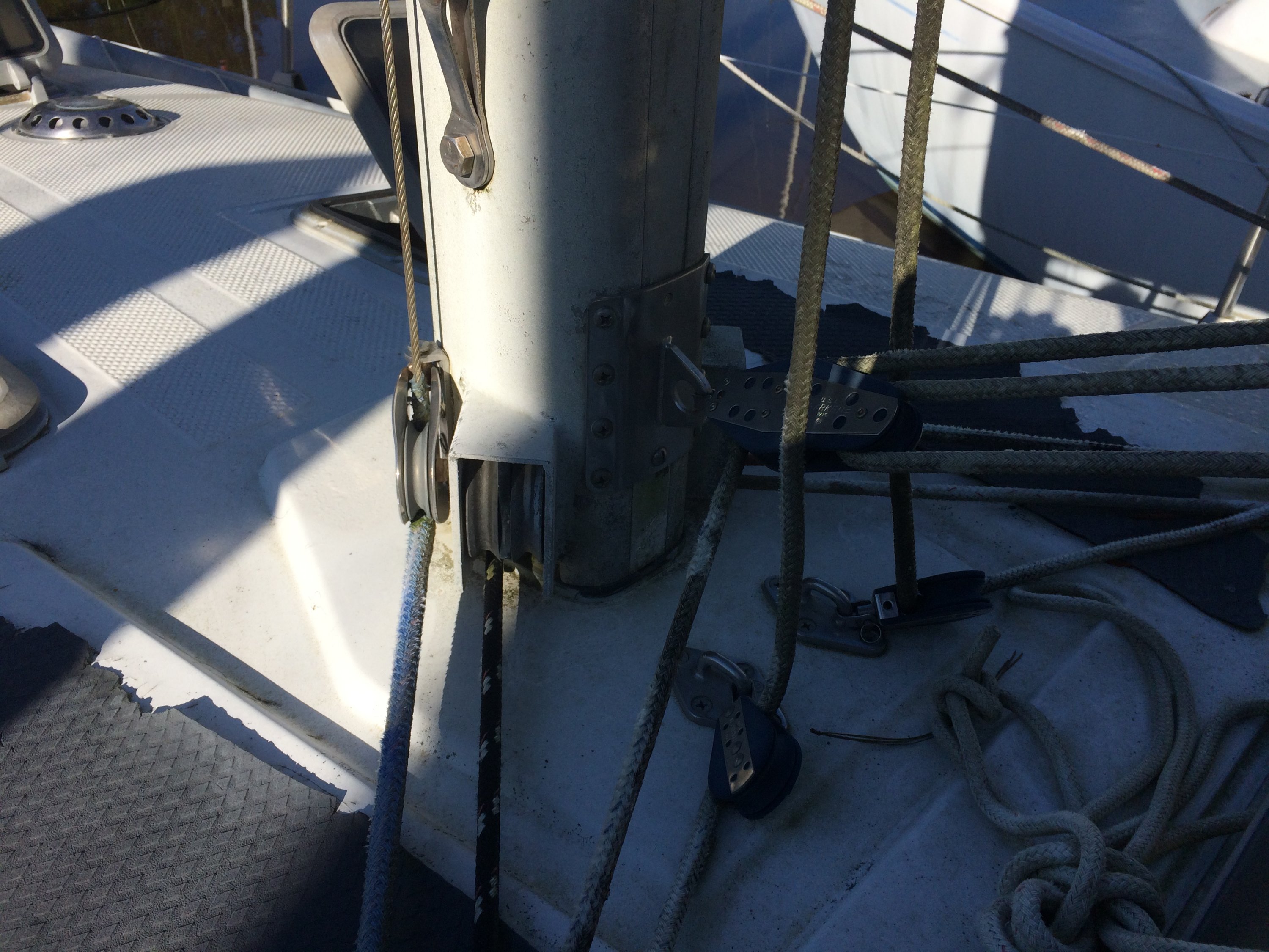

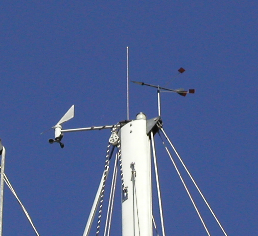

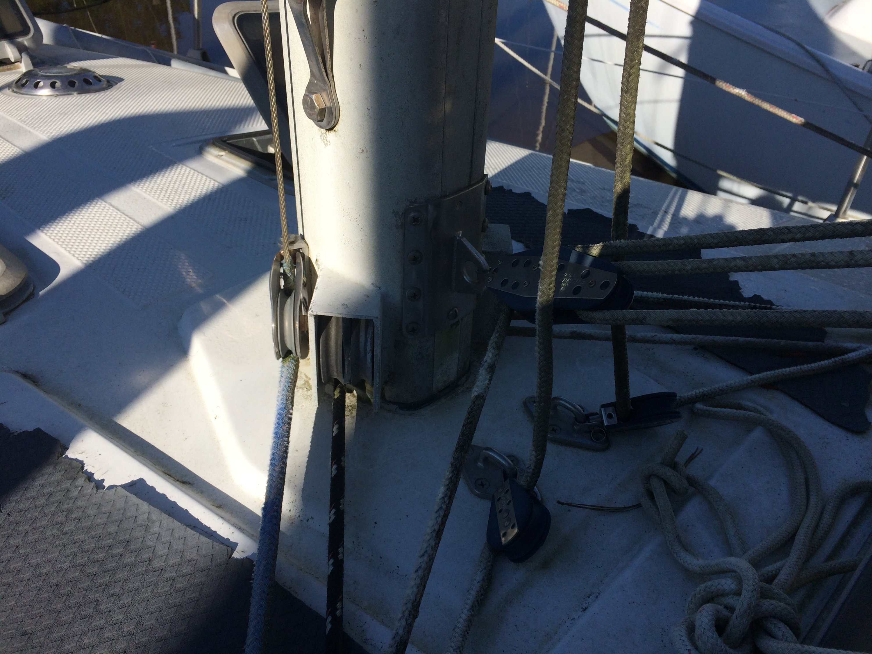

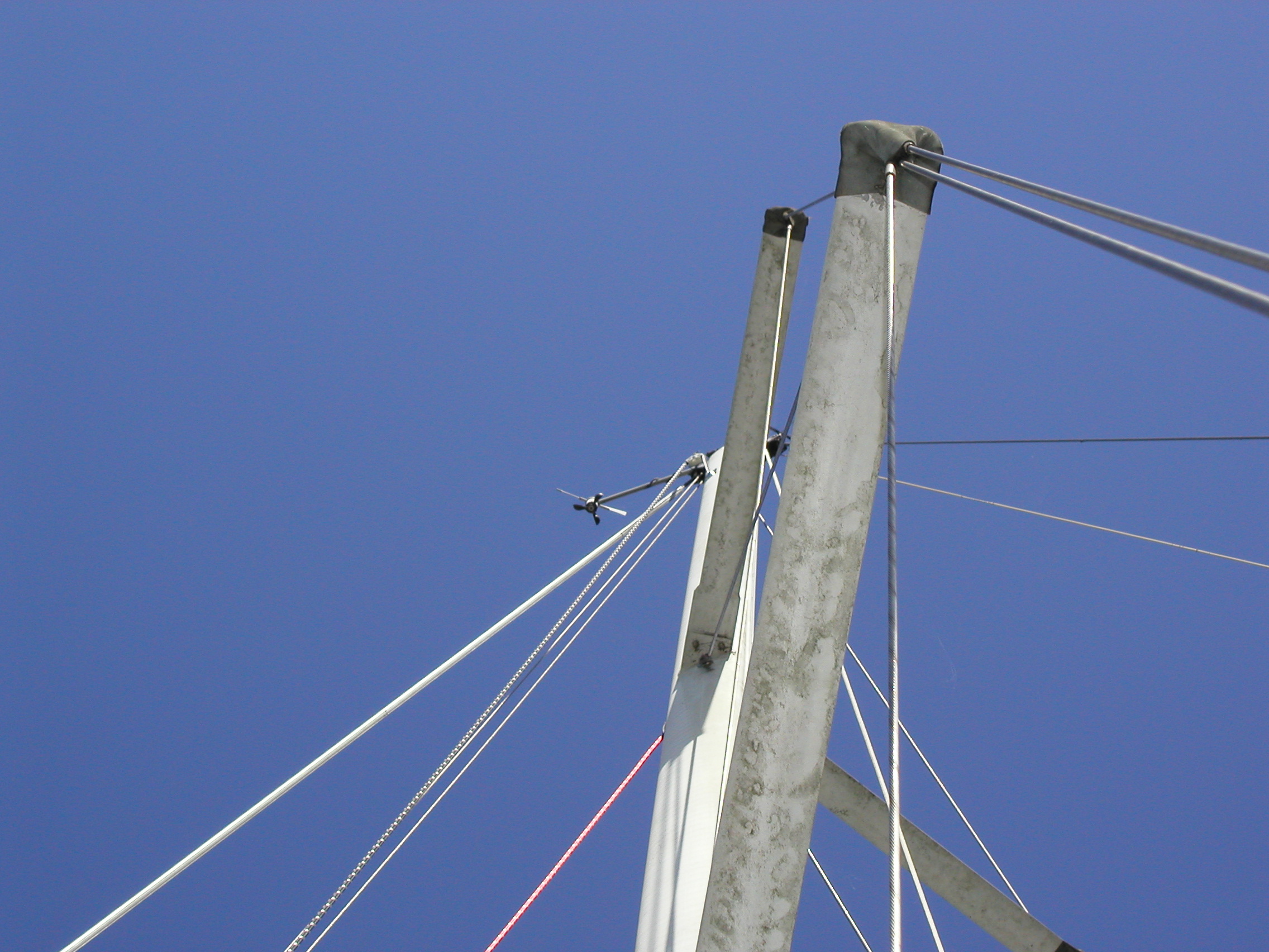

Mine does not have the extra lower sheave, above the spin pole topping lift. I have two jib halyards on a double slot foil to enable headsail changes .. a spin halyard exits below the mast head (black line) and the pole topping lift (red line).. and one mainsail halyard.. On mast base, the two jib halyards are on swivel blocks on either side of the mast and spin halyard (black) and topping lift (red) and main halyard exit the original foot sheaves..
