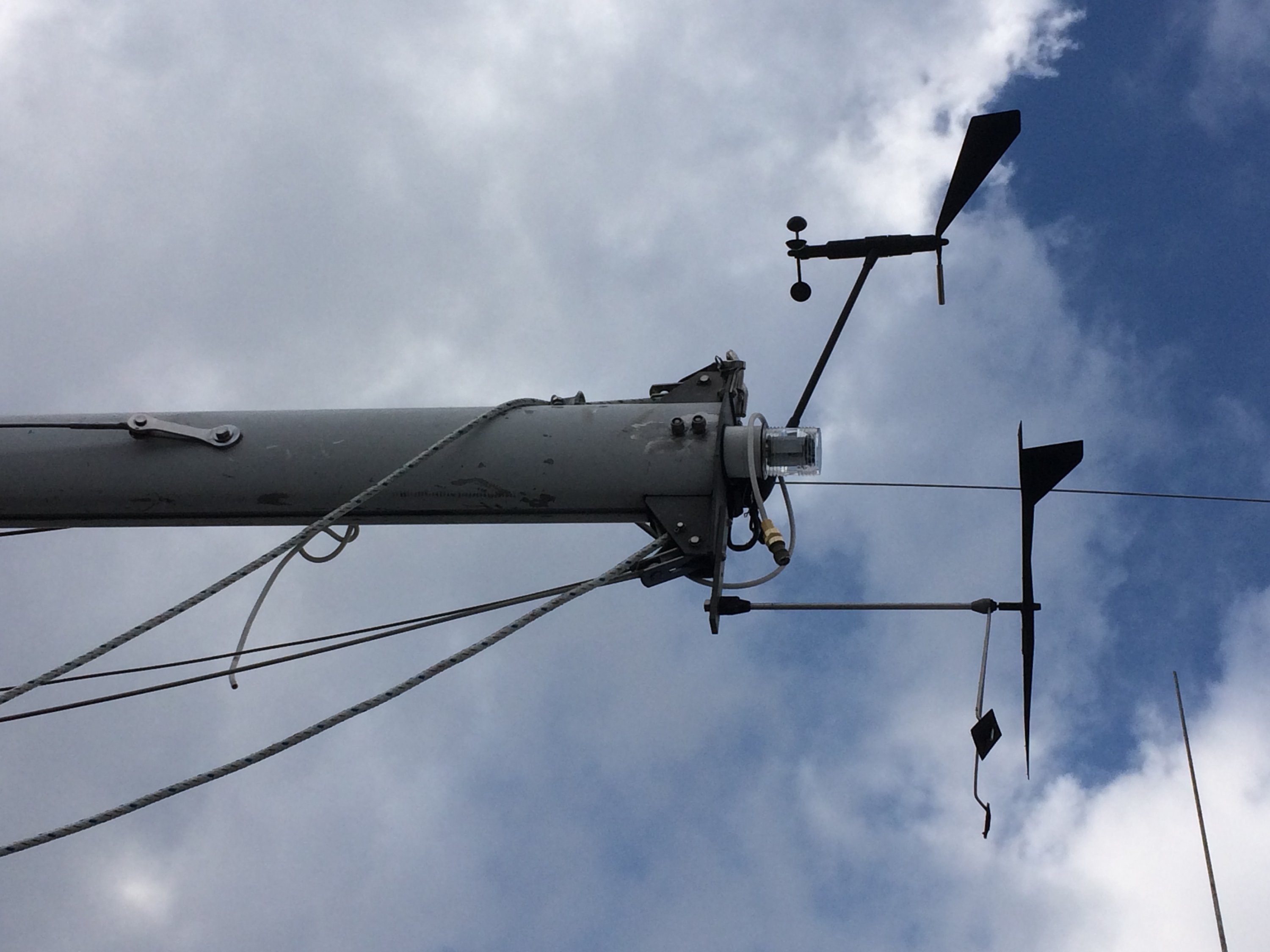

image.jpeg I just installed one over the winter and it was pretty easy. Don't know about your 28, but my Cherubini 27 only has one tube for wires. Both a triplex 14awg and the cable for the wind vane fit along with 2 coax cables. Don't know about the connector on the Raymarine, but the size of my B & G allowed me to drill only a 5/16" hole in the mast head for cable exit.
I would suggest if you are re-wiring the whole shebang that you pull the wind vane cable first because of the integral connector.
