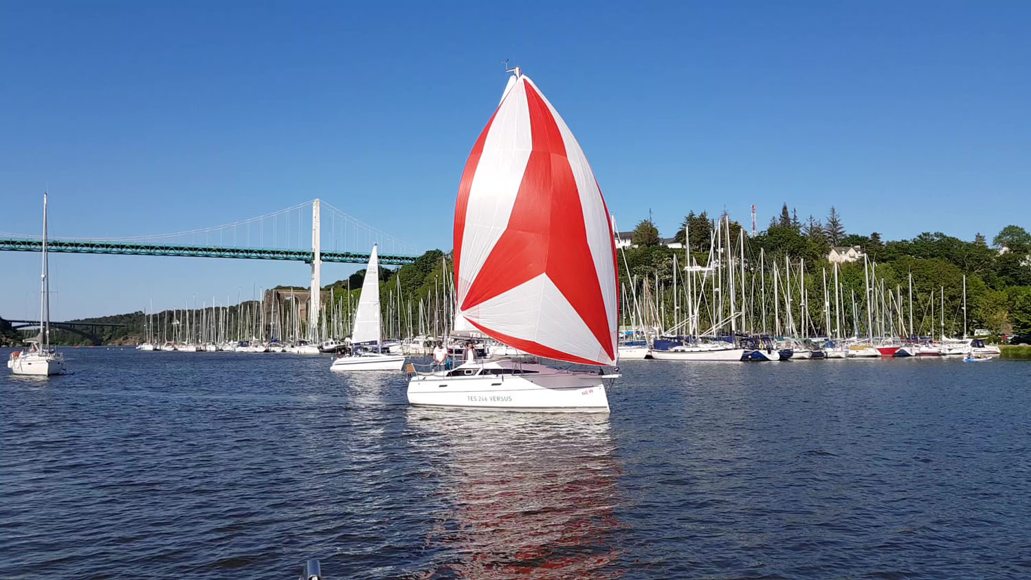

Here's how the boat was equipped when I got it. The spinnaker halyard is fully installed with a line and everything, including its own clutch. There's a block on either side very near the stern, about three feet behind the winch on each side. So it looks like all I have to do is rig up something for the tack line and I'll be ready to try out the spinnaker.
I'm really looking forward to it because I've learned that light winds are very common in the areas I sail. In four seasons of sailing I've only seen double-digit winds a handful of times. I've reefed far more times just for the practice than when it's actually needed!

What you have is a genaker, if this is a factory one. It is a poor quality photo, but if you zoom in, you can see furler beneath the sali (I don't see a sock od any type to douse the sail).
Tes-246-versus-nouveau-voilier-transportable-mat-rabattable-tes-yacht-france-jean-michel-dufou...jpg
