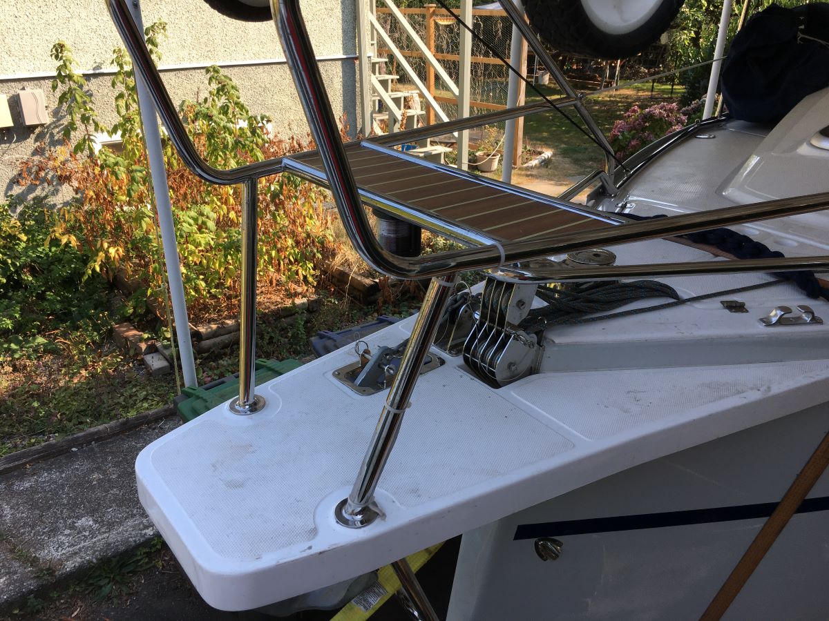

I recently bought a boat that came with a brand new asymmetrical spinnaker that, so far as I know, was never used on the boat. I've never flown a spinnaker before and I plan to take a friend who has racing experience to show me how to use it, the first time. But, while preparing for that, I came to wonder if the boat is even properly set up for it. There doesn't seem to be anything on the bowsprit for the spinnaker to attach to. Here's a photo.
Should there be some kind of fitting at the front of the bowsprit? What kind of fitting is best? Would it go on the top face or the forward face? Or could/should something be attached to the pulpit?

so where does the forestay attach?
what are all those blocks for?
is it a monohull?

Yes, she's a monohull--a TES 246 Versus.
What you see beneath the pulpit seat is the block and tackle for the built in mast raising system. The forestay attaches to the A frame, which also holds the top block of the block and tackle. The A frame acts as a gin pole. The bottom block is attached to the hull. When the mast is up the A frame is down and the forestay is in the normal position. When you want to drop the mast you remove the pin between the blocks and let the block and tackle out. If it's temporary you just leave the forestay on the A frame (which is now vertical). If you're putting the boat on the trailer you detach the forestay from the A frame so you can pull the mast forward to the stowed position (as shown in the photo).

sweet boat. tie tack to seat for now maybe. call company for advice.

Thanks, @sail sfbay ! I'll experiment with it. The article on the Tacker web site seems to suggest that a higher mounting of the tack is better. Maybe I should rig something up at the top of the pulpit?
The rigging is 7/8 fractional, if that makes a difference.
