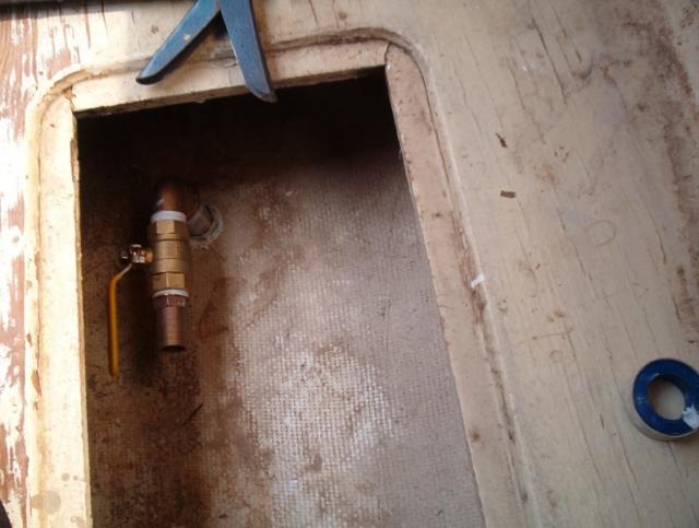

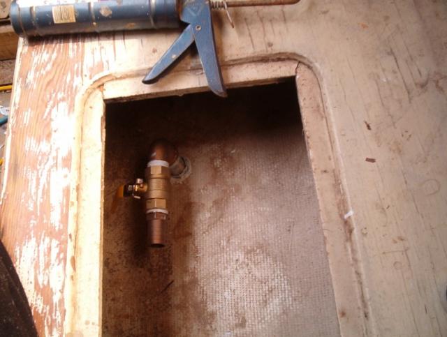

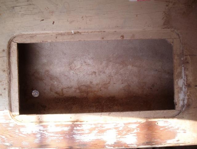

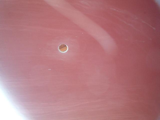

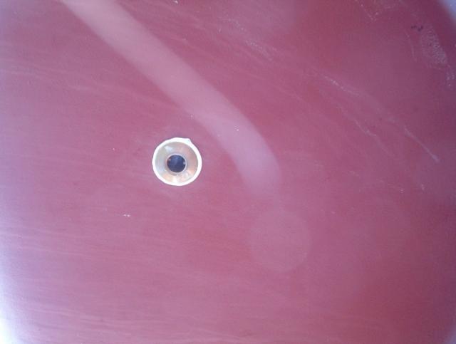

Okie dokie,
Here are some photo's of the steps taken to install my seaside
pump out. It is
located in the aft section of the first locker in the port quarter berth. All
fittings are bronze. The thru hull and locking nut are embedded in 3M 5200
sealant adhesive. Once set I will cut away any excess on the outside of the
hull. NOTICE how I have the handle arranged so that it is down and facing to the
aft. This hopefully will prevent any accidental opening of the valve, even
though we will have a vented loop in the head. According to the paper with the
macerator there should be no particulate larger then 1/8''. I located it here as
the switch is right behind it in the new electrical panel so that I can open the
locker open the valve and turn on the pump. When I hear or see the tank is empty
I can easy flip the switch off and close the valve once again. With a vented
loop I could leave the valve open but will feel better with it closed.
Happy sailing,
Brina
PS like most we will use fresh water for the first flush tank and after that use
sea water and then flush with fresh water when the boat is out of the water or
we're away for any length of time.
