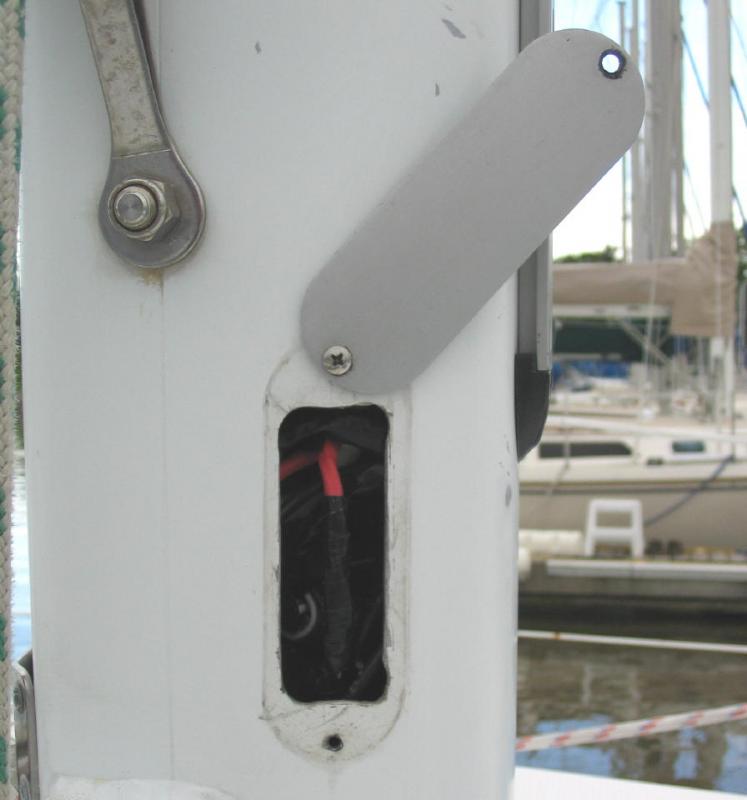

Inspection plate
Claude What's that inspection plate on the side of your mast for? Is that to hook-up your wiring when you take the mast down? Did you install it? or is it factory?
Thanks
Yes Dan, I cut it open 4 or 5 years ago to ease the wiring hook-up and eliminate having to work with hands under the suspended mast. Now, when the mast is lowered to about a foot above the step, I feed a rope in the inspection port and bring it to the wires. I then quickly tape it on the tail-end of the wires so it becomes a fish. I just keep a little tension on it while the mast is brought unto the step, and the wires come out of the port. I have the wires coming down the mast already out. It is then an easy matter once the mast is secured in place to do the connections. When I unstep the mast, I open up the inspection plate, bring the various connections out and disconnect. Feed the disconnected wires back in before raising and simply lift. Fred Ficarra gave me the idea. I believe there might also be a pict on his site.
