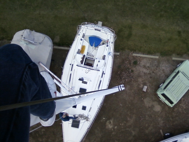

Ok here's the deal. Last fall I removed my main halyard in order to get a new one. I used a messager line. 3 weeks ago I went done to the boat for the first time since haul-out (last fall). The wind over the winter had chafed the messager line and now half of it's in the mast:cussing:
So today up the mast with the new halyard and tried to feed it down It's in there somewhere but not at the bottom. We tried using a smaller diameter line with a nut tyed (sp) but with no luck. It would appear at the mast head that the space between the sheave and the bolts that hold it in place is very tight. I think thats why the last halyard had to be replaced because of the misrouting.
Do you think a electrician's fish tape might work?
It might be hung up on the bolts that hold the tangs in place (double spreaders). They go though the mast in 2 different places or the steaming light wiring.
Or any other ideas on how to get the new halyard down without pulling the mast?
Thanks
Don
