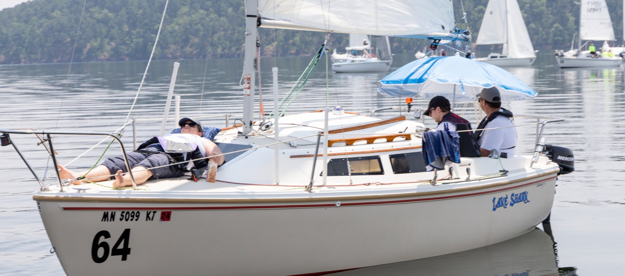

@Gene Neill In this picture you can see the vent fitting and Pump out fittings. Never mind the relaxed racing crew we were waiting for wind and enjoying our day win the water last year in Arkansas.
The vent fitting is the white through hole on the side in the red stripe. The pump put fitting is near the center stay in the side deck on the top. For a vent fitting I would recommend using a proper vented cap and not a though hole to prevent water egress and mud dobbers from setting up residence. Currently with no hose mine is filled with silicone from the inside.
The "proper" vent thru-hull is designed to keep sea water out of fuel and water tanks. Boat builders us the same thru-hull for all vents because it costs them less to buy one kind in bulk than doing it correctly, totally ignoring the fact that they're unsuitable for waste tank vent thru-hulls because, unlike water and fuel tanks, waste tanks need to breathe...oxygen prevents odor from being created in them. A "proper" vent thru-hull doesn't allow that, an open thru-hull does...and unlike a fuel or water tank, the small amount of water that might get into the holding tank when the boat is heeled doesn't matter. As for preventing vent blockages. that's easy: put a hose nozzle against an open thru-hull to backflush the vent line every time you wash the boat and/or pump out. Anything that's tried to set up housekeeping in the vent line will just get a waterslide ride into the tank.
