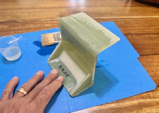

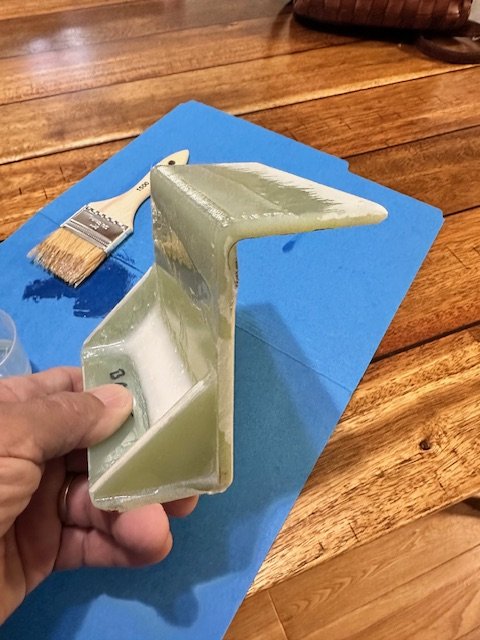

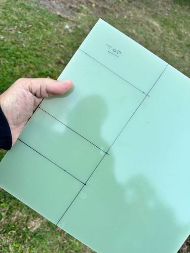

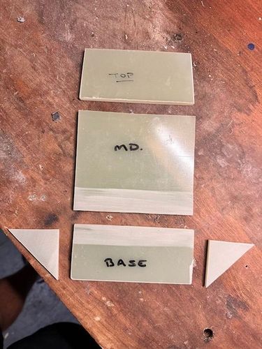

The hold down bracket is taking shape. I had this 12"x12" sheet of 1/4" G10 fiberglass on hand, so that's what I'm using. It'll be just a basic sort of 'Z' shape, with right angles, and extra bracing at the base. Hopefully it's bomb proof. I don't wanna build it twice.

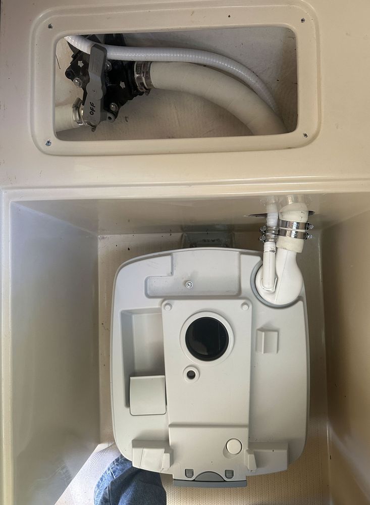

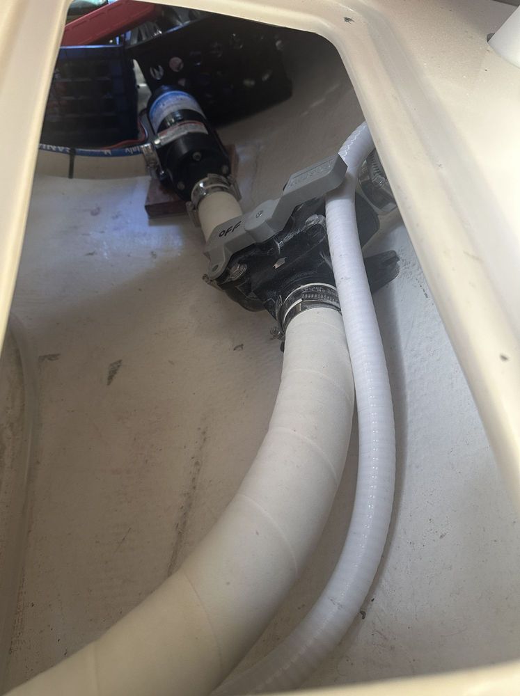

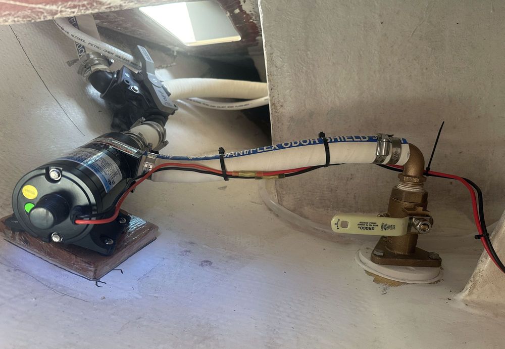

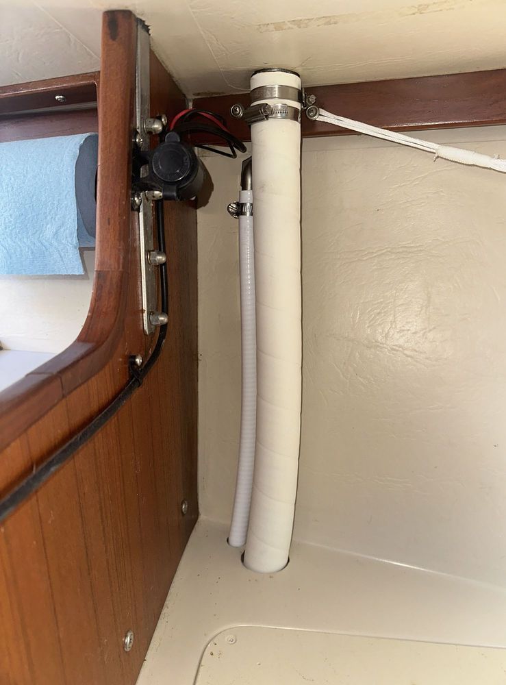

Since I NEVER procrastinate, the job is finished, only one year after starting this thread. Overall, I am supremely satisfied.
In the end, I went with an electric mascerator pump rather than a hand pump. There is no vented loop; hopefully we will not die without one, we'll see. The hold down bracket is 100% bomb proof. We have tested the system in our back yard by filling the holding tank with water and pumping it out a couple times, checking for leaks and whatnot.
Pics to follow ...
