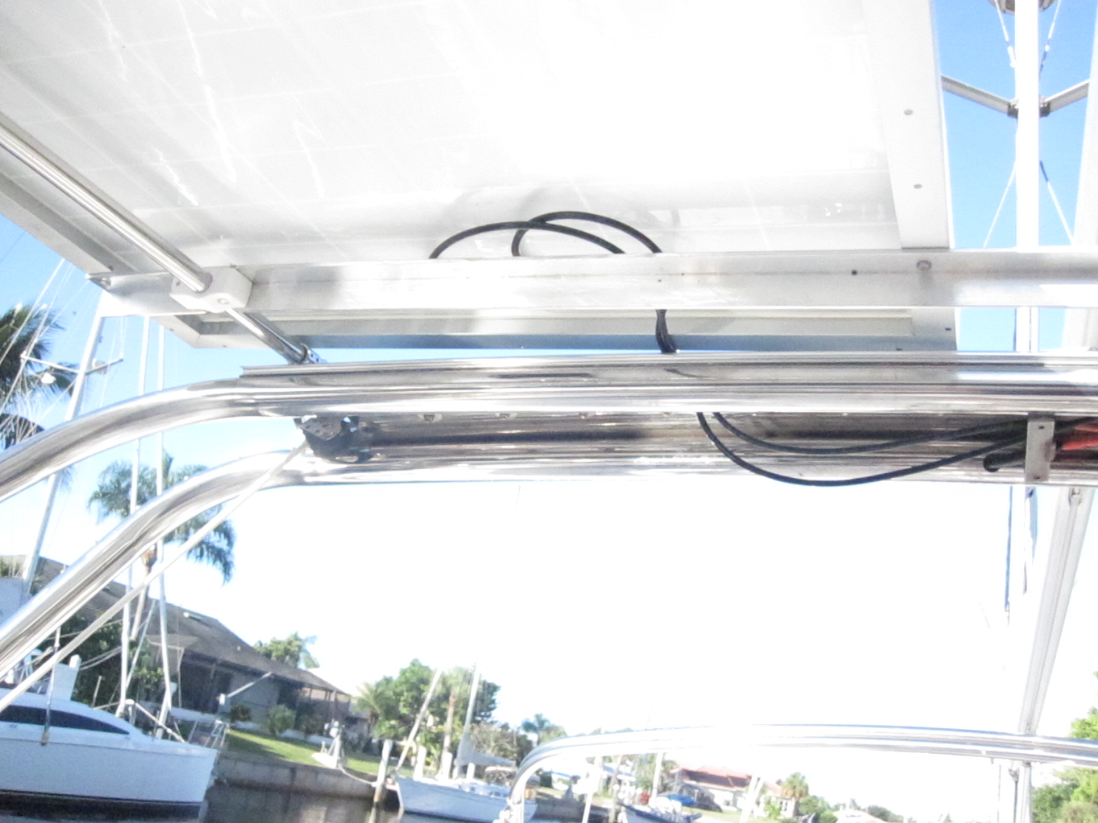

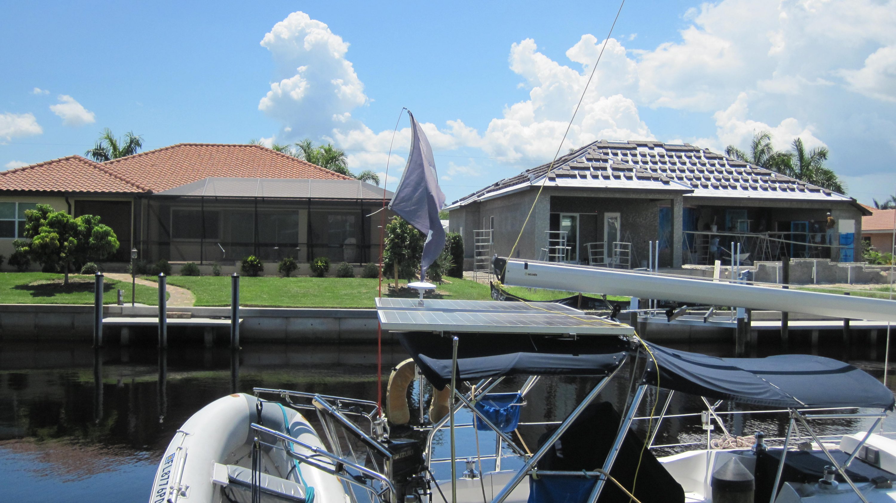

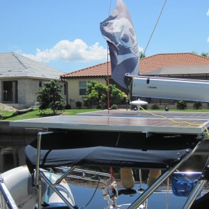

I have had 2 Hunters with an arch and now on my 2007 H-36 I even have 2 195 watt panels attached to the arch and over my Bimini.
