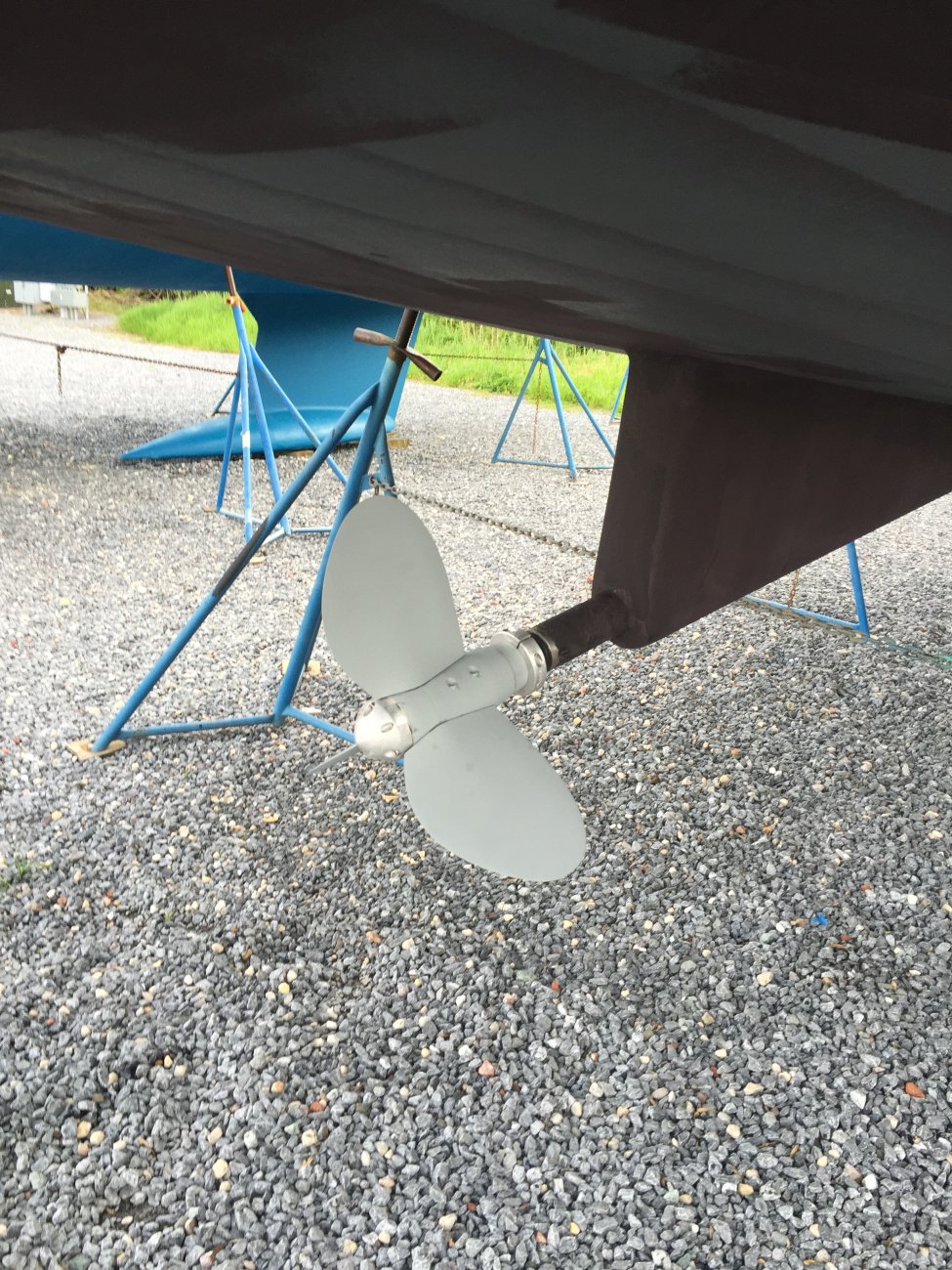

59251B27-D9A0-4A16-BD5A-D372DCA640B5.jpegWith fresh anodes, bolted to a polished propeller and shaft, that was then masked and painted with zinc chromate paint.

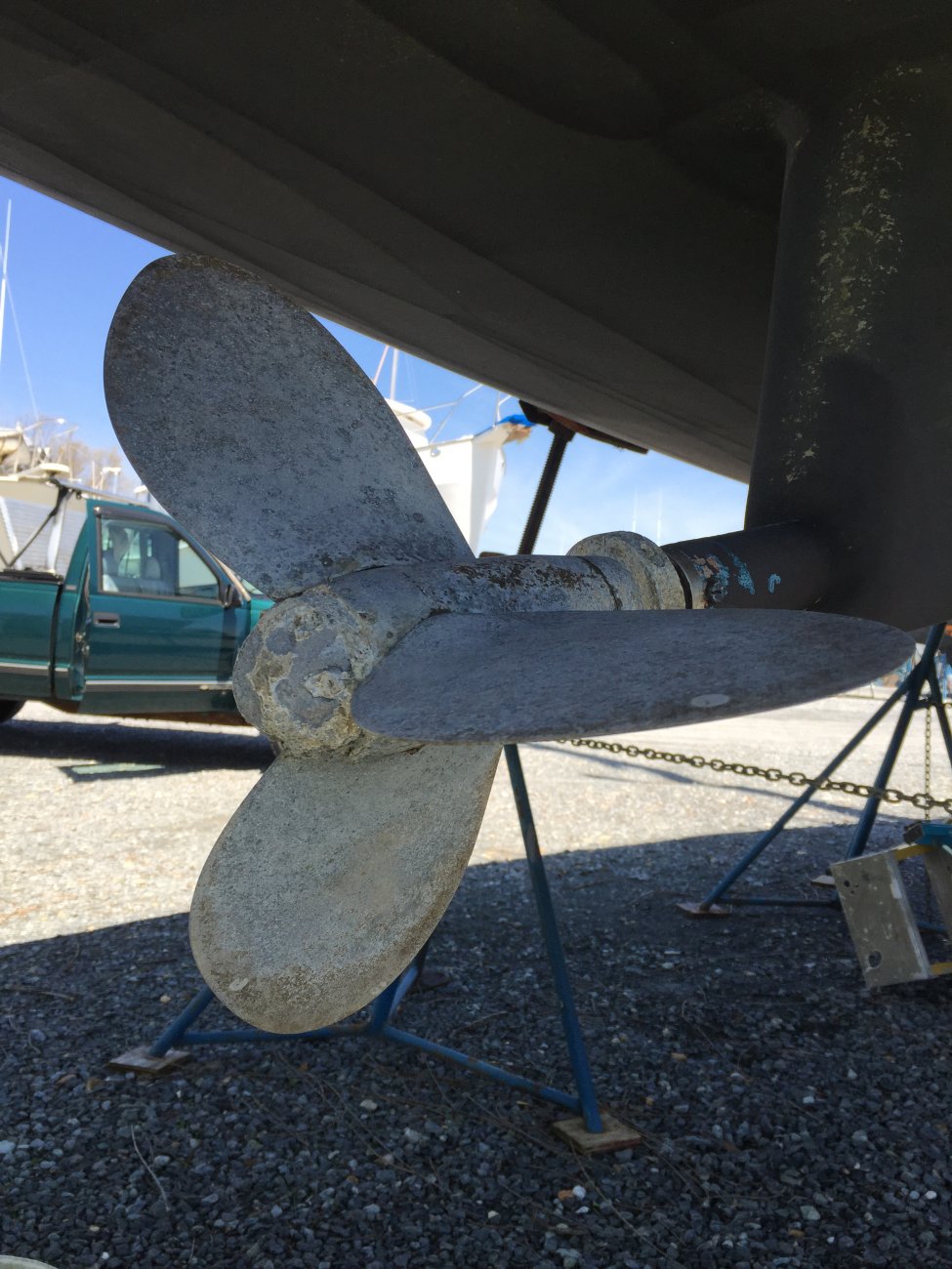

4E51AC6C-8B1F-434C-89B5-684D6F499A07.jpeg After a season in the water, showing corrosion erosion of anodes, and loss of zinc on the prop blades.

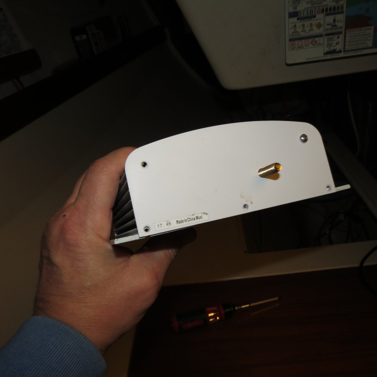

Are the grounding studs insulated from the case? Do they have a plastic bushing?

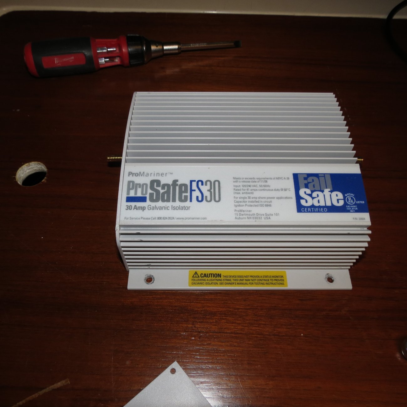

Since I have the same GI I’ll be installing this spring, I tried to open up my GI to see what Scott was talking about.
The end caps where the studs are located are plastic so they are insulated from the case.
After removing the 5 screws on one end cap, the end cap wouldn’t come off. It appeared the stud was holding the end cap in place. I would have to remove the nuts on the stud in order to remove the end cap. The nuts and studs seemed to be tight so I didn’t go any further in disassembly.
Really? I must have had too much blood racing to my head (and I lost a bunch of blood through my hands and fingers :mad:) when I was trying to thread the screws under the platform. I seem to recall that the end cover simply came apart from the case, with the stud and all, after I removed the 5 screws. I might have taken the two outer nuts off - I don't really recall. That end cover didn't seem like plastic to me. We will have to compare! :confused::confused:

The story was the owner backed out of the slip, felt a severe vibration and put the boat right back into the slip. I saw it hanging in the travel lift. The break where the blade broke off was pink clean through the thickness, not the normal looking part old metal and part fresh metal like a stress crack that finally broke.
I had never seen an example of corrosion that turned the bronze pink like that, in person. Mechanic said without the zinc the bronze was brittle so the blade just broke off.
@Scott T-Bird Yep, definitely not metal and while I could flex the end cap slightly around all edges, I couldn't pull it off.
I'll definitely take another look now!

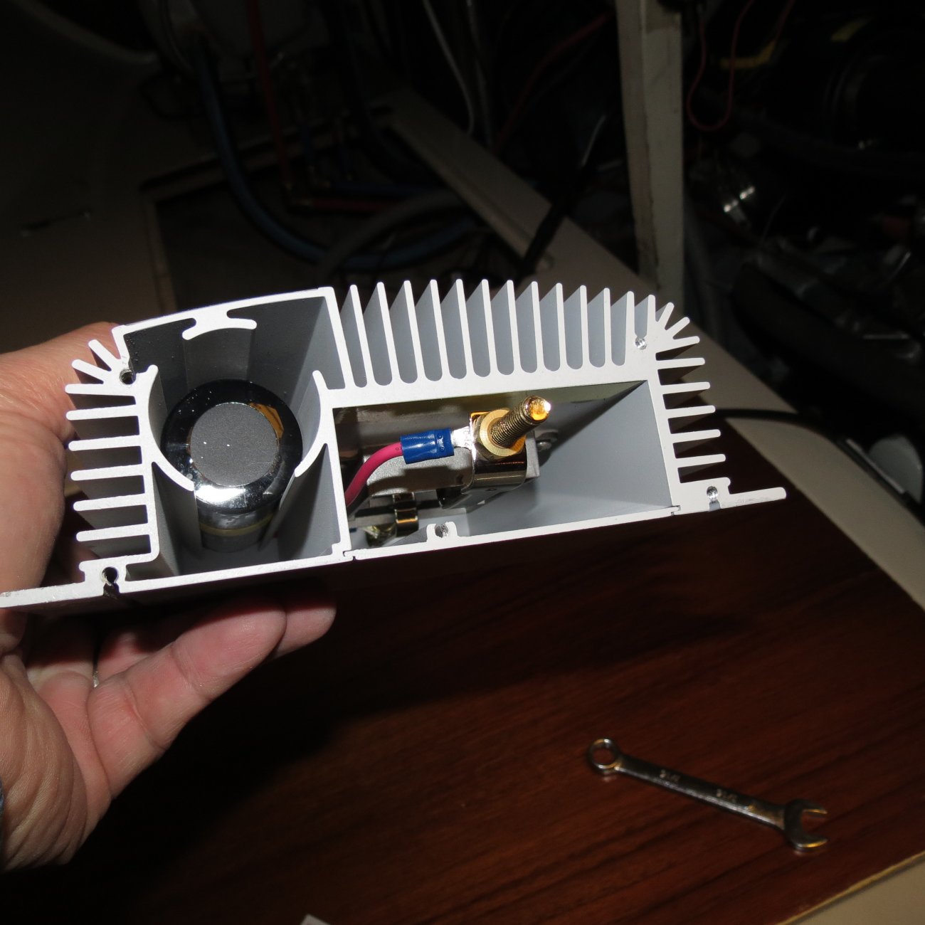

Well, I'll be a monkey's uncle! That end cover really is made with plastic (so the aluminum case isn't grounded by the stud). I took it apart again yesterday and when I first looked at it I could swear it was aluminum. I must have been too frustrated before to take note of the details. I'm getting better at clasping the nuts in the dark recesses (please don't go there :doh:) so I took it apart one more time.
Where I mentioned that the stud is not linked to anything, I was, again, wrong.:redface: It is actually threaded to a bar that is linked in the interior. That wire is also electrically connected to the bar. What it does inside the case, I haven't a clue! But, at least I have new found respect for it!
