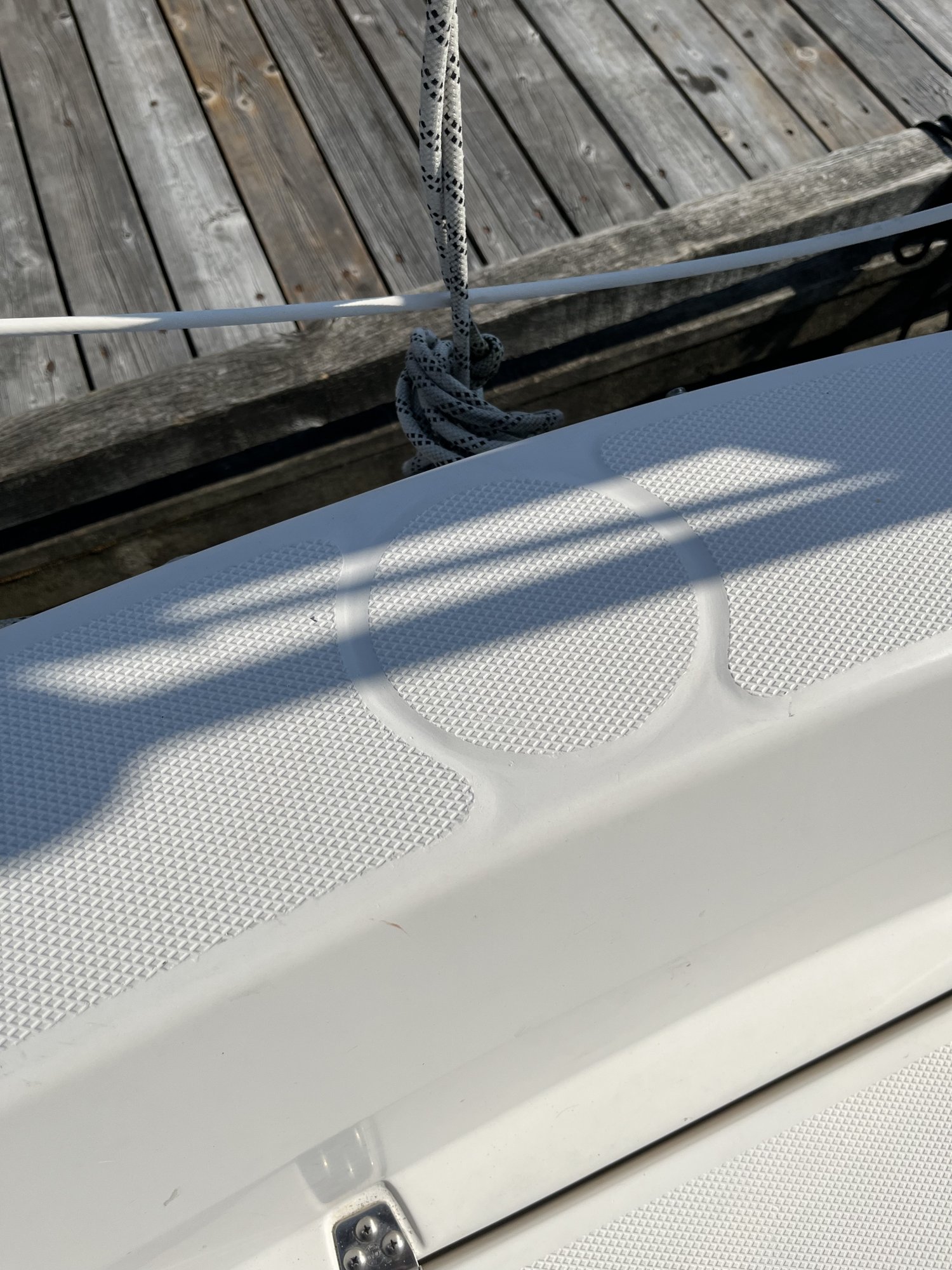

Our 2000 H320 is a great family boat, but sometimes the sailing leaves a bit to be desired (mostly due to operator error).
I'm considering putting 2 new winches on each side of the cockpit in the area that looks designated for such installation (picture attached). Currently we have only 2 winches next to the companionway - a 30ST to starboard and 16ST to port. It's a bit of a pain with the mainsheet and outhaul requiring the starboard and I think having 2 winches set back for the jib sheets would be nice.
2 questions - 1. Any thoughts/experience. 2. Is there an aluminum plate embedded in the glass at the pictured point to support a winch?
I've got the same thing on the '99 H-310. You may be able to see an embedded plate in there if you can get a strong light under the mount by going through the overhead lighting below. Do this when it is dark outside and you will see an outline of a plate if one exists.
Another route is to drill a hole through the mount with a small bit (1/8") and check for aluminum cuttings. Fill the hole after with white gel coat if you have some from repairing spider cracks. That's if you don't find a plate and don't proceed with the install.
Yes and no.
Yes, I have the same mounting points on my H280. Yes, I have added winches there.
No, there was no aluminum mount or backing plate installed in or under my mounting points. I did read in numerous articles that Hunter did install the aluminum mount or backing plate under these locations not used from the factory. This is not my experience.

Another way to determine if there is an aluminum imbed plate in the deck is to use a moisture meter. Any metal in the deck will cause a false 100% saturated reading.
Oct 29, 2005
2,362
I fitted 2 winches on the same location you shown. There should be backing plate within as its meant for spinnaker winches. One important point is orientation of the winch you put there. Make sure you mount with the removable component parts facing inside of cockpit (when drum removed). Mine faced outward and almost lost some parts as I remove it for servicing :( Kinda late to turn it around now as it was bedded down.

At the end of the day, once you get your winches and drill the mounting holes, you will know if there is a plate installed. You can assume there is a plate for now and always get a backing plate later if necessary.

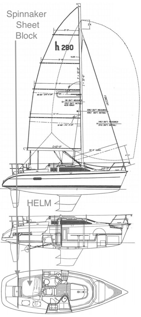

Good morning @chp .
First, I want to say that it is your boat, and you can do whatever you desire with it to make it function for you.
Looking at the Hunter 280 design. It was not designed for a big foresail (jib). The sail plan relies on the larger Mainsail to drive the boat. The sail plan has the jib at 43% of the sail area (338 sqft) and 56% allocated to the Mainsail. When preparing a sail-plan, the designer considers the standing rigging/hull/keel/mast and space allotted to the skipper and crew. The smaller forces of the jib on the control lines allowed the running rigging to be located next to the companionway. This coincidentally supports the marketing of "Safety in all lines served from the cockpit." Optimal trim of the jib can be accomplished by keeping the sheets short and running along the cabin top to the bow end of the cockpit. This is not to say that owners have not put winches further back on the combing. Some have even placed large winches there at considerable expense with marginal functional improvement.
Regarding the Spinnaker. I suspect an Asymmetrical spinnaker would help drive the boat on broad reaches to the downwind. Depending on the conditions, a moderate-sized asymmetrical sail would be my suggestion. If you have one of the shoal draft keels, the rocker shape of the hull coupled with a large spinnaker could tend to create a broach risk as the rudder lifts out of the water. The mast and standing rigging are intentionally a lighter-weight design.
In light wind conditions that favour using a spinnaker, you want to be able to hold the lines and maintain trim control of the sail. For this purpose, I would run turning blocks at the location on the diagram. This puts sheets in the cockpit.
Enjoy your boat. It is a comfortable rig to sail—sporty and fun on the water.
