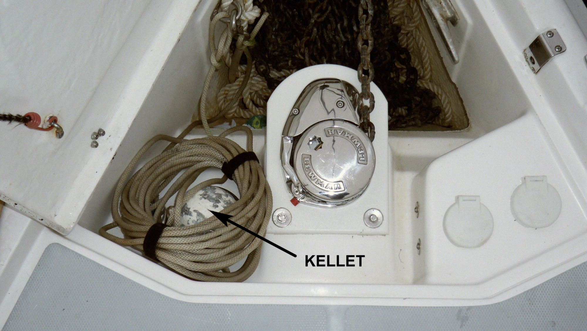

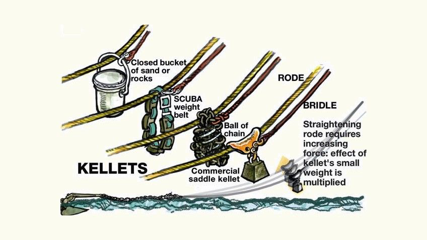

If your using mostly rode (line) you can accomplish the same with a Kellet. It would be a whole lot lighter to use and retrieve manually. Here are some examples. You would retrieve the kellet first up the rode, then haul up the rode and anchor.
