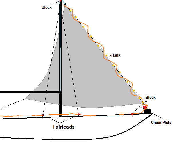

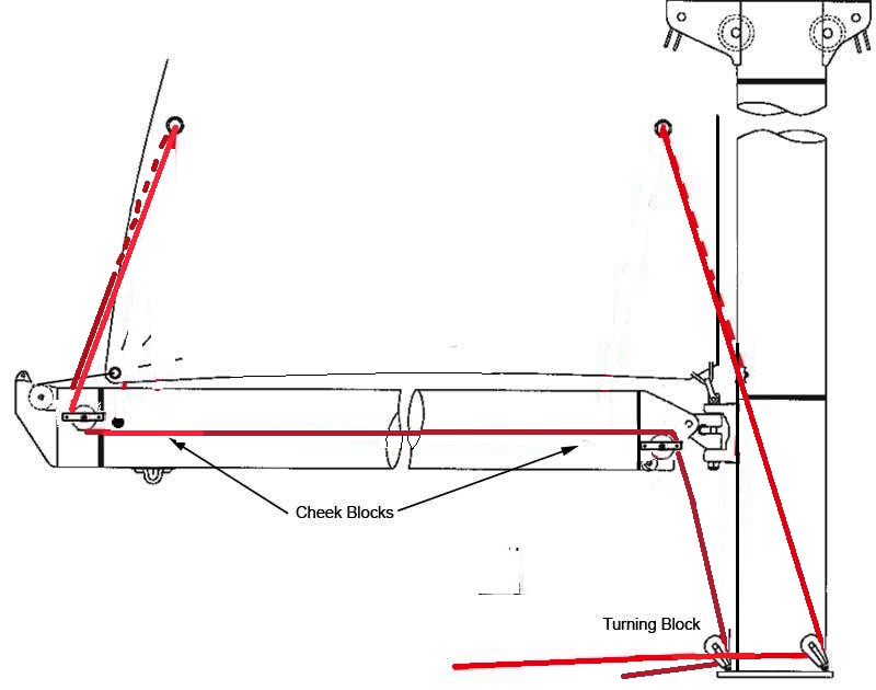

It looks like you have a hanked on head sail. I like hanked on head sails and rigging them with a simple down haul will make your sail changing a LOT easier....(see pic) Also snoop around Bacon Sails for a used (but still in good shape) head sail and then maybe a 75 head sail for when you have a reef or two in your main. Rig your main so you can reef from the cockpit and run the headsail's down haul back to the cockpit. Then it would go like this... wind pipes up to about 12 to 15 and you put the first reef in the main. Wind pipes up to about 18-20 and you drop the headsail and bend on the 75%. This will keep the helm balanced and the boat moving forward instead of heeling. It will be a lot more comfortable if you slice through the waves with some power rather than being thrown over the wave.... if the wind gets to 20+ you might need the second reef in the main and if things get narly (like getting caught out in sudden blow.. you drop the main and make your way with the 75% only.
At least that is how it went with a Mac 22 I used to own. When the wind is really blowing, some boats do better with a double reefed main and no head sail and others handle better with just the headsail. You will have to feel out your own boat.

Do not rig your jib downhaul like this picture.
First: The connection should be to the second hank from top, not the top one/headboard. Why? Because connecting the downhaul to the top, next to the halyard will cause a foldover, jamming it up. The second or even third hank will include the luff in the downhaul action.... works perfectly.
Second: The downhaul line doesn't need to be interwoven around, or threaded through the hanks. A free line will minimize friction. Simply adjust its tension to pull out the slack.
Finally: Use small diameter line. My downhaul is 1/8" dacron.... There is very little load on this line.... it's purpose is to control the drop of the sail so you don't have to go forward to lower it. My routine is to hold the halyard in one hand, the downhaul in the other and steer with the tiller between my knees, allowing me to steer the boat under the sail as it comes down neatly on the foredeck. Cleating off the downhaul will keep the headsail under control as you proceed towards your destination.
