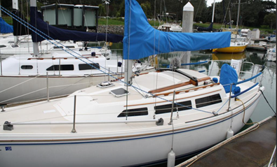

Photo of a Catalina 22 with jib sheet track outside the lifelines. If that is an issue could install new jib track adjcent to the cabin OR eliminate the stanchion in the middle of the track.
