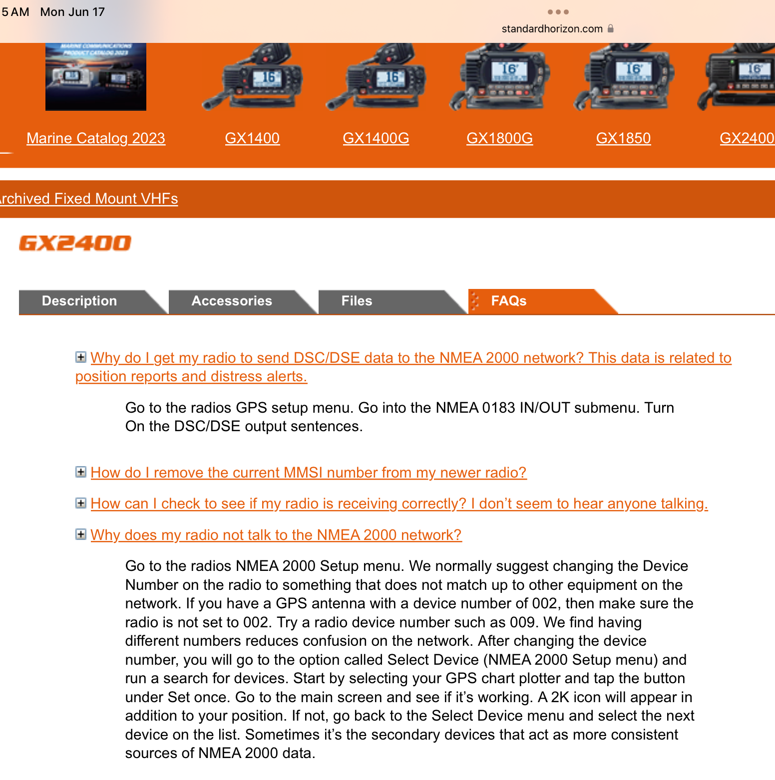

In the abscense finding that Unicorn, perhaps the manufactures can help. Checking the SH site for the GX 2400 their Spec page says the unit supports NMEA 2000 and NMEA 0183 PGN data both In and Out bound.
The FAQ has tech responses resolving DCS call set up queries.
I have to believe they are not just printing marketing hype. If still concerned it would be reasonable to contact customer support with the DCS issue.

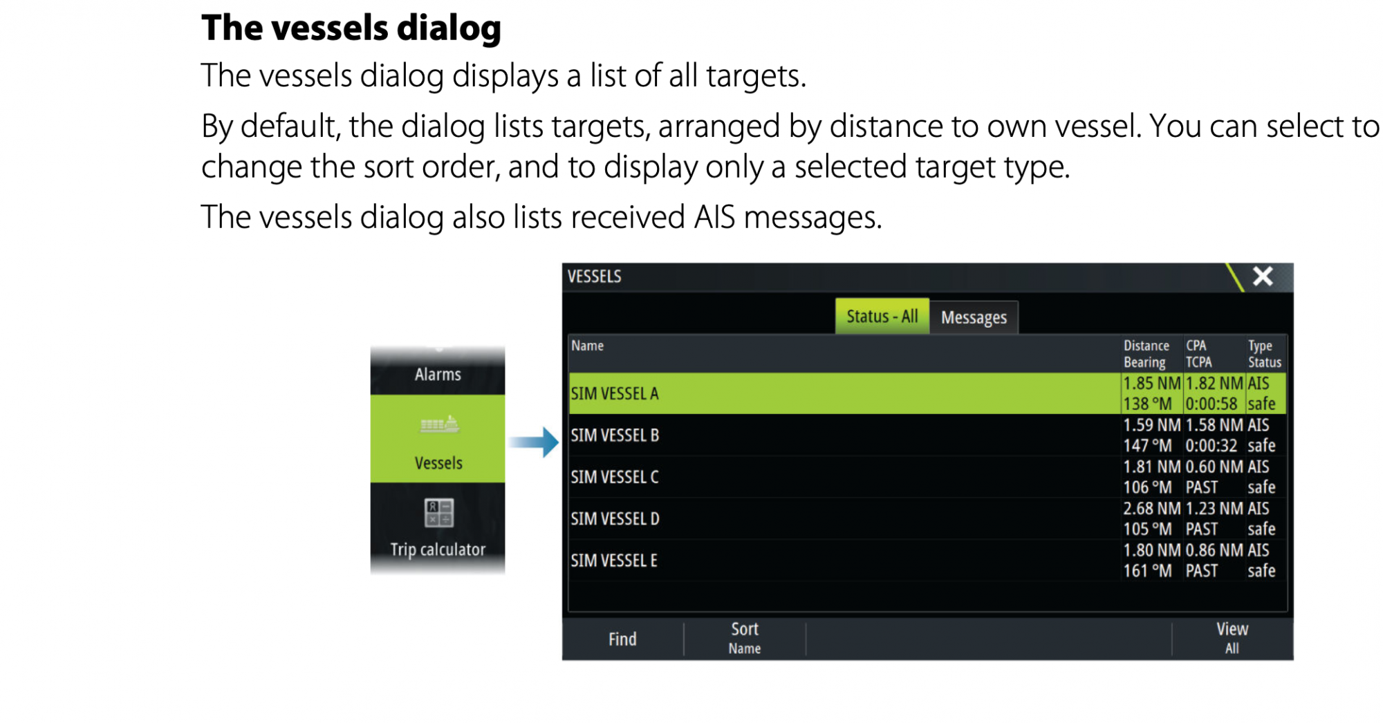

When you looked at the AIS Detail popup, did you look under the "Messages" tab? There might be a button there to initiate a call.
