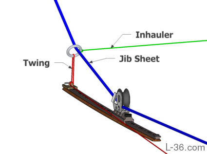

Inhauler, twing, tweak, barber hauler. What is the correct term. I always thought it was barber hauler.
Les, I use the term inhauler as a general term for what it does and, here, to stay with the terminology used by the OP. There is a difference between a Barber hauler and a twing.
I've only recently learned what a twing is, but a Barber hauler is usually an out hauler because it was originally connected to a block on the toerail or a stanchion post base to open the slot. The term, I think is used for inhaulers, as well and they traditionally attach directly to the jenny clew.
A twing, as best I can find, are down haulers that use a ring or 'beaner on the jib sheet. They are often combined with an inhauler. This is mostly new to me, but consistent with the little I already knew about Barber haulers. Here's an illustration of a twing.
Oddly, most of the examples I've found of twings have them attached at the head of the traveler track. I don't know why the traveler car can't do exactly the same function in that case.

Will Correct me if I am wrong but when you say "traveler track" you are referring to the track that the jib car is running on.
You are correct that moving the jib car forward would have the same affect as using the twing to pull the sheet down. The advantage is that the adjustment of the sheet lead can be done under load with the twing but unless you have the fancy adjustable car system, you will not be able to move the car due to the friction. On my C30 I can only move the car when it is unloaded so I need to wait for a tack to make an adjustment. I might just need to rig a twing to see how it works.
-Will (Dragonfly)
Will,
With the setup you displayed (Twing at the top of the track), it appears to me that you can adjust the length of the twing line (say that fast 10 times) which would allow the in haul line the ability to be adjust inward, the longer the twing the more inward the clew could be adjusted.
