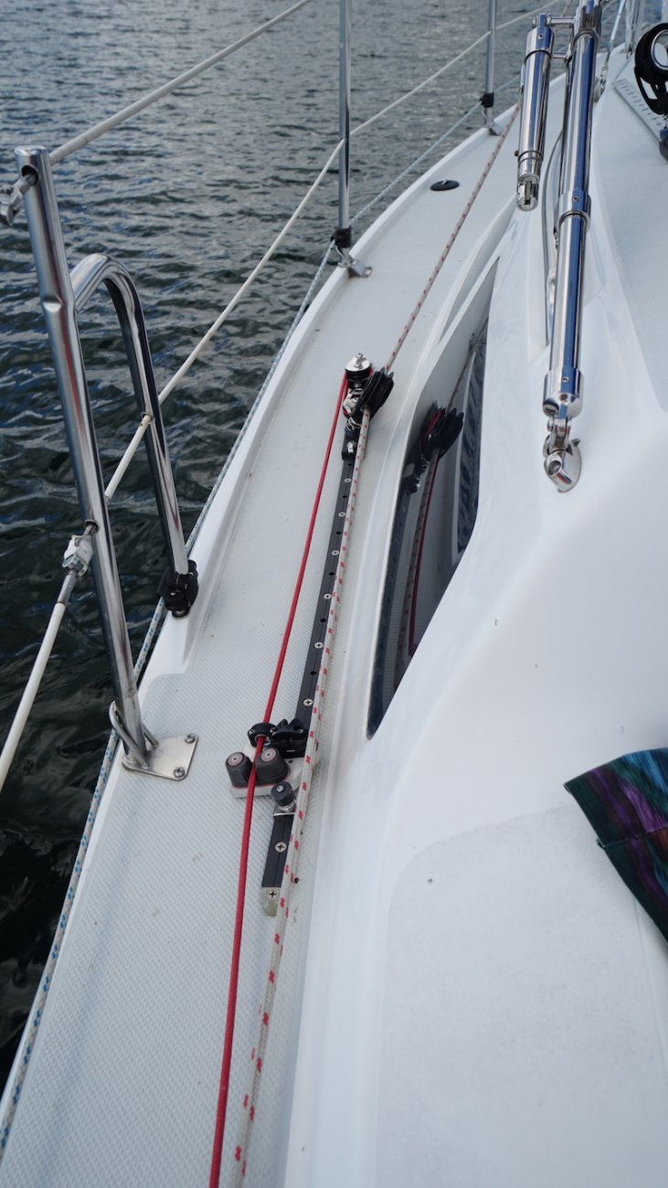

The Catalinas do not have the toe rail with a zillion holes, and as such it limits the places for attachment of restraining lines. Not only is a track a good way to do it, the Garhauer EZGlide system allows infinite adjustment of the trim, on the fly. It's not just for racing.
11,384
CAL 35 Cruiser Portland OR, moored EVERETT WA
Your rig looks sweet Meriachee... It also looks like a bit of stuff to stumble on if you want to move quickly to the bow.

That's the downside John, you don't exactly have the widest decks on smaller boats, and the deck on a 30 isn't that much wider than that of a 270. There just isn't a lot of places to attach a barberhauler, and it's not like the stanchions are welded schedule-anything pipe. I certainly wouldn't risk loading them up with a 155.
Catalina does publish the specs for these boats with a drill pattern as the deck track is an option.
If you move the furler line to the outside, it does open up a lot of space.
