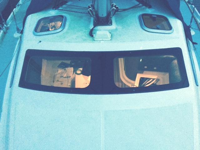

Scott, I received the same instruction from Hunter for replacing fixed ports quite a number of years ago. The one item which still haunts me to this day is their reference to the embossment flanges being 1/2" to 1" wide. The narrowest section of flange I have here is 2-1/2" wide and I'm still working on a strategy to remove the glass in one piece.
It leaks in two locations which I've dug out and resealed twice but otherwise the glass is in perfect condition with no crazing .............. I have no idea when I have crazing everywhere else. I doubt I can save it from destruction.
The other thing Hunter omits, which I've learned over the years, is to use an adhesive backed foam rubber spacer to GUARANTEE a 1/8" thickness of 795 between the flange and the glass. This lack of thickness is what causes the leaks as a result of thermal expansion.
