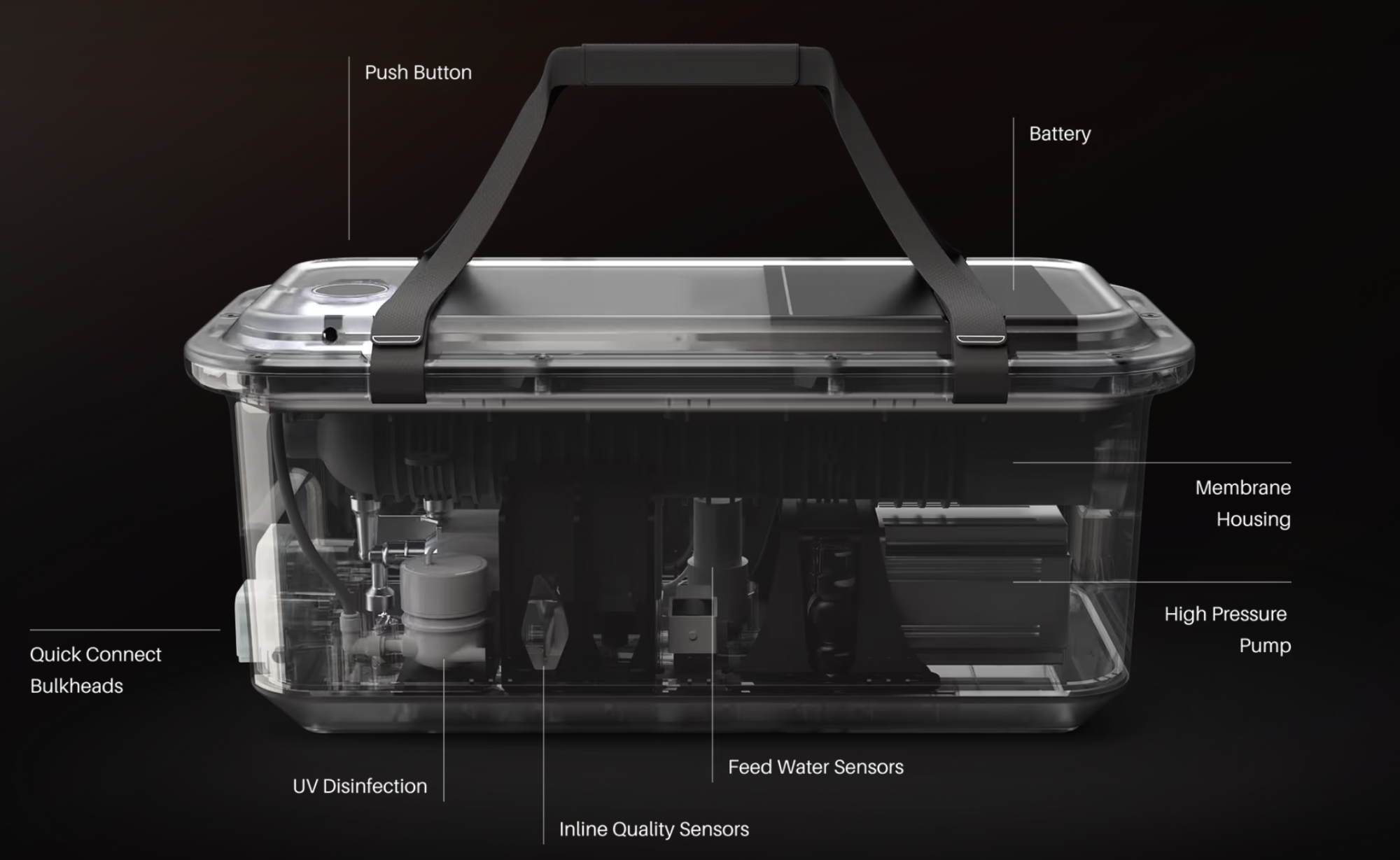

I could have fit a modular or compact watermaker in the v-birth by removing the mirror cabinet above the sink and building a slightly larger cabinet (i'd probably remove the sink, like in the H38). I could have fit here a single or dual 21" membrane, like the electromaax solarmax 200 or Aqua Nautica Aqua 30 Pro
I also could have fit a larger unit in the aft starboard lazarette if I relocate the diesel heater and the vacuflush to the port lazarette and then use the space that was intended for the generator, this would have required running a 40' water line from stern to bow which I wasn't too excited about... but ....
Vital Lyfe are expecting to start selling their compact / portable water maker this fall, so I placed a pre-order.
Whereas most Clark pump watermakers make 7-10 US G at about 140 Watts (18 Watts/ US G), the Vital Lyfe is expected to do 6 US G per hour at 200 Watts ( 15 Amps @ 12.8 VDC) (33 Watts/ US G). So a little less efficient but not by much. If the numbers pan out, that means making 90 L every 3 days would cost us about 55 Ah (including flushing time). We can live with that. Considering we're switching on the hot water tank almost every day (800 Watts for 45 minutes = 50 Amp-hrs)....we expect to use the induction cooktop to handle a lot of our hot water needs .
So not nearly as efficient as the clark pump but much more efficient that the majority of cheaper watermakers that just use a high pressure pump.
Bonus is the size of the whole thing 20 x 9 x 8 inches.
I know this sounds like a sales pitch (i'm not affiliated with the company ... no kickbacks or nothing), but for ocasional use (say 1-2 months a year) this seems like a great option, especially when you consider that it's expected to retail for 1/10 th the price of a traditional marine watermaker.
Depending on what we plan for a cruise next year we might just use it on deck twice a week. If we plan a longer trip and we want to run it in motion, then the water feed hose I'll just stick down the sink drain hose till it reaches the thru-hull. I'll have to tap a line into the water fill hose, T it off, and install a valve or a dry break quick connect.
Needless to say, I've put in a pre order (small deposit required) and hopefully it's integrated in the boat by next spring. Access | Pre-Order Now
This is not an ad! Just a PSA for fellow members (hoping I don't get banned...).
