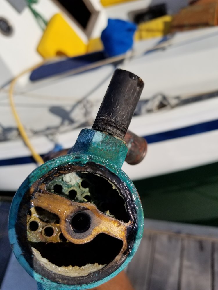

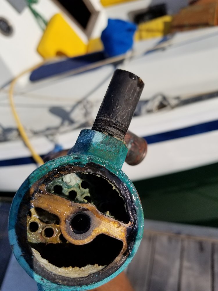

UPDATE: removed heat exchanger and definetly needs so tlc. Gonna let it soak in some barnacle buster for a day to clean it out.

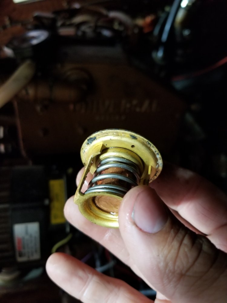

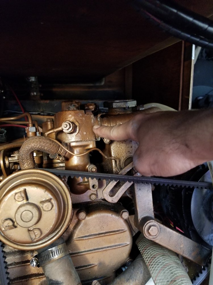

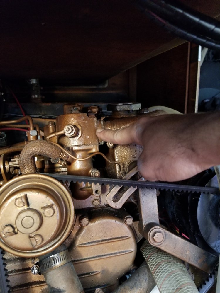

If it is not the heat exchanger is it possible my thermostat is closed? Would that prevent the water from circulating out? Is this my thermostat?

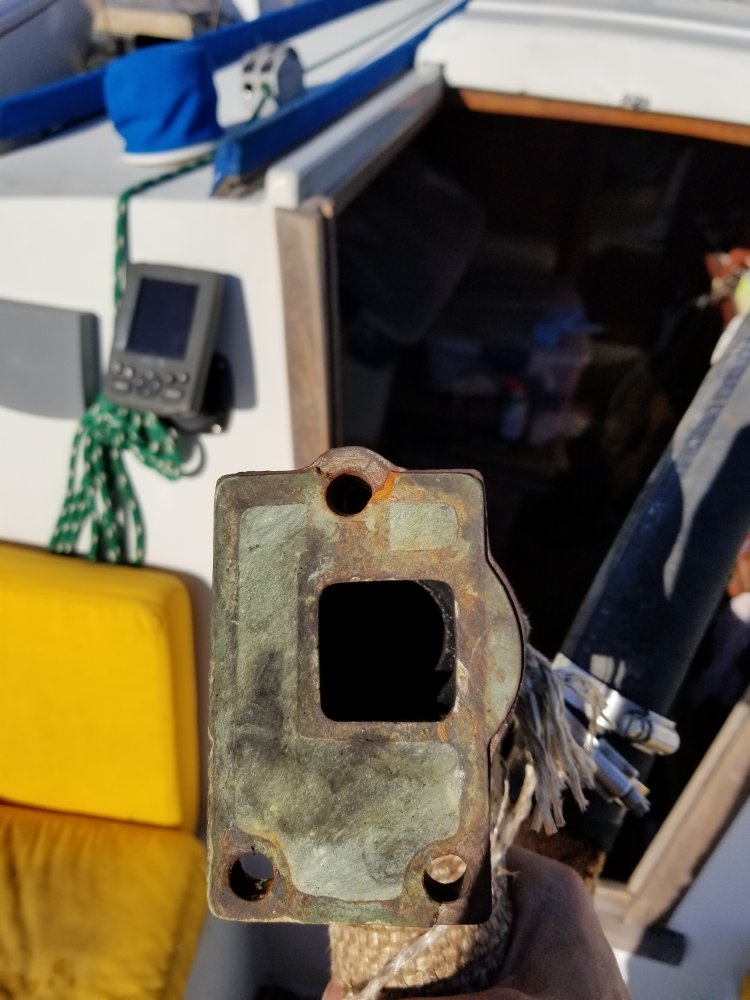

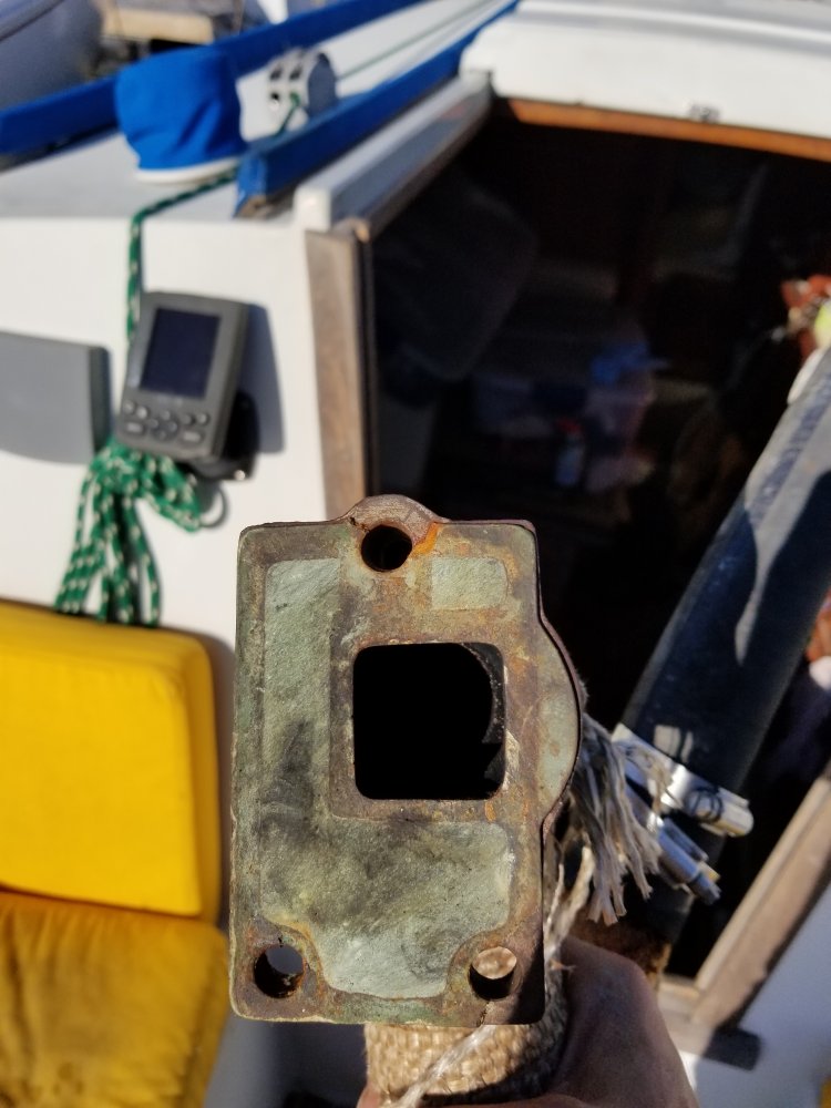

Checked mixing elbow and water isn't reaching it and has black burnt stuff inside but definitely not clogged
I've heard of some engines blocking the whole reason water circuit with the thermostat, but on most engines (and our old Universal) raw water still flows regardless of thermostat state. Can you try running the output of the raw water pump straight into a bucket to see if it's pumping, then work your way down the circuit from there?

Yah I did that. Is that the housing for the thermostat?
Yes, that looks like the area, but if you follow the raw water circuit it probably doesn't go near there, so it's probably not related to lack of water in the exhaust. The raw water will go from thru hull to pump then heat exchanger then mixing elbow. The thermostat only affects the routing of the fresh water.

There's a heat exchanger so there must be a fresh water system. The heat exchanger basically does what a radiator does for a car - cools the fresh water. A car radiator uses air for cooling; the boat engine uses raw water through the heat exchanger. The thing you're pointing to in post 14 that says Universal is the coolant resevoir. Open the radiator cap on it (when the engine is cool) and there should be antifreeze / fresh water mix.

Ok you guys are right. After I finish up I ad 2.2 quartz of coolant. Is there a process for that or is it that simple? Heat exchanger had all holes completely filled with build up so once that comes out of the barnacle buster in a few hours I'll reinstall it.

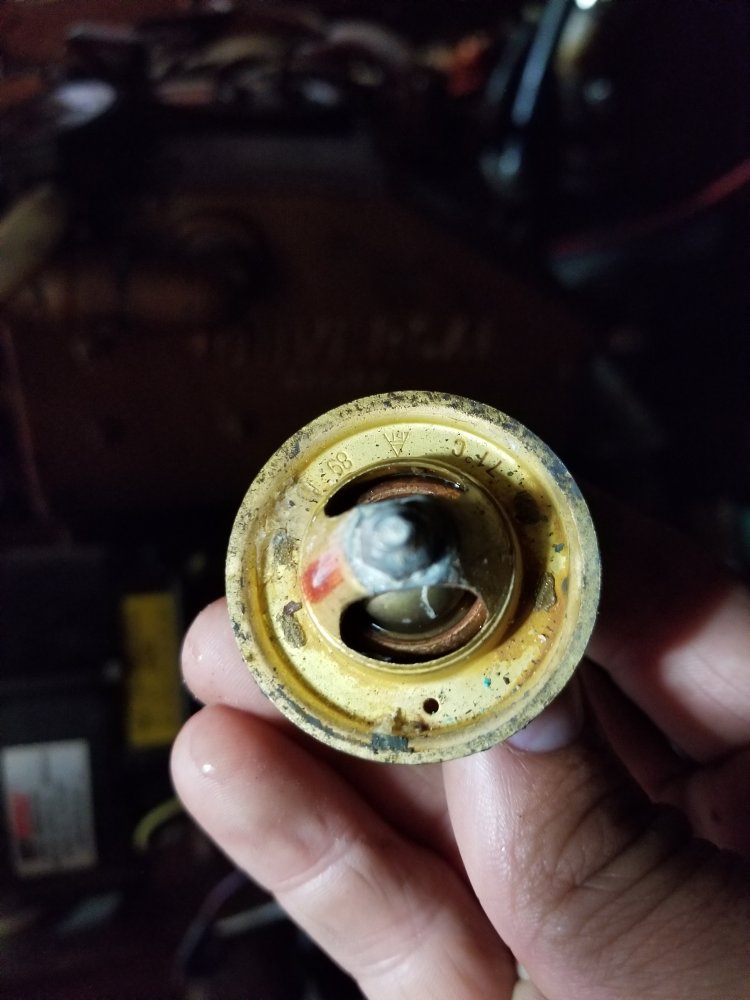

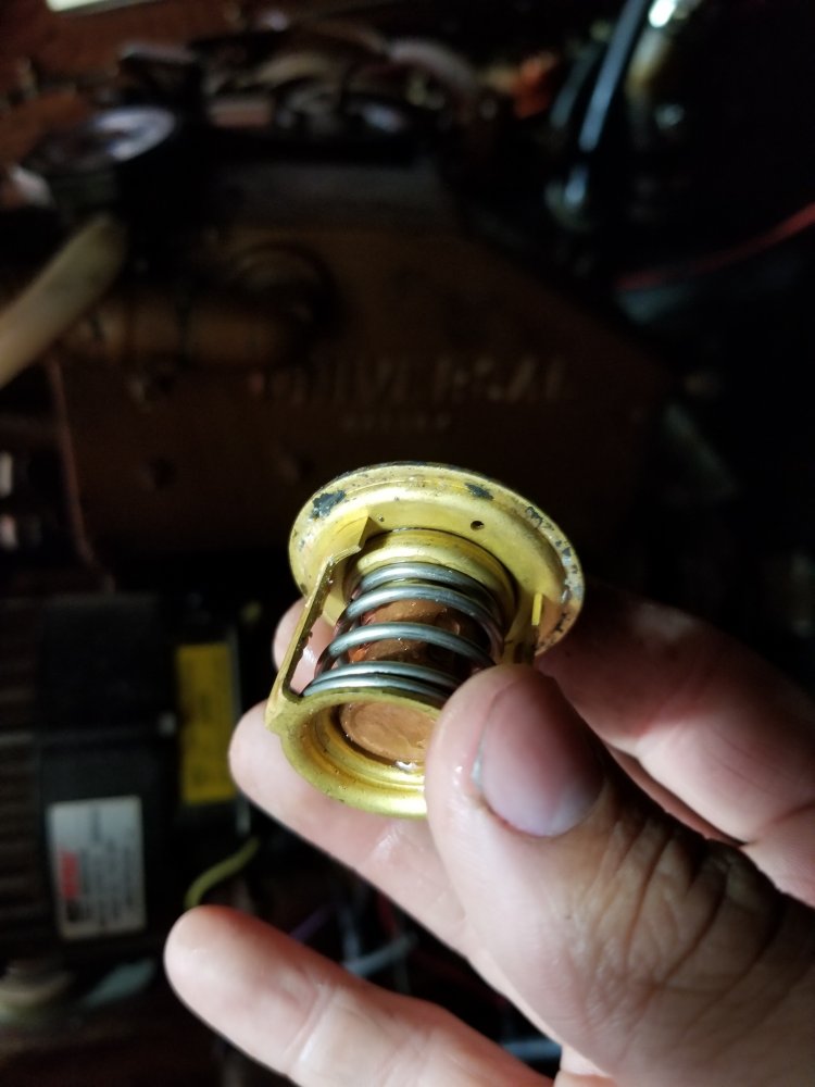

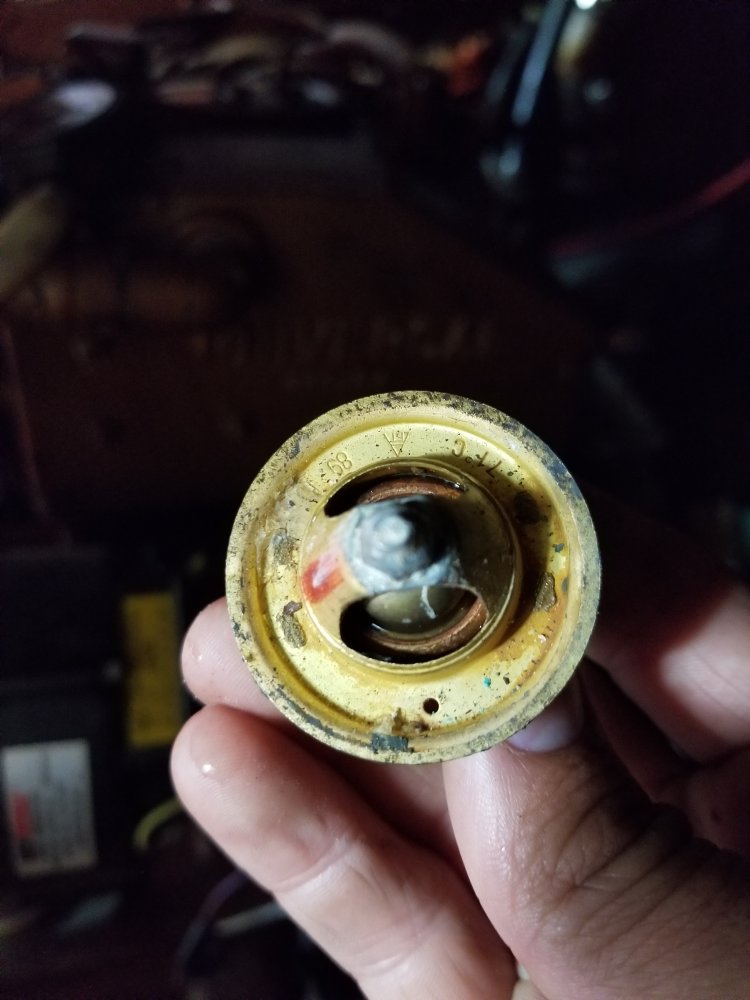

Just pulled out my thermostat could this prevent raw water from pumping out? How do I diagnose the thermostat?
Water should pump out regardless of thermostat state. It will only affect routing of the fresh water. If you want to test it anyway you can put it in a pot of water. The thermostat should open when the water gets up to its set point (maybe 160ish).

Did the boiling test on thermostat and its in working order. Just finished putting heat exchanger back in started up the motor and saw a leak on the side so it needs a new gasket to prevent the leaking. No water was coming out yah. Tightened the leak and it is a small trickle but then I look over board AND WATER!!!!!! pouring out of the exhaust and it was glorious!!!!! Thank you everyone for the great advise!!! First engine maintenance and learned so much!!!!

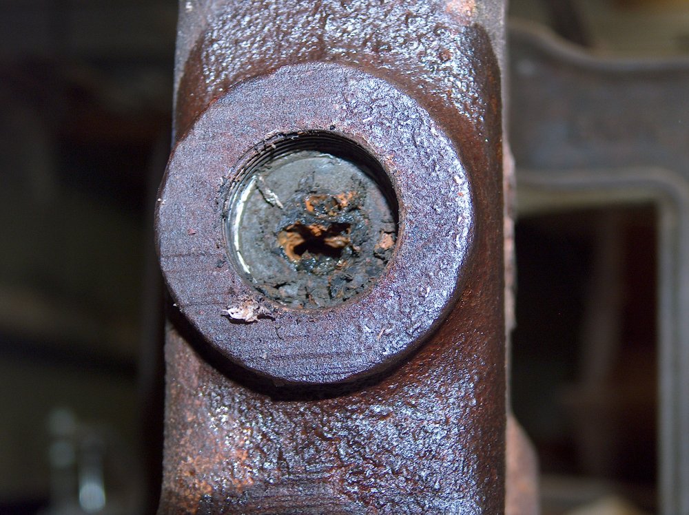

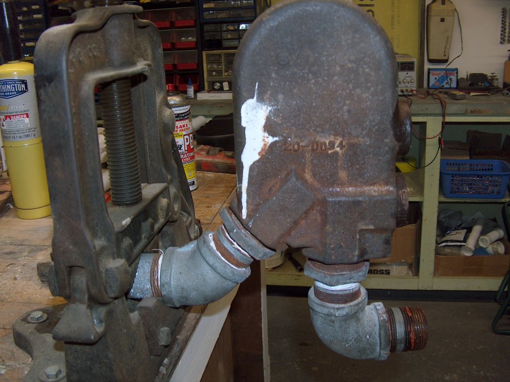

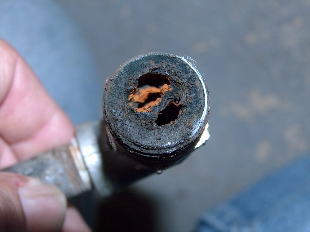

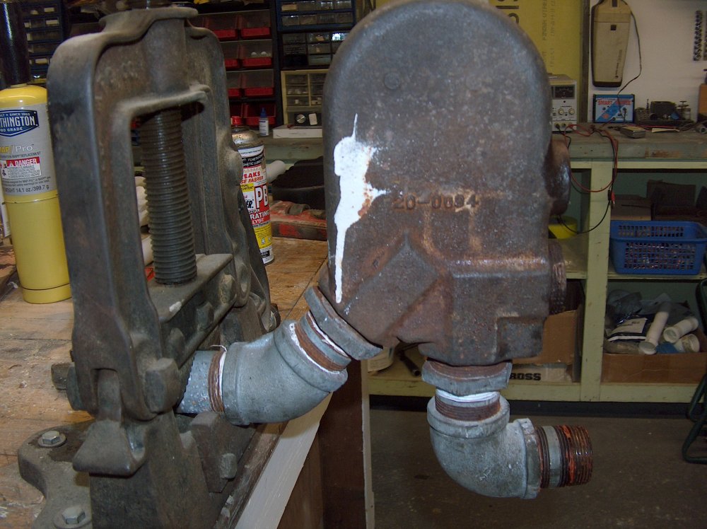

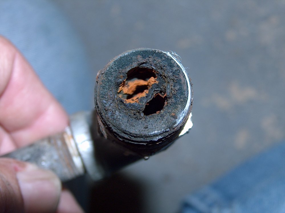

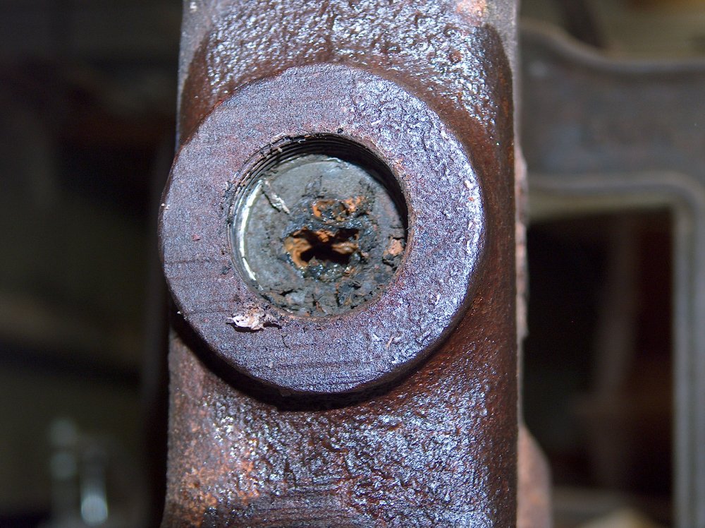

I know this is different from your exhaust elbow, but this is what we found when we disassembled our cast iron Barr Marine unit:
1: overall view (exhaust inlet on the bottom right, water inlet above; exhaust outlet on the left)
2: 1/2" pipe elbow connected to the cast iron elbow
3: female thread on the exhaust elbow where #2 is connected
This is approx 20 years old with 600 hours on the engine.
Likes: Jkirkendall91
