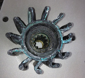

Next, with the thru hull closed, open the raw water pump. Should be 4 screws in the face cover. You will know the pump because you have traced the hoses from the thru hull pass the strainer to the pump. Open the face cover and inspect the raw water impeller. It should look something like this.
8374.jpg or this ITT-Jabsco-63030001P-6-Blade-Neoprene-Impeller-1801393623000.jpg
If you see any of the vanes cracked or missing you have found your problem. These should be checked and often changed yearly. You will need to identify your pump and get the proper "Impeller" to fit. You will want to have a spare on the boat.
SO get a new one for your engine and then do the inspection. You may find a new looking one in your boat. and the new one you just bought is now the spare. You may find it looks something like this...
xjp9X52-Lweb.jpg no there is your problem.

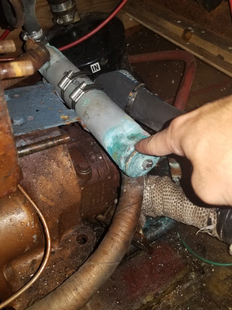

Thanks guys! All really great advise gonna attempt to see if their is a clog in the elbow. Found out my friend tried to do oil change and put water into this...don't even ask how..."I will destroy my own engine thank you very much." Is what itold him. Keep you posted
24,797
Yes. Looks like it has had some copper corrosion (turning green) as a result to moisture. Good idea to clean just like you do with a car radiator. If you find pinhole leaks than worse case you may need replacement.

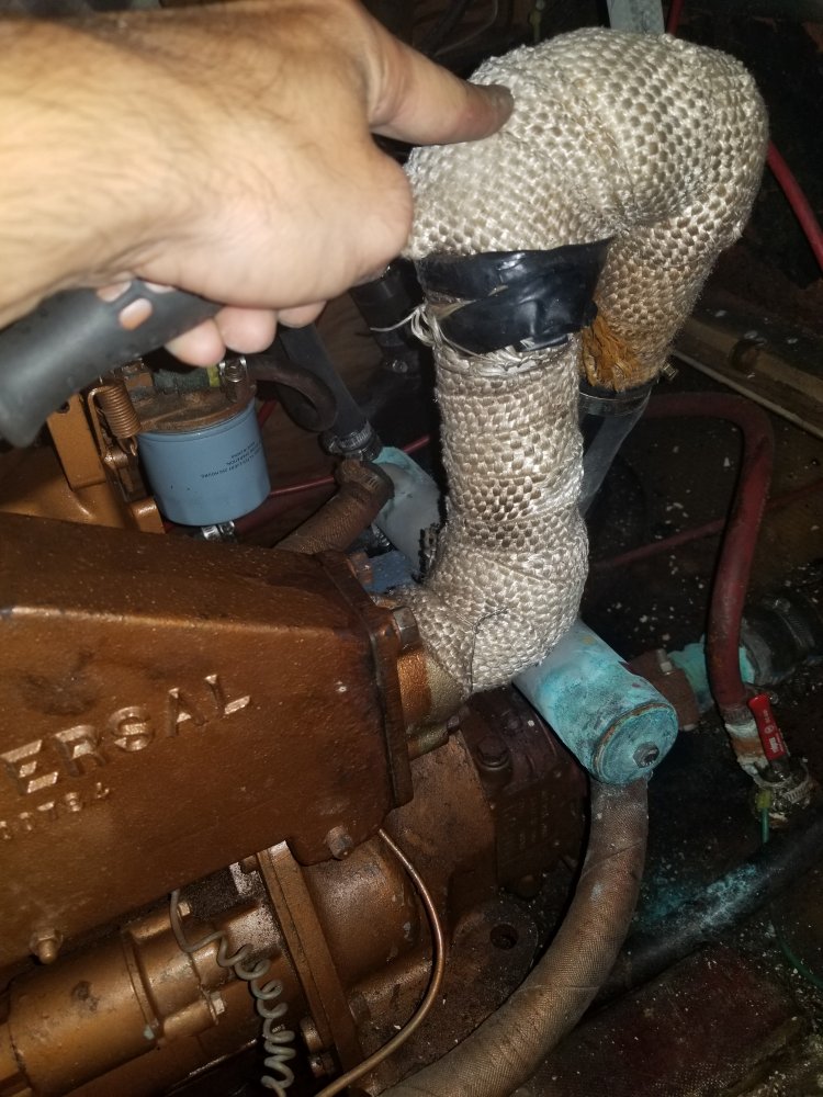

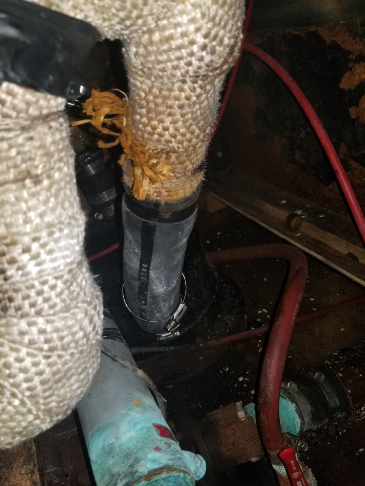

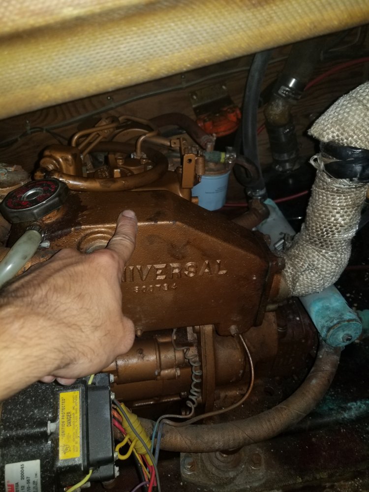

The black thing looks like your exhaust hose. The part prior to that wrapped in the cloth is your mixing elbow. I would start at the beginning and open the strainer while seacock is open and see if you get water rushing out.... assuming it’s belowwaterline. If it’s above the water line you may have to prime it. If boat has been sitting the fitting in the hull could be fouled with growth and sea creatures cutting off water as well. And also know..... you don’t want to flood your engine so Be careful. When you start engine can you see exhaust existing tailpipe?
