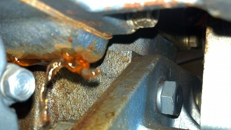

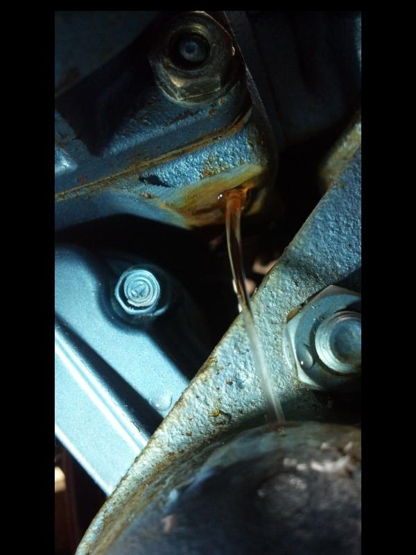

Update: I filled it up with engine coolant and here's what I saw: coolant pouring out of the bottom of the heat exchanger. Do I have to replace the heat exchanger, or can it be welded?

you may be able to weld that ...take it off and take it to a radiator shop had have it checked out ...if thats the only place that is cracked take to a machine shop and have it welded...but make sure the machine shop you go to has the ability to do it ...if i were to weld it i would use certanium 889 electrods......hope this helps you in the right direction ....after all you don't have much to loose at this point .....or you may have a T I G welder weld it with bronze silicon filler metal

First make sure the hole is not a drain hole that is open. If there are threads in that hole, a plug goes in there..
Any other coolant coming out of the engine block?

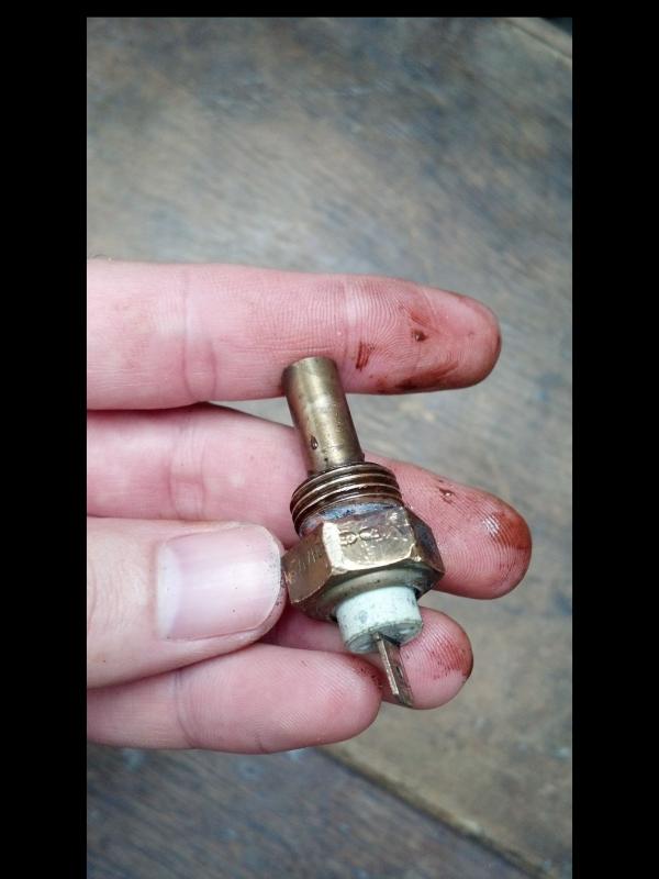

Why the picture of the sending unit?

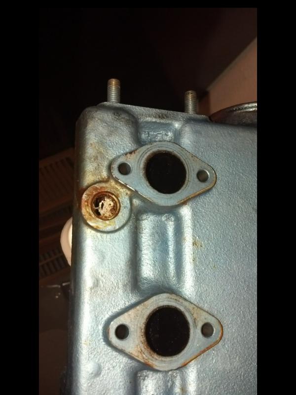

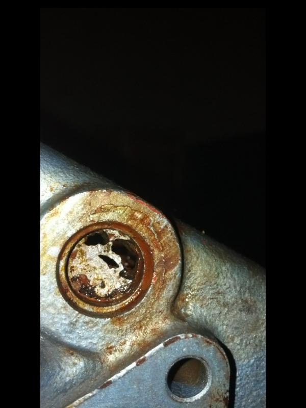

The hole was actually here (see attached).
Luckily the entire heat exchanger wasn't cracked, as previously thought.
I don't have the tools or know how to weld. It looks like patching this would be easy. Any quick fixes I could do myself?
Recommendations please!

Is the leak in that little metal cup? Looks like a freeze plug to me. You could either take it to a mechanic (freeze plugs are used in car engines too) or measure it, buy one from a parts house and check goggle instructions for removing and replacing freeze plugs.
If it's a crack, take it to a welder. As an old Master Blaster I know is fond of saying "you can do it right or you can do it again".

Hmm. What is a freeze plug? I don't see any threads, but i could be wrong. The leak is coming from the hole and there are no other cracks.
My ipad only let's me attach 1 picture at a time. Hopefully this image helps more.
