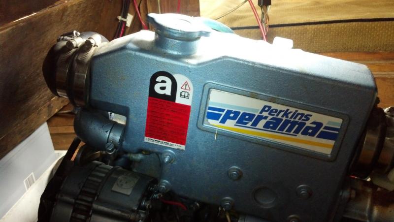

Hello everyone. My name is David and I'm fairly new to sailing. My wife and I have owned our boat for 3 years now, and I could use some of this forum's expertise!
Last week we took our Cal 29 out for the first time this season and after motoring for about 15 minutes, I smelled something funny, and noticed that the engine temp was pegged to the right. We shut off the engine, put up the sails, and sailed it in. I turned on the engine for about 2 minutes- just long enough to get us safely back to our well. This is my first big engine problem, and I was hoping some experts out there could help me figure out how to troubleshoot this before I have to shell out tons of cash on for a mechanic.
Here's what I know:
-Impeller is brand new, and water (not smoke or steam) is coming out of the exhaust pipe.
-When the engine was hot, I thought I may have heard a hissing sound, but am not sure.
-Engine was properly winterized and has just had an oil change.

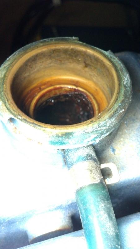

-After the engine cooled, I took off the radiator cap and noticed rust.
-The engine still starts up without any problems.
I've never worked on boat engines, and don't even know where the thermostat or internal water pump is located on my engine. Any helpful comments would be much-appreciated!

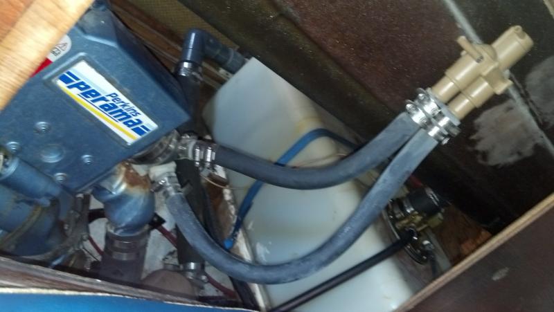

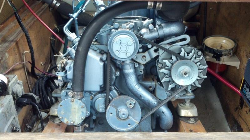

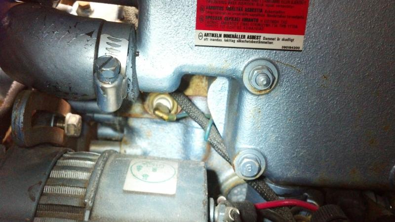

In short, your circ pump (fresh water/antifreeze) is the top pulley on the engine front. The thermostat is often just above it (with the painted hose running into it). There should be hoses going in and a wire coming out of it. Your picture did not show antifreeze in the resevoir so you may have an air bubble in the system, which I would take as the most likely and also easiest fix.
Oh, I noticed on your picture that the raw water pump is missing a screw off the cover plate, it won't cause overheating, but could slowly weep or seep and cause corrosion.

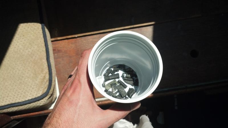

I finally got to work on the boat for a bit today. I took apart the hose past the impeller, and was shocked at what I found- tons of impeller pieces! (See photo below). Since I've never had a broken impeller, the owner before me must have blown up an impeller and just left it clogging the water intake port. Gee, thanks! Anyway, I cleared all of the pieces out, and fired it up. Wow! About 3x the amount of water flowing out of the exhaust!
Only problem is that the engine still is overheating. I turned it off after running it at 2000 rpms for 7 minutes- when it hit about 225 degrees Fahrenheit. The next thing I am going to check out is the thermostat. I know where it is, but didn't have the right size socket, so I am going to remove that on Tuesday when I can get out to my boat again.

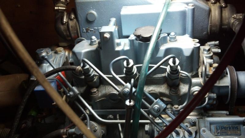

Could anyone provide me with a quick way of testing the thermostat to see if it is indeed broken? Also, dparilla mentioned something about an "air bubble in the system." What is this, and how can I fix it? I've posted another picture showing the heat exchanger, but I have no idea what the two tubes coming out of the top portion are. The rise up into a tan thing. Could anyone please help me in determining what this is, and what it is for?

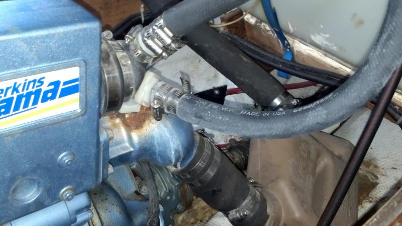

I'd check the thermostat and the heat exchanger. The hose you mention looks to go to a vented loop (brown thing, and on to the exhaust elbow) which serves to avoid syphoning.

2. Thermostat - it will have a # stamped on it, usually it's in degrees C, not F, so do the conversion, boil some water in a pot, get a thermometer and see if the thermostat opens. Even easier: by the time you take the old one off you'll need a new gasket, so just break down and buy a new gasket and thermostat and be done with it. Then check the old one. If it works, keep it as a backup. They last forever.
3. Burping your engine - air bubbles. If you have a hot water heater for your drinking water, there's a "branch" of hose that goes to and through the heater. Sometimes/usually, this is where the air is trapped and a slug of air leads to overheating. Either you can use the petcock on the top of the thermostat housing, or do this: Engine Overheating 101 - How to Burp Your Engine (Reply #6) http://c34.org/bbs/index.php/topic,4518.msg26462.html#msg26462

DaMoses, Another quick check would be to remove the black cap over the front of the heat exchanger and take out the rest of the impeller blades.. That is the cap that the water hose goes to from the seawater pump. Take off the back cover (black cap with hose going to anti-siphon valve) too and you should be able to see clear trough the tubes.. you may have to take something like a rifle cleaner and rod out the tubes to get all of the impeller parts out. Check the hose through the anti-siphon vent and down to the fitting on the exhaust pipe.. I am surprised to see a plastic fitting on your exhaust mixing elbow! This should be replaced today with stainless or bronze.. Be careful to get the gaskets on the front and back of the heat exchanger back in exactly the correct locations. Get a mechanic (or a capable gear-head friend) to guide you if you don't feel comfortable doing that work..
Ohhh don't pull those covers until the antifreeze/coolant is drained. You may want to have the coolant side vigorously flushed while the coolant is out.. The "rust" may be hard deposits from letting old anti-freeze sit in the engine too long.. If that is the case, pull the heatex tube "bundle" and get as much of the deposits out of the heatex shell as you can reach..

Based on the picture in the first OP, it appears that the coolant tank has an overflow hose. If you don't have an overflow tank, it so easy to make one. Go to a dollar store and buy a small Rubbermaid plastic bottle. The hole in the top for pouring liquids is perfect for that hose size. Mount the bottle on a wall in the engine room level or a little below the top of the coolant tank on the engine, run the hose into the bottle, fill it halfway with antifreeze, cut the hose at a 45 degree angle and you're done. I did this 15 years ago on our M25 Universal based on an idea from another one of our C34 skippers, and have never had overflow antifreeze in our engine compartment and never lost coolant.
