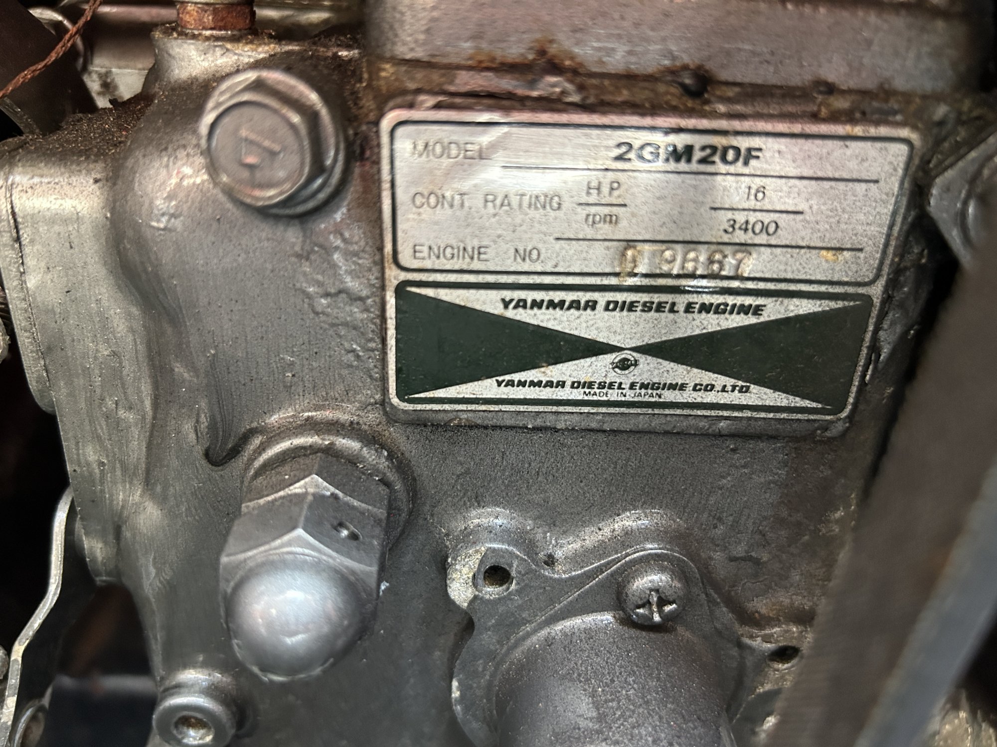

An engine should have a max RPM. My Yanmar 2GM20F is rated at 3600 rpms max and 3400 rpms continuous. So I like to run mine about 2800 rpms.
Greg
