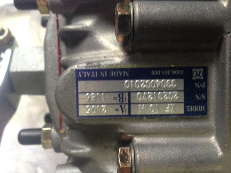

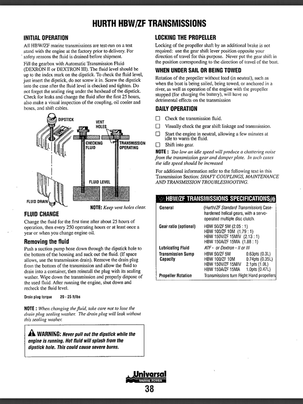

Universals have Hurth transmissions, which I posted the link to the danged ACTUAL placard that comes with the transmissions.
Yanmars have different transmissions and Yanmar's own technical bulletins now say ONLY neutral.
Your boat, your transmission. :)
Please stop mixing apples & oranges, it doesn't help the OP at all.

If it's a Hurth or ZF neutral or reverse is fine according to the manual. Sailing engaged in forward is not.

You mean like Carl Hurth..?? Carl Hurth sold the company to ZF and they still insist on neutral or reverse.
Neutral also creates less drag with a fixed prop and overcomes a potential safety issue if quick starting is necessary in an emergency. It also places less wear and tear on your starter motor for those times when you forget to take it out of reverse and start the motor..

Went sailing today. 1986 Universal 18 with Hurth Tranny. Pulled original manual and it said sail in Neutral only. So I did for 3 hours and tranny stayed cool.
