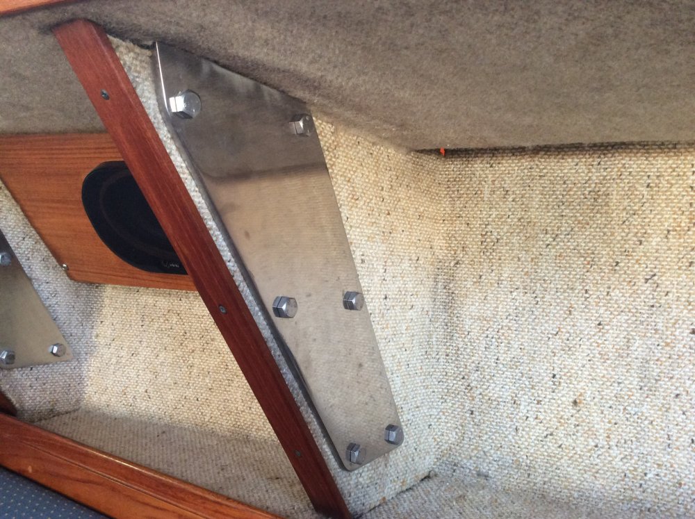

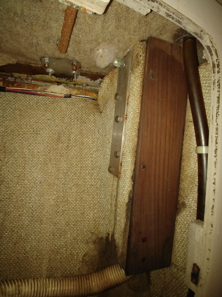

When you pull the old piece check to see if they used a thin piece of foam between the wood and the hull. You probably don't want the wood to fit real tight because it would cause a point load hard spot on the hull. The deck joint is not as critical since the deck is cored. Do a search on bulkhead installation and you will see what I'm talking about. Years ago one could purchase the foam already molded with a nice filet for the glass to follow in the corner.
May 8, 2018
98
Allied 42xl Galveston
Ill heed that. All I want to do is watch and learn the process really. That's why I cut the plywood for project, I know that's spot on and the flush fit will ease my mind.....
Apr 26, 2015
663
S2 26 Mid On Trailer
Stick with the plywood. Coat the edges before installing and keep the water out. Mine are 43 years old and still going strong.
May 8, 2018
98
Ya....and I keep spreading it on too. My family refers to the whole project as ...playing with blocks or on a more broader term....Dad's Sailboat Madness
Likes: kloudie1
7,748
Sometimes I wonder why we don't sister a sheet of marine ply on a iffy bulkhead for a tired boat and be done with it ... ala post #4. Taking those old bulkheads out could involve complications not anticipated.

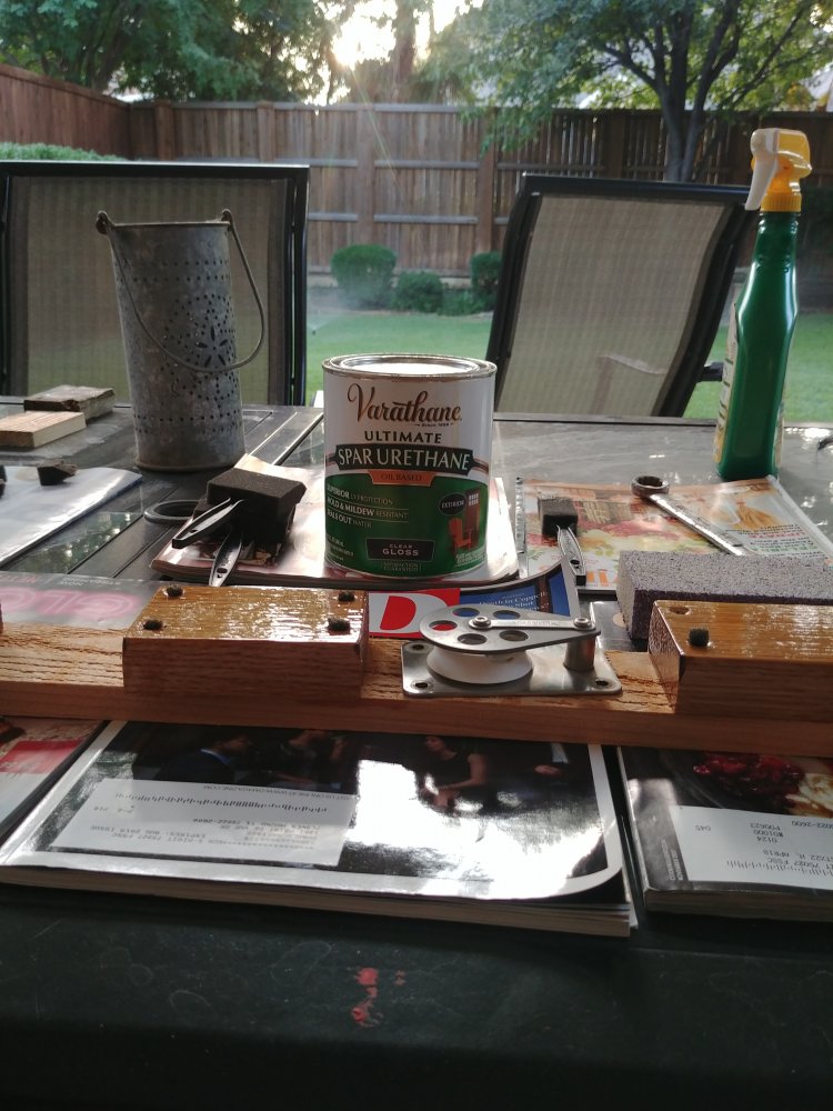

Unhinged, Good choice with White Oak for your pads. Here is an interesting link as to the differences between White and Red Oak.
May 8, 2018
98
The 36 is classy......same workmanship...its a straight forward deal on an s2 looks like. I found a hardwood place with teak from India and Africa. Made we want to learn cabinetry.....they planed out some 1 inch for me...20 bucks
