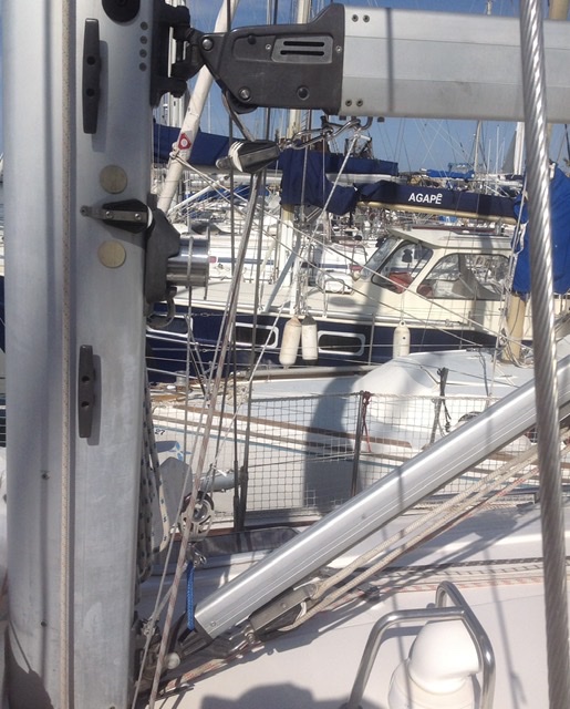

I have a solution to Selden In Mast furling line drive issues and furling problems.
The plastic line drive and continuous line is replaced with a SS drum and Dyneema core furling line.
The SS drum has been in use for 2 years on a full time cruising 46 foot catamaran and a 40 foot cruising monohull.
A knowledgeable owner or rigger will be able to install the SS drum and service the furling system.
The furling plastic line drive system, continuous loop furling line, and locking system is removed from the furling casting below the boom. The new SS drum is bolted on and you can service the furling system.
The install requires a cheek block installed inside the aft end of the boom to create the length of furling line needed to furl the sail.
The removal, install, and service can be done in about 4 to 6 hours.
This is not a Selden approved part.
If you are interested, let me know the boat type, year, and a photo from above the boom to the mast base.
