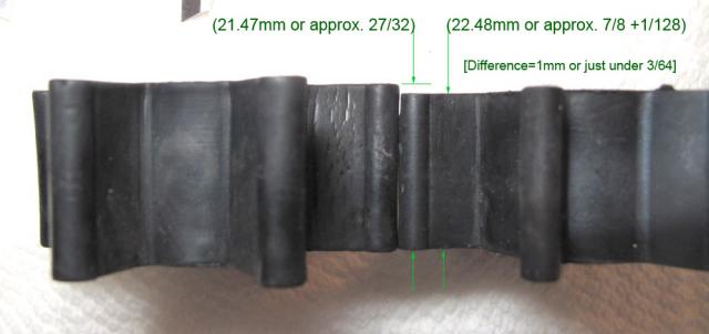

I'm not having a problem. Over on the Moyer site there has been a recent discussion about new impellers that aren't as wide as the old ones they're replacing. The result is water leaks internally between the face of the vanes and the cover plate. Without that seal the water doesn't pump or at a very reduced rate. One member measured the difference between new and old and there was a dramatic difference.
After much discussion a theory emerged that the internal pump cavity wears significantly over time and the impeller in place swells to match the cavity depth, accounting for the difference in width between new and old.

We're talking something different than vane breakage, familiar with that. I found a picture taken by the guy who did the measurements. He mislabeled the dimensions but the pic tells the story. The short one is new.
Also, we're dealing with relatively current pumps, either bronze or brass bodies (I'm not sure which, whatever has been commonly used over the past few decades).

The way this issue surfaced was a member bought a replacement impeller from Moyer and his engine temps rose significantly. He found the difference in height between the new and old impellers and started asking questions. Many of us measured our impellers and pump cavities and found measurements all over the place suggesting we weren't dealing with tight manufacturing tolerances or a perhaps a wear issue. We're divided into two camps right now, the internal wear camp and the poor dimensional control camp (for the new impellers). Oberborfer, the pump manufacturer, seems to be in the internal wear camp.
I'm struggling with the fact that, in my experience, this hasn't been a problem until recently. Why was there no issue for 4+ decades until now? My reason for inquiring on this forum was to hopefully pull in a much wider survey size rather than rely on only my personal experience. It will be interesting to see if ANYBODY has experienced this.
10,254
Even OEM is not a guarantee.. I remember a couple of folks on this site who had trouble with brand new OEM Yanmar impellers.. It was reported that the hub would get loose from the rubber very quickly (less than an hour of run time) and then it would pump no more. Lesson here is compare the new part to the old part before installation. The critical parameters on a new impeller are the vane length and the width. If the hub is larger with the same diameter vanes, it will pump less at same RPM. Looks like in the posted case here, the width is clearly the problem..

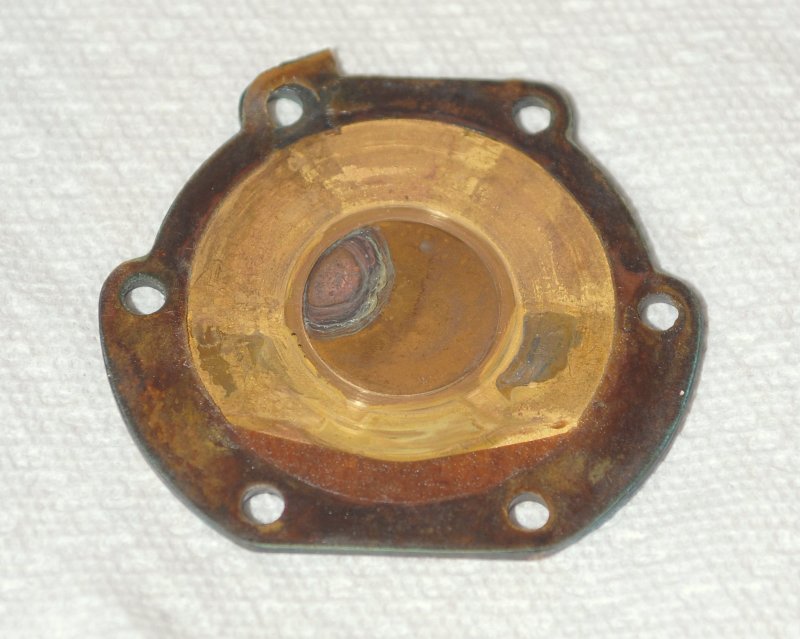

Our boat has over 3k engine hours and is on her second pump and almost ready for a third due to body wear. With a new pump she'll prime nearly instantaneously and with a worn pump it can take up to 20 seconds or more if she loses prime.
This is a worn cover plate note the defined "ridge" in the center around the hub:

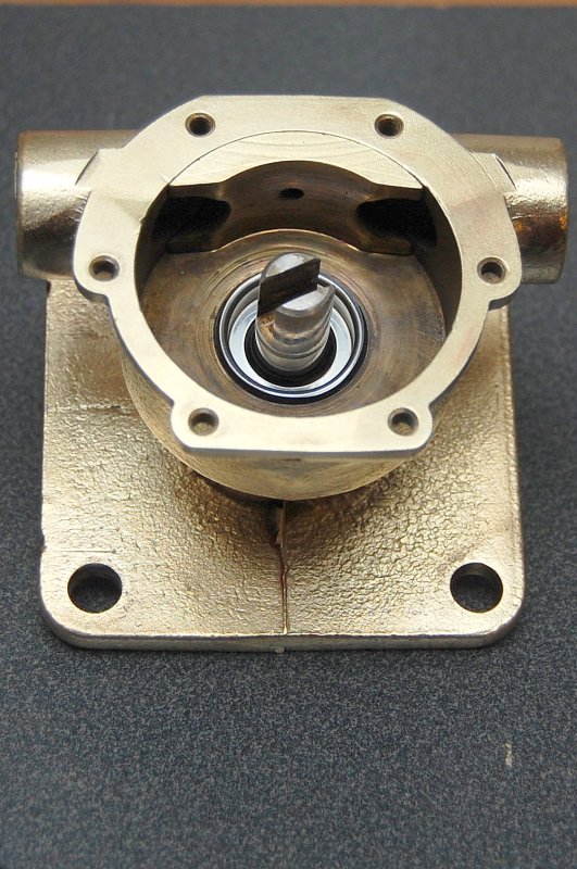

Below is a worn pump body. Note the scores close to the bearing. This is likely from a piece of grit that got sucked into the pump and jammed between the impeller and the pump body. The worst wear I see is always the thickness between the cover plate and the back of the pump body not so much in the diameter. I have yet to come across a pump so worn that a vane did not have a slight bend in it from contact with the pump wall or enough contact friction to become an issue.
When installing a new impeller seat it hard into the body and be sure that it sticks just a touch above the edges of the pump or exactly even so that the cover plate will compress it ever so slightly or that the impeller will have contact with it. If the impeller is not mating with both the rear of the pump body and the cover plate it will not perform the way it should.
