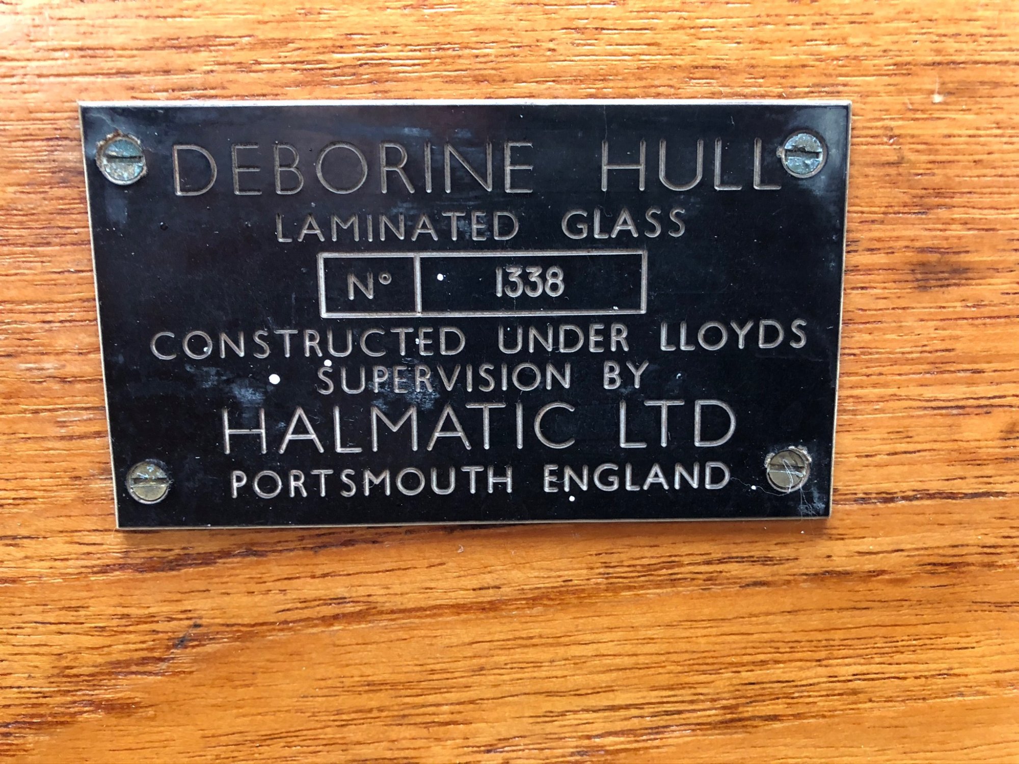

Hi I bought an Alden mistral a year ago not sure what number to call her? Any info on this name plate would be appreciated.

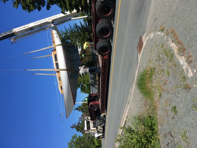

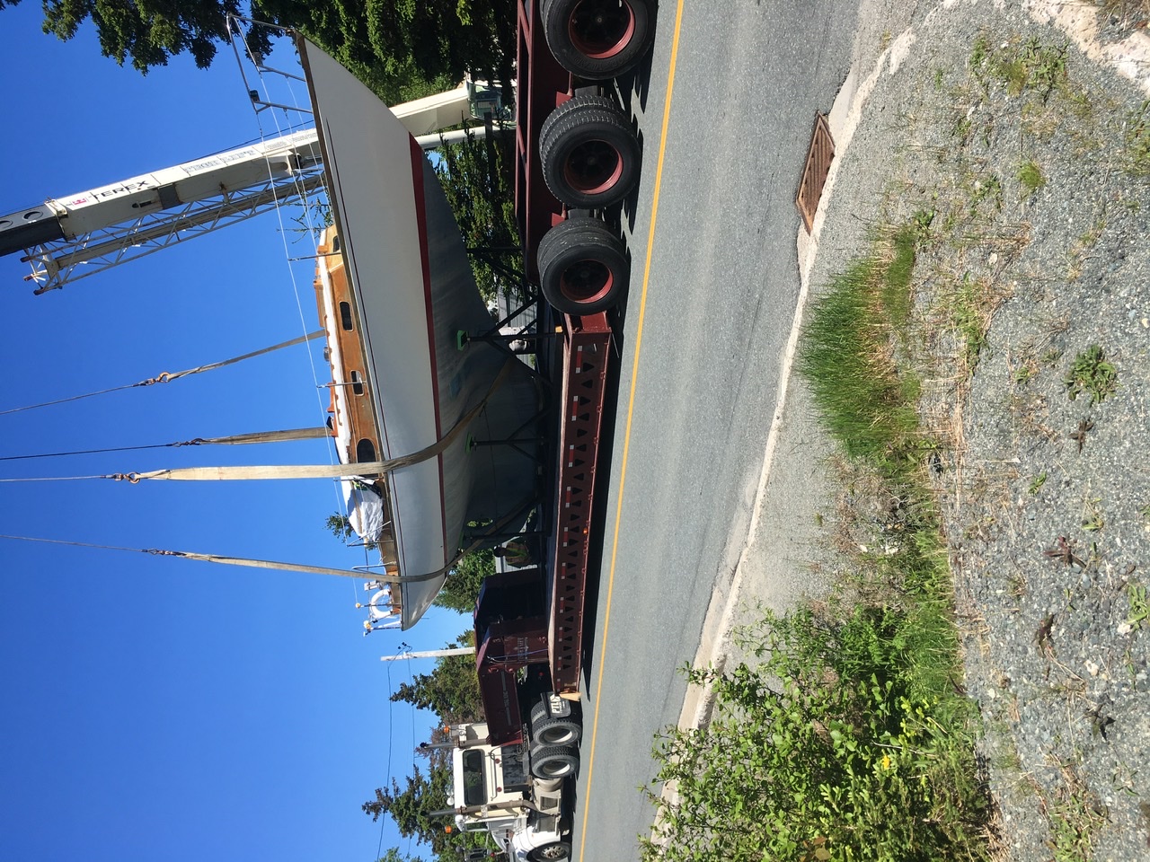

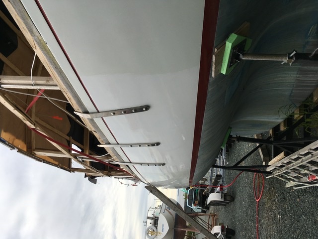

- ive just finished replacing the chain plates - cut the hull, dug the backing bars out, reglassed the chain plate knees from the outside then filled faired and reglassed hull, fair again, gelcoat 2 layers and then paint. Finally bolt on the new chain plates with buytl chaulk. Used 2 1/4 x ⅜ x 26 inch long 316 stainless. 4 x 1/2 carriage bolts

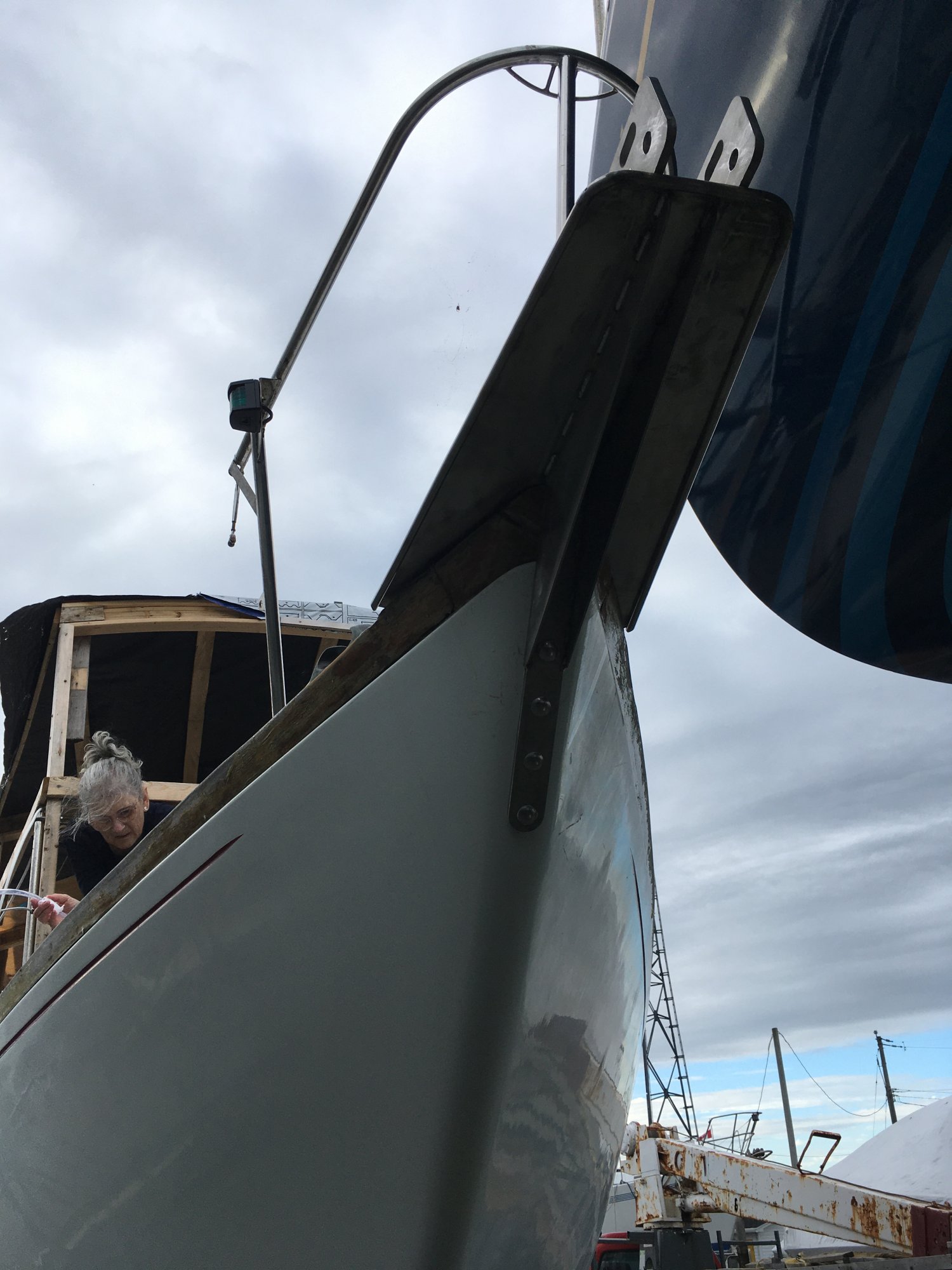

I replaced the bow fitting as well - the old one was hanging on by a thread. Again 4 x ½ inch Carriage bolts for the bow strap to replace the three 1/4 inch screws. The new bow fitting allows for the newer styles of anchor which tend have a fair bit of hook to them
