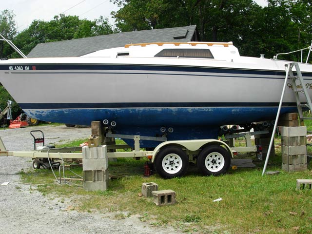

Frank I agree that you have to be very careful, but I also think it might be done safely. I cringe every time I see someone with cinder and even concrete blocks holding up boats, especially when they are orientate the wrong direction.
Do you have more pictures so we could get a better view of the trailer. Whole trailer, front, bunks, etc..
Until I see the pictures I don't want to say for sure what I would do, but treat it similar to how we lift our Macs off just use heavier materials and be very wise about it. It sounds like it doesn't have to come all the way off the trailer at one time.
If it doesn't then the first thing I would do would be to work around the trailer with blocks using your jacks on the trailer. Work it up in increments. Small ones like 2 X 4 blocks laid flat on top of larger ones. Don't end up with a pile of 2 X 4's. After you get the trailer 6 inches higher or so replace the 2 X 4's with thicker blocking. I would try and block the frame where the bunks/load is on the frame rails.
Once the trailer is about a foot higher then you could block the boat at ONE END ONLY. Then lower the trailer, rotate it down, at that end and work on the one set of bunks that is lower. While you are doing this the boat is still on the other bunk. This is if the bunks are far enough apart.
While you are doing this I would rent or buy regular boat stands to support the boat on the one end. If you bought enough of them you could support the whole boat, pull the wheels/tires off the trailer and drop it down on the ground to work on it. When working under vehicles I never count on one thing to protect me. I'll jack a vehicle and use jack stands, never the jack itself and then I'll put wheels, blocks, etc. under the vehicle just in case it was to come off the jack stands.
Just some ideas, but I really need to see more and better pictures. As everyone has said it is something that has to be done right, but I would tackle it. The trick I think is to lift the trailer and then support the boat with real boat stands. You will probably need them for the other boat and for the future, so why not spend the money on them now.

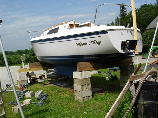

When I do the bottom on my O'Day 26, I support it on 6X6's, the top one carved out to the shape of the hull. I use two jacks, one at the forward end o the stub keel and one at the aft end. The boat is slowly raised one end at a time, adding blocking as I go. I use 4X4's as intermediate blocking. Once the new blocking is in place, the jack is relaxed and the weight of the boat is allowed to settle back into the cradle as the other end is lifted. A spotter watches the piers that are accepting the weight for signs of any "movement". The last time I did this, it took my son and I about an hour
to get the boat as high as we needed it.
The trailer and bunks are always under the boat as a safety net. the trailer only comes out from underneath when I need to take out the center board or re install.
My boat is a couple thousand pounds lighter than yours, so the long span to allow the trailer to roll forward would not be a good idea, but you could use this method to lift the boat enough to repair your bunks

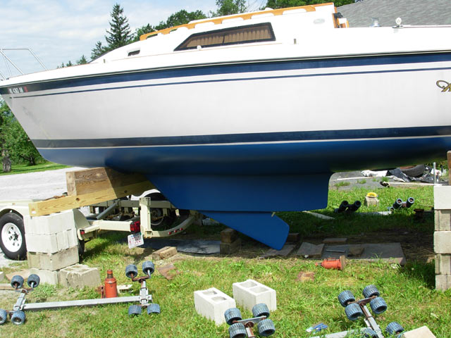

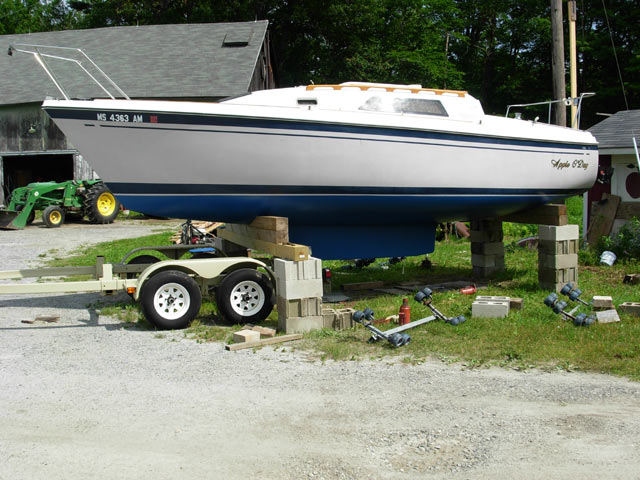

we were concerned too...
In putting the 26D up on blocks.. we were really concerned... Mostly, because of our inexperience and from seeing people that did it WRONG - and had stories of why it was wrong...
We used Concrete blocks as the support basis - with a floor jack to lift...
We used jack stands on three points - as "backups" while lifting.. There is an OLD RIGGERS RULE.. "Never lift more than you absolutely have to..."... and advice was to assume that it is going to fall... now how does your backup work....
on the rear, we used the 2x2 stack - as appleman shows.... lifted a 4x4 worth on one side in the rear with a floor jack, moved the backup jack stand yoke a notch or two (the backup) - and put 4x4 block under a long cross member.. we used two 8' 4x4s on the cross stacked concrete blocks... When we did one point, then we went to the next point.. Left rear side, then right rear side, then front.
Yes this was slow.. but every lift point was a minimal lift - and there was a jack stand there to catch it if the load shifted...
The scariest stories were about shifting loads... One person had a single block wide of concrete blocks stacked.. for a block or two - no problem. But as the stack go higher.. the load shifted and he was very fortunate not to drop the boat... For us, the cross stacked 2x2 array of concrete blocks worked...
the 26D is light - we used 2 4x4" x 8' timbers in the back for support.. and then when it was up high enough, chocked the sides - and screwed the blocks down.. that worked well with 2x3 blocks.. we did this because we had sails up from time to time - mast up and working on sails....
Upon reflection, I would not put the sails up again - when it was up on blocks....
I have seen multiple postings from people with a lot of experience in doing a bottom job - and some clever things have been done...
Some people started with the idea - and did wooden beams with slings... I don't think I would do that - our boat was just up too long... and we are always cautious about wind...
Appleman's pictures show the idea in good detail.. I was just more comfortable with the jack stand backup while lifting....... that may have just been overkill...
