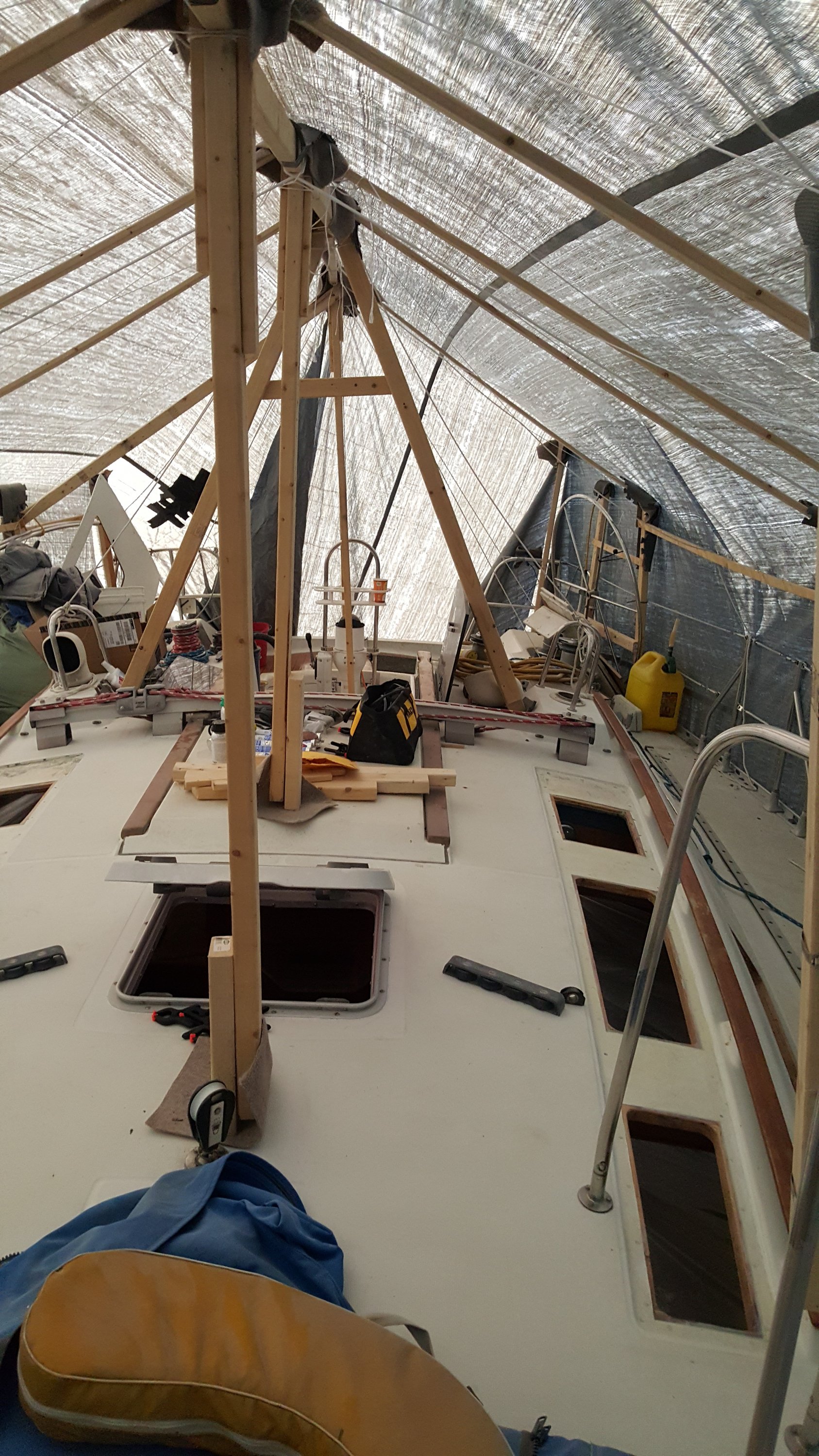

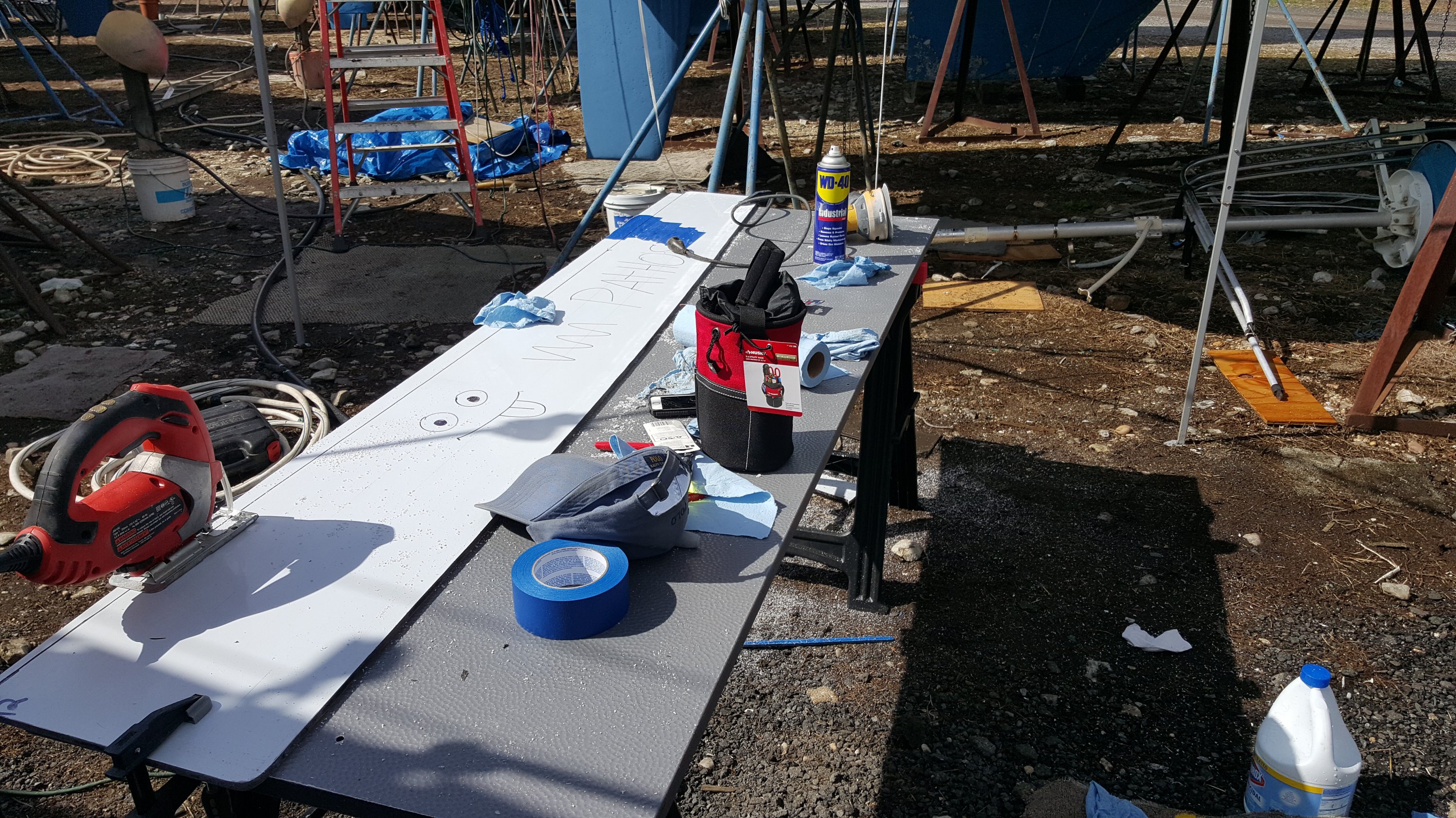

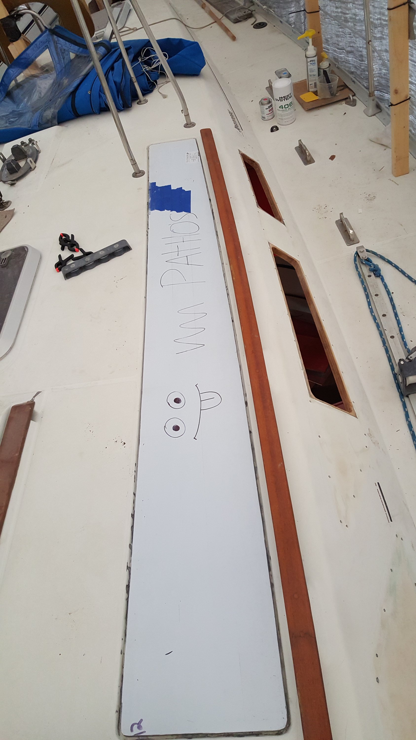

So here is my current situation, I've turned into a sheet of plexiglass. :laugh: lol but really..
I've painstakingly gone through the effort of cutting all 6 side and top lights, beviled thier edges and prepend the hull where they are to attach. Added some pictures for you'll to enjoy..
Now I'm making templates with shims hot glued in place. I've read this will help me to set the glass with 3M tape right the first time. This tape is tough, I see why you only get one chance. Once the glass is set in will tape off and sika flex all the joints.
But, first I'm dry fitting the lights with the shims inplace and marking out where the openings are from down below. This leads me to my questions of the day....
I'd like to paint the inside of the glass black, everywhere except the openings of course. Soooooo..
1) What type of paint should I utilize on plexiglas?
2) Can the black sika primer be applied on top of this paint, or should I leave a 1" border around the outside edges for the sika primer?
3) What would be the best bonding surface for the 3M (raw glass, painted or sika primed) ?
Thanks in advance mates!
