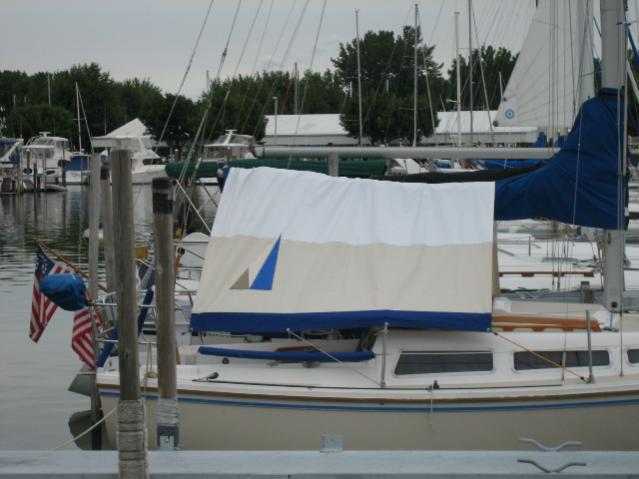

For our last boat my wife made this with a singer sewing machine and fabric from Joann's fabric

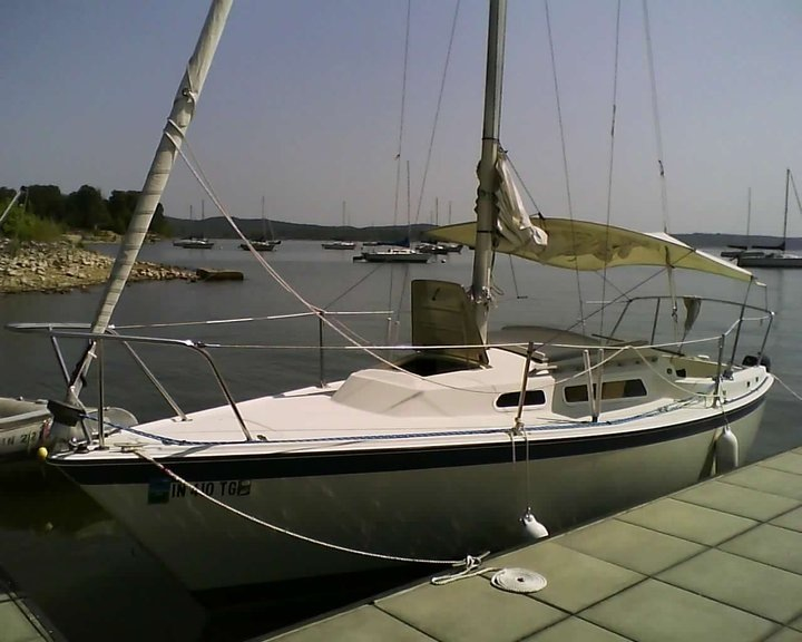

I don't like the confined feeling of my bimini so I use a boom shade that is made from 1//2" pvc pipe and what looks like a sheet. It goes up easily and I use only while moored or motoring. It is amazingly stable in strong windy conditions.
I did not make this one but will copy it with hems on the end that I can run the PVC though rather than using grommets. It will look cleaner and more finished.
