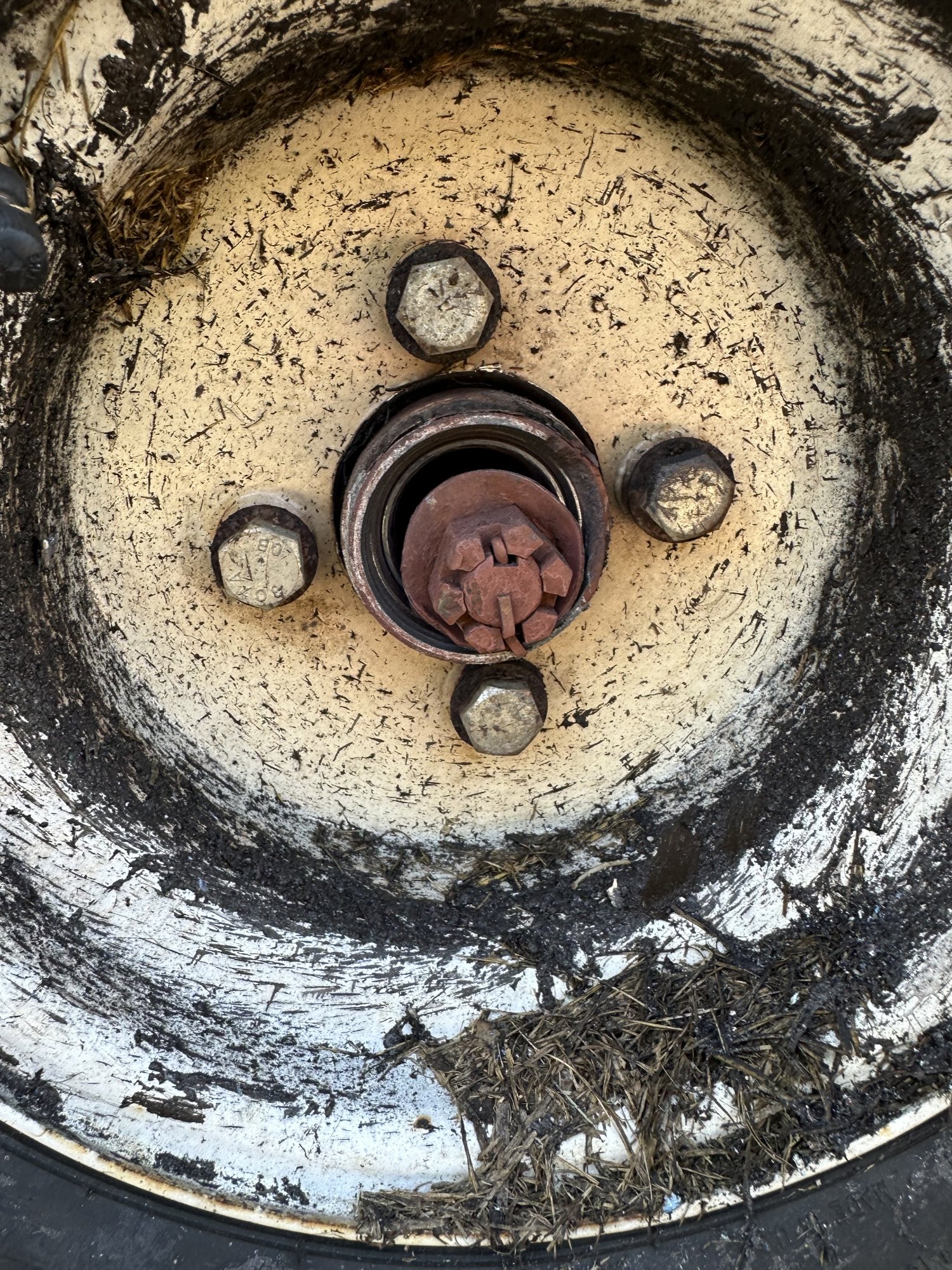

Finally launched my Catalina 22 today (had to re-core the cabin top). Unfortunately, I destroyed a wheel bearing on the way to the boat launch. The launch is only a 15 minute drive from the house. Didn't notice anything weird (noise, etc) until we were pretty much at the launch. Decided to get the boat off of the trailer (we keep it on a mooring) since we had people with us to help, etc.

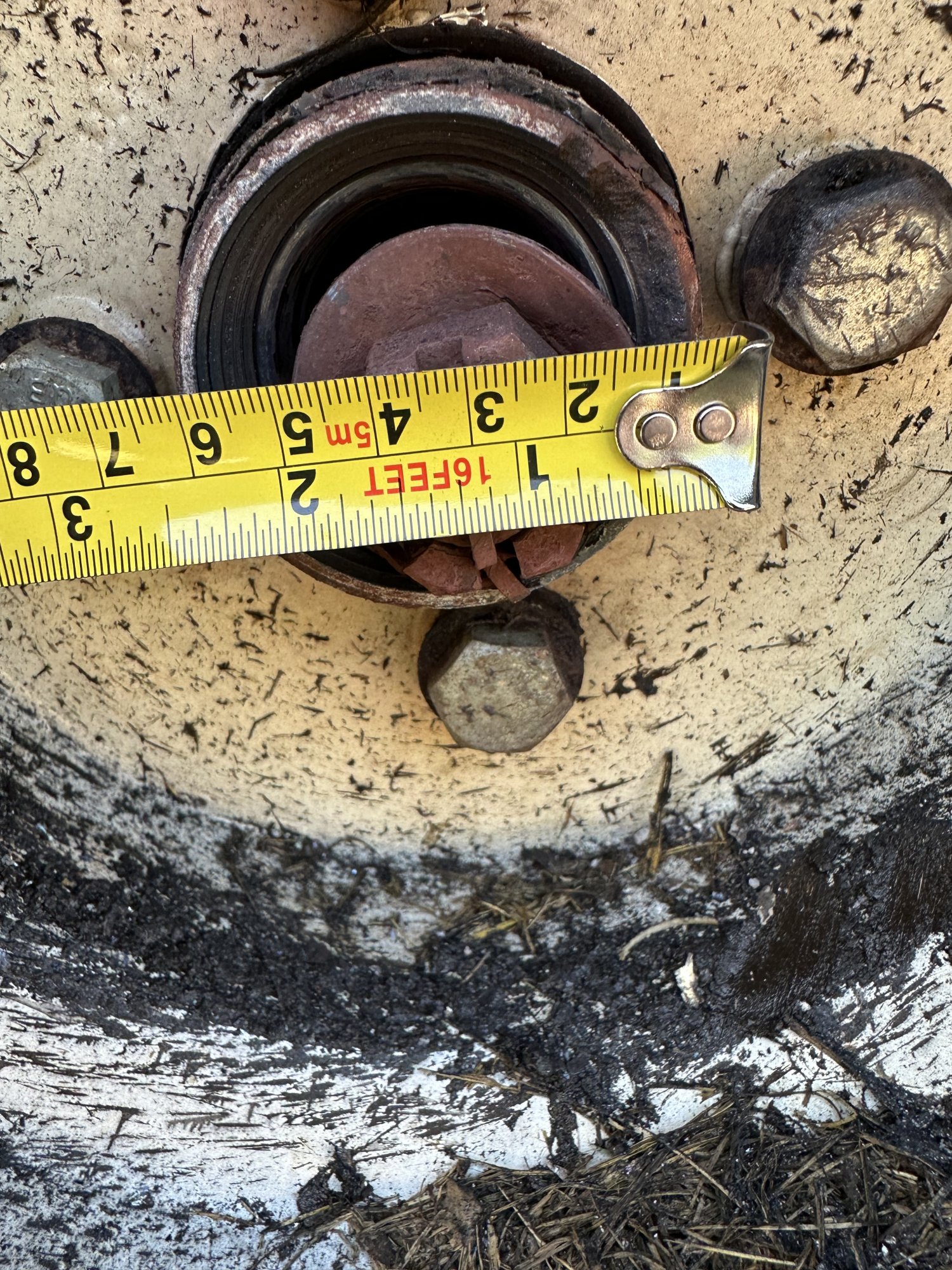

Now I need to figure out what to do about the trailer. It's still at the launch (not in the way, but it can't stay there). I can't find any markings on it for a manufacturer, etc. I'm sure it used to have some, but neither I nor the PO could find any when I bought the boat. Take the tire off, pull what remains of the bearings out and take them to an auto parts store? No trailer stores around, but a kind person at the boat launch mentioned that the local auto parts store had a lot of trailer bearings in-stock.

Think that you are on right track. Remove tire & hub. Cleanup hub & remove bearings. Take old bearings, seal, & hub to auto parts store to match bearings & seal. After cleaning bearings & seals, you may be able to see bearing manufacturer & size / part number inscribed on bearing race. Repack bearing with grease & reinstall. Two to three hour job including trip to auto store! When you verify that your repair is successful & get the trailer back home, best to replace bearings on remaining wheel before trailering boat again. I have always used “bearing buddies” on my trailers. Many claim that they really don’t help; however, at least it permits you to periodically add fresh grease into the hub. In all the years I have launched in salt water, I have never had a bearing fail, so I feel that they help.

You will probably need the 1.98 bearings with matching racers. Some refer to the bearings as 2 inch.

You should be able to read the numbers on the side of the bearing surface (etched on the side of the inner ring of each bearing, not the cage that encircles it). Once you identify the bearing, it will have a matching race (the part that presses into the hub). Make sure you look at the seals as well. The numbers are usually imprinted on the exterior surface of the rubber seal. If you cant find it or it was damaged, you'll have to use a micrometer and measure the ID (axle surface where the seal rides) and OD (inside the hub where the seal seats). NAPA or any good automotive store will help you find what you need. If you can read the numbers, type them into google and you'll find the kit you need. As mentioned previously, make sure to use waterproof grease and do both sides :)

And judging by your photo, you're likely going to have to clean up the axle surfaces with some emery cloth due to the rust (no bearing cap on the hub).

There was a bearing cap on there when we left the house (5 miles pre-incident). It actually caused a lot of damage to the spindle as well. Trailer is currently at a local mechanic.
