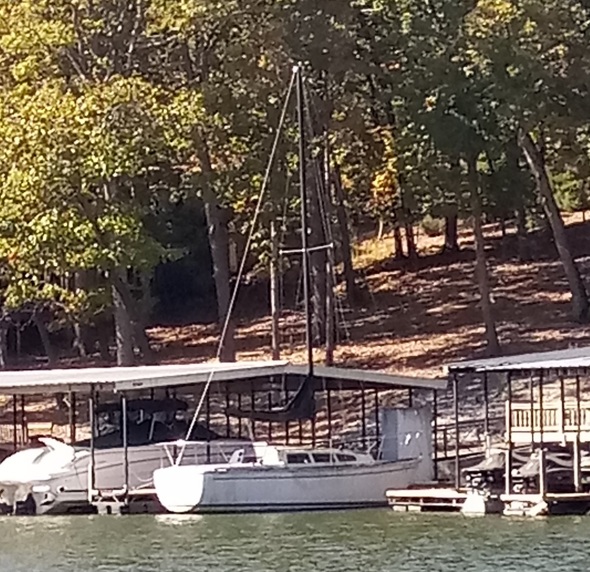

Fair question.
  1. The overall appearance of the boat suggests years of neglect.
  2. Take a look a the waterline. The staining suggests the boat has been partially submerged.
  3. The companion way boards. These are obviously in a poor state of repair and open.
  4. The interior is likely covered by mold and mildew because of the high moisture content due to the partial sinking.
  5. Any and all soft goods, like cushions, vinyl coverings, are ruined due to the moisture and mildew and mold.
  6. Bulkheads are likely rotted because of the partial flooding.
  7. Any interior trim is likely damaged from mildew and mold.
  8. The starboard side hull/deck joint has been damaged, notice the aluminum trim that is bent and missing near the chain plate.
  9. On a boat this old and neglected, it almost goes without saying all the running rigging needs to be replaced.
  10. Part of the starboard toe rail is missing. The rest looks to be in very rough shape.
  11. The standing rigging will probably need replacing.
  12. Even on older boats with solid GRP hulls the decks were cored with balsa or plywood because of the large flat expanses. I would be extremely surprised to find these decks to be dry. Thus large areas of the deck will need to be rebuilt.
In the end, after properly repairing a boat like this, some $5K to $10K and untold hours will be spent bringing a boat of unknown provenance back to life.
